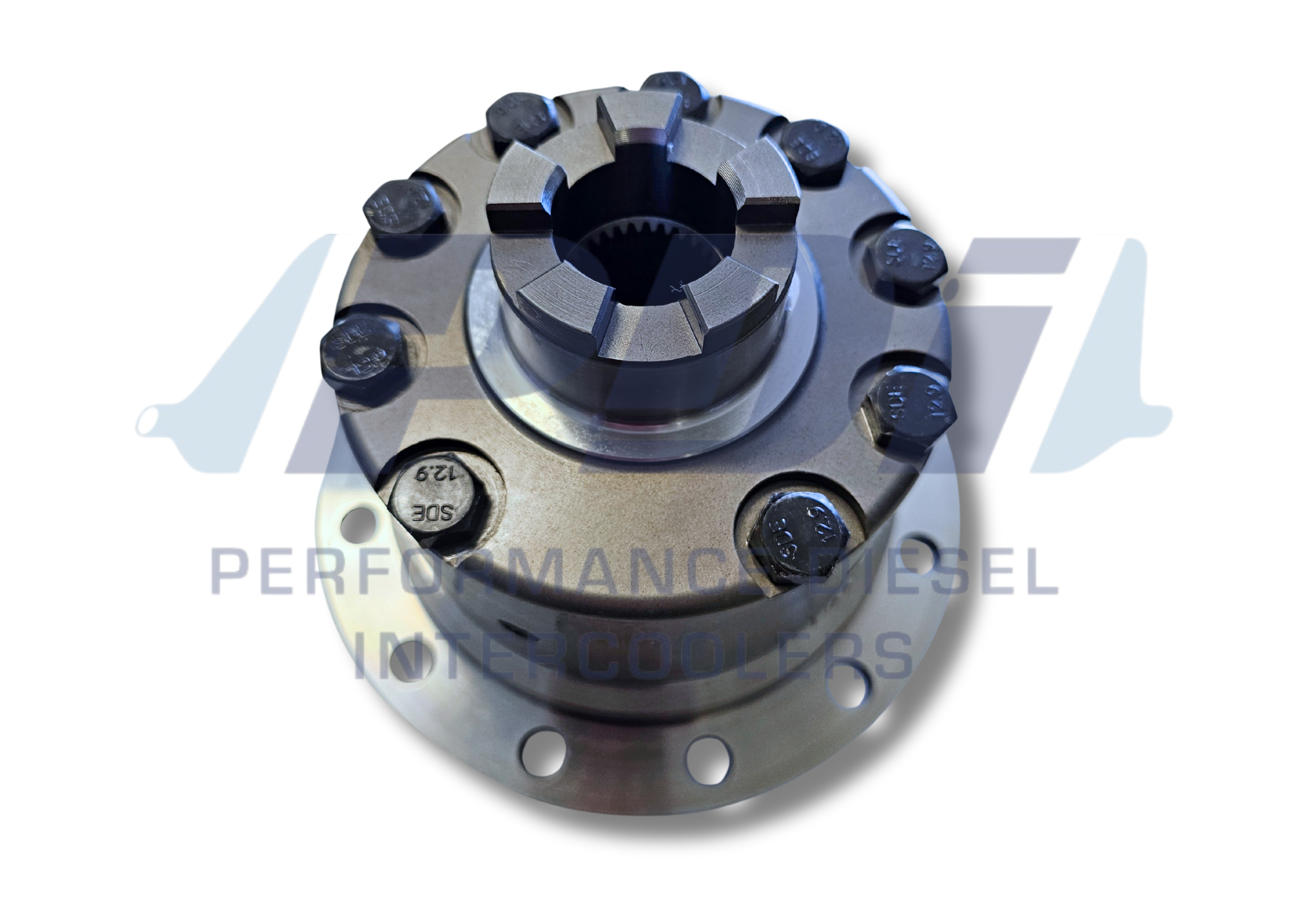

Haven't seen this discussed.... I really enjoy the Torsen Center diff in the 200 (Type T-3). Doesn't say what type used in this unit though. Would like to have one in the 100. $700 AUD minus GST is approximately $450USD right now.
Wow, good find. Sounds like an excellent idea, and at that price... If I need to open the transfer ever, I imagine that this one goes in. I wonder if there are any other changes required.
A limited slip diff seems like it would work great in addition to A-TRAC. It could be useful on muddy, slippery situations where A-TRAC doesn't shine. Especially for that price.
^^^ That's pretty cool First I've heard of such.. Locking Torsen!
