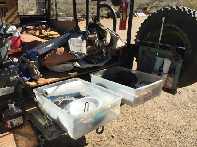

While pondering this, I happened to lay a piece of wood across the top of the wheelwells, as my friend Ian Rogers had done a couple of years earlier for one of our club’s trips across the Dusy trail . Hmmm. The space to the bed of the truck would now easily accommodate a couple of my existing kitchen boxes . Good. The extra space and permanence of the section forward of the rear kitchen boxes would easily hold my selection of trail spares without further concern over the weight of a removable load. Even better. The forward section of the deck would now transition to the dashboard with relative ease, creating an enormous storage cavity in the passenger footwell. Excellent. Version 2.0 was born!

This arrangement resulted in three rather substantial compartments. The first, in the footwell forward of the fuel tank, provides almost three cubic feet of storage space with the lowest center of gravity in the truck. For hardcore wheeling trips, this makes an excellent location for a spare third member, though accessibility is still an issue in version 2.0. For all other occasions, this seems to be an excellent place to put various scraps of hardwood for the campfire, ensuring that no one accuses the FJ40 owner in the group of not doing their share for the community.
The cavern between the fuel tank and the driver’s seat rivals that of even the largest commercially available center consoles, providing easy storage and access for tool bags, shop rags, hand cleaner, tissue paper and just about anything else you just HAVE to have handy.
The space above and immediately behind the fuel tank, also easily accessible through the open passenger door, provides a good space for a multitude of camping items that are shallow in height and ’secondary’ in necessity. Though my fuel tank does not leak, I would still be reluctant to store food or clothing in that compartment, but I have no issue with putting the camp stove, or a spare pair of shoes there.
My remaining gear ties off comfortably to either side of the roll cage, allowing sufficient room to sleep alongside the ice chest without having to move it from it’s dedicated spot directly behind the driver’s seat. For the moment, I have to move the guitar from it’s spot on the passenger’s wheelwell to sleep, but I am currently considering a way to hang it from the passenger’s side of the roll cage, since retaining headroom over a non-existent passenger seat is a moot point.
