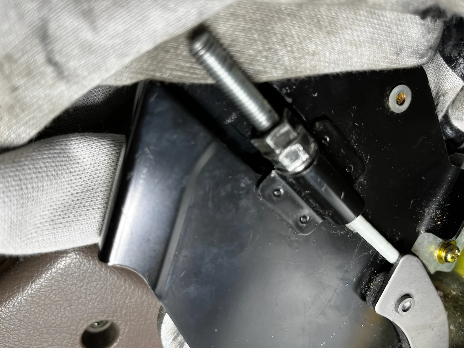

Thanks for the detailed adjusting instructions. Unfortunately I haven't had time to try anything yet. First thing the PO adjusted the cable at the handle and it looks like its maxed out with the nut as far to the bottom as possible with all of the threads showing on top. I did not touch it, where should this adjustment be before I start adjusting the bell cranks and shoes? My bell cranks were on there way to be totally fused together but I got everything freed and generously packed the crank assembly and the boot with white grease. The shoes still have a lot of meat on them.
does not matter, the cable is removed from the bell cranks during other adjustments, you then adjust it last when you hook the cable back up.

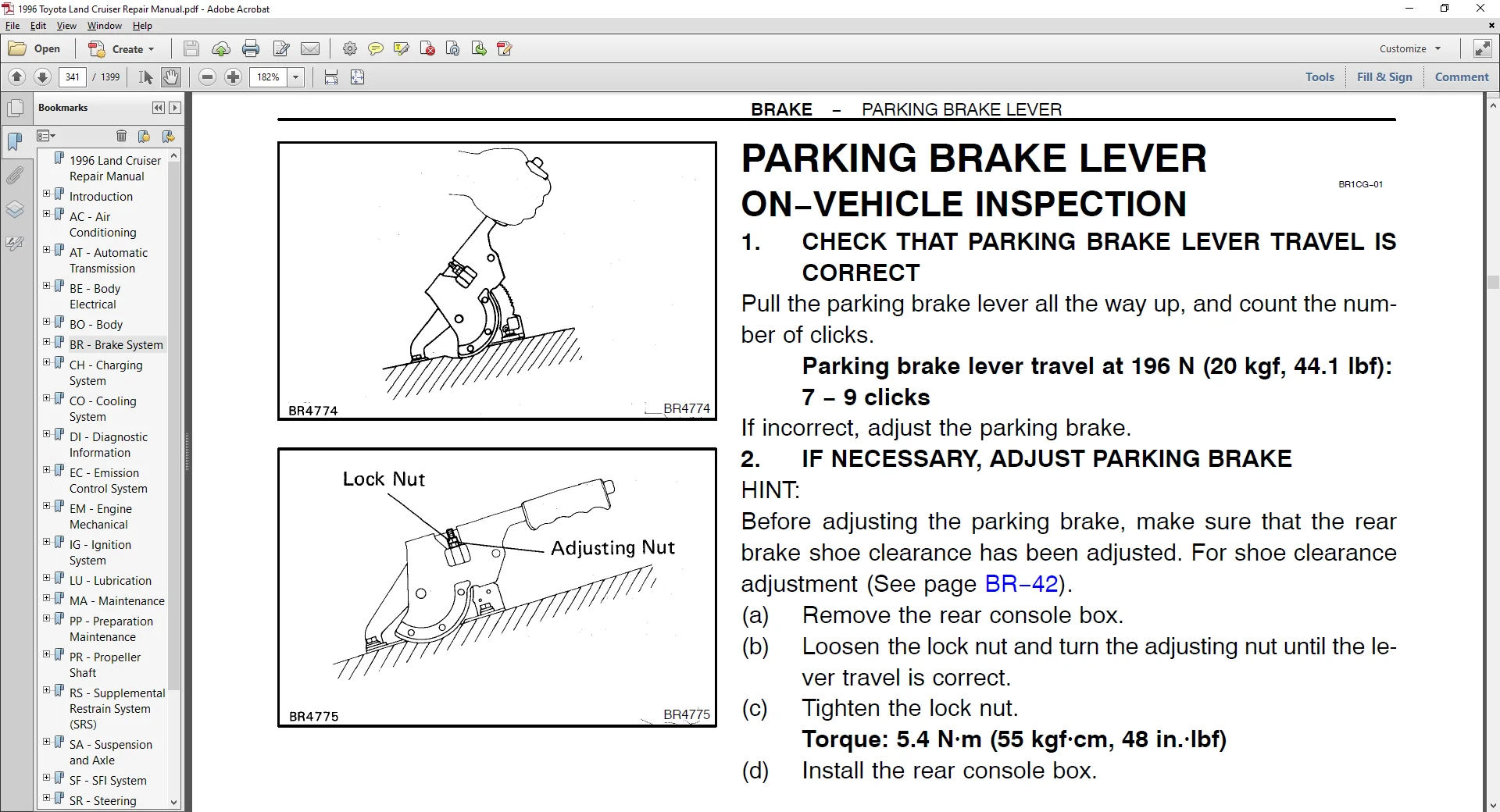

I fixed the problem with my e-brake and now at last it holds the truck with 7-9 clicks like the FSM says. I followed RavinTai's instructions with the pads just starting to rub adjusted it over and over till it was perfect. However when I took the slack out of the cable at the hand lever the adjusting nut was bottomed out and it would barely hold even if it was pulled to a vertical position. My assumption is that the cable is stretched so I used a 1/4 nut that slipped over the the threads on the end of the cable then tightened the adjustment nuts all the way to the bottom, now its perfect. Is it possible with prolonged use the cable can stretch? My wifes RAV-4 has a manual trany so its used every day the car is 11 years old and the brake still holds fine, so I can't see how it would be possible to stretch it.

I’m wasting a lot of time on this with my shop guy. I got all new parking brake bits yet my lever action is all the way 13-14 clicks to the top and it seems to barely hold. My star adjustment is maybe 3-4 notches from no rotor movement. If I go FSM 8, while the hold and lever action is nice, after driving at hwy speed warming it up, I get a horrible shaking where I have to slow down and pull over until the rotor cools.

Sounds to me like you need to do the interior adjustment as well. The cable may have stretched.
OK, I THINK that there's a failure on adjustment order.
You have new cables, new parking brake shoes.
You need to:
1) Back off the cable setting inside the cab as far as it can go.
2) Go back to the wheels and adjust the spinner there to adjust the shoes out. Need to follow the FSM here to get the bellcrank adjusted properly.
3) Readjust the cable on the interior to fine-tune it.

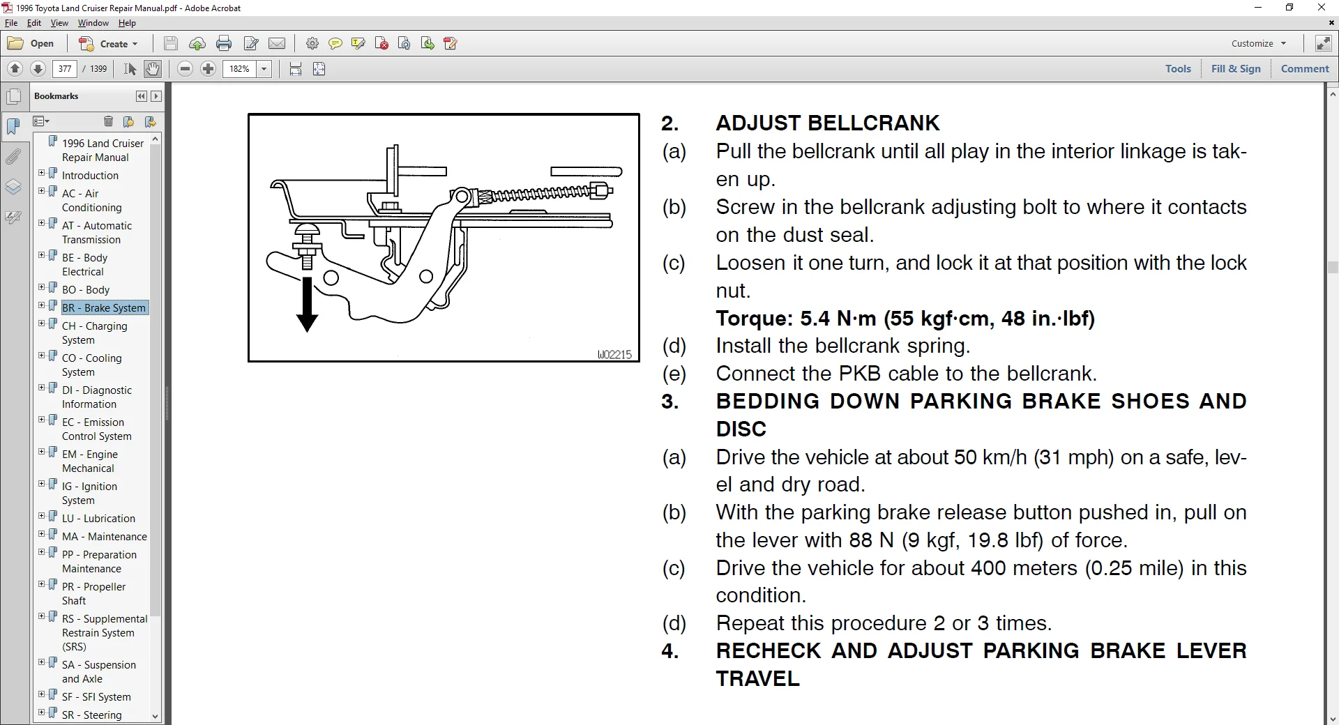

Thread resurrection - how much drag should the parking brake at rest/before engaging the brake lever? If I tighten the star adjuster tight to grab the brake and back off 8 clicks per FSM, I still hear a little drag when turning the wheels by hand - it isn't continous but drags a little in part of the rotation. Should I back the star adjuster to the point of no drag at all?
I think a tiny bit of contact that you're describing is what you want.
