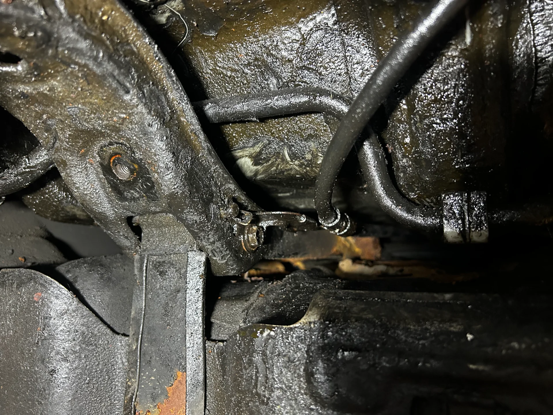

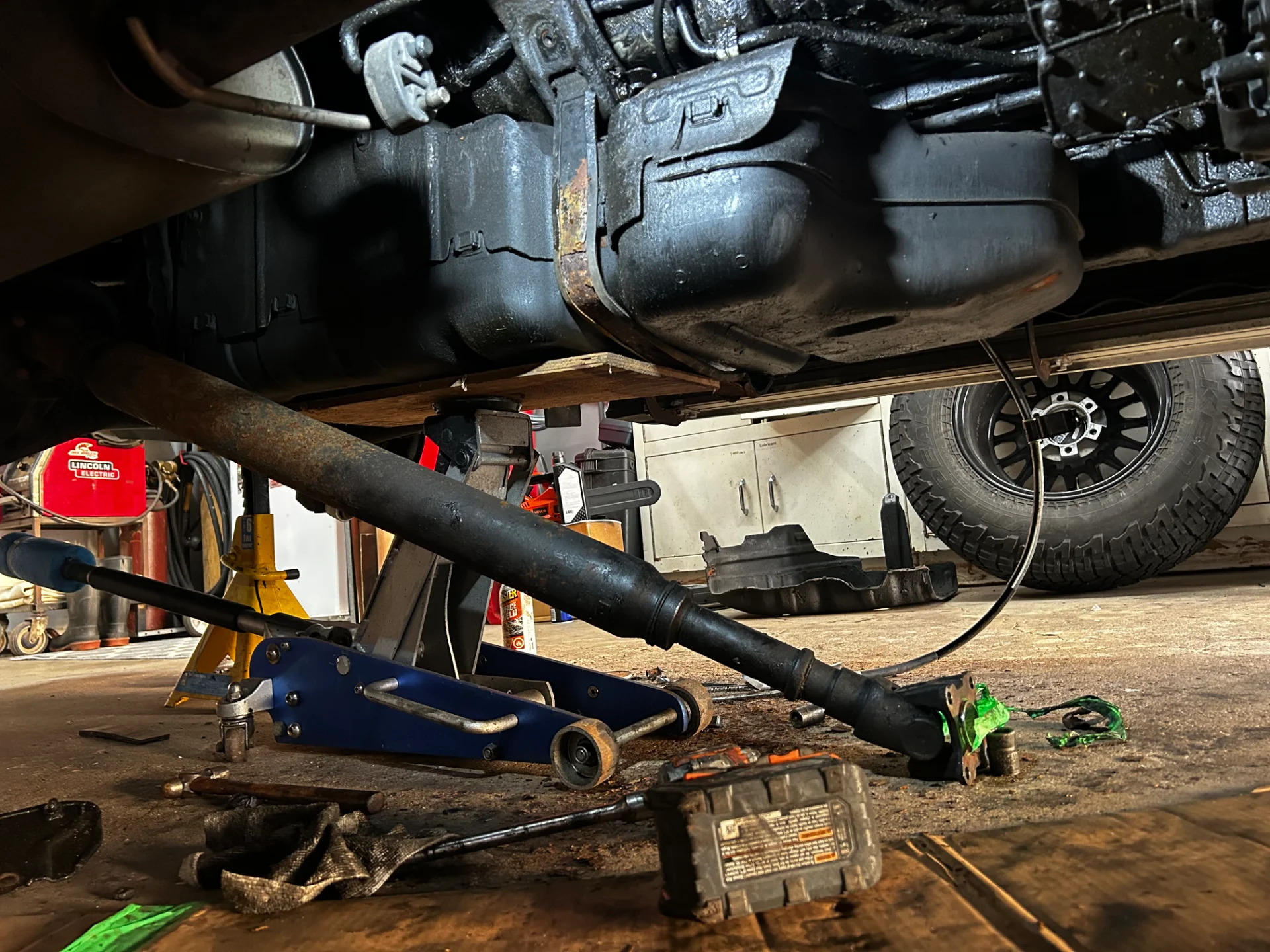

fjbj40 10 Year 15 Year 20 Year Joined Jun 26, 2004 Threads 211 Messages 3,055 Location east coast Canada Oct 8, 2026 #1 Do yourself a fav and lower tank a few inches, clamp above tank needs removal, yea you can struggle to do it without lowering but it’s easier to disconnect driveshaft and lower tank!
