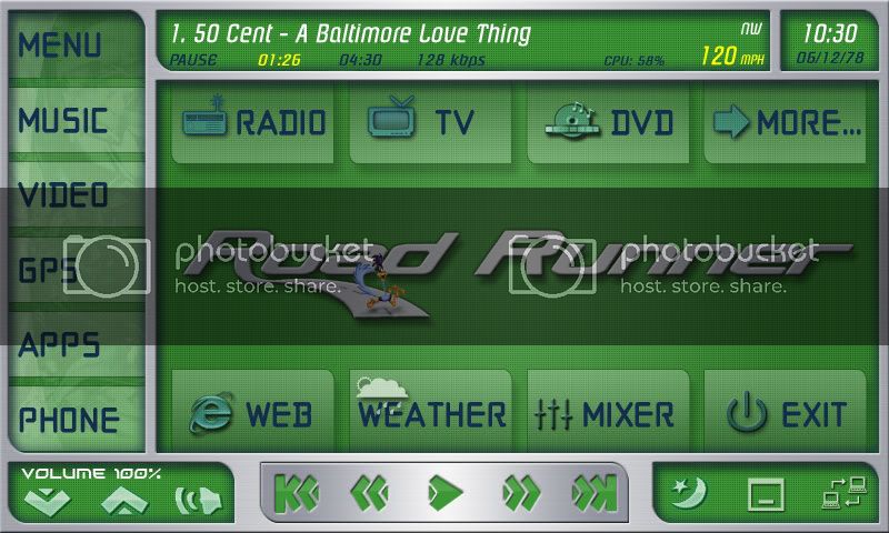

Here is someone's screenshot to give you an idea of what RoadRunner looks like, and how it functions.

RoadRunner is a front end shell that works in Windows 2000 or XP, but not Win 98 or Millenium. You can set it up to boot up right away with Windows when you turn the system on.
RoadRunner is free, and customizable! If you have a slightly slower system, there is a downloadable version of Windows XP that someone has stripped down called TinyXP revision 5, which only takes 8 minutes to fully install. It functions like Windows normally, but has a lot of the useless background resources removed. It was designed for gaming to make a system speedy. It works beautifully for RoadRunner and various programs, and still has all the drivers needed.

This is the "Crystalblue" skin, and the neat thing about this one is that the center logo can be Toyota, Land Rover (as seen), VW, etc.
If you click on the picture, it will take you to more screen shots to get a better idea of all the features.
