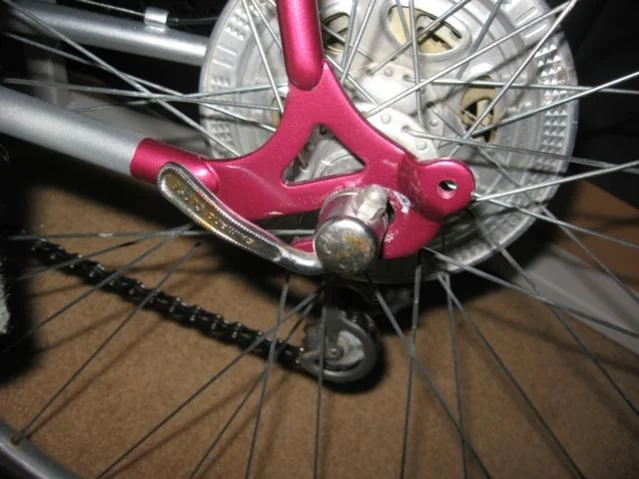

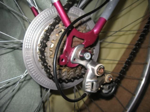

Here's what it looks like. You can see that the derailleur has no way to attach permanently. It does fall loose if you loosen the wheel. It obviously has a hole for some type of attachment screw. You can also see that it cannot go all the way back of the dropout unless it's rotated so that the hole on the derailleur where the screw/bolt would go is either up or down to offset such that it doesn't hit the pressed area. Both bikes are different brands, but same vintage and have very similar drop outs. You can see a pic of the other side that matches. It also shows where the hub sits in the dropout for the correct wheel alignment because of the spacing.
As 2mbb pictured, you actually are missing a screw (with a tab) on your current derailleur. The tab will slide into the end of the dropout. That way the screw with the tab and the axle provide two points to pin down the derailleur hanger in place (prevent it from spinning). The same idea with the adapter.
