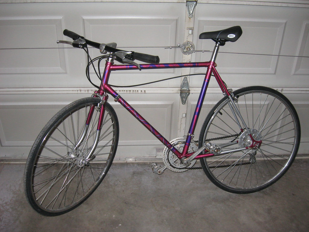

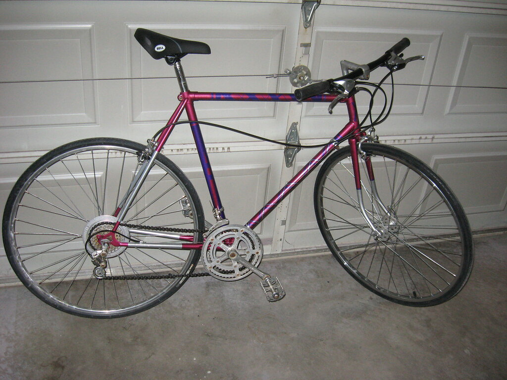

Got one assembled today. I decided to go flatbar. This is the wifes. I'm very pleased with the way they turned out. I was concerned about the mtb style shifters working with the roadbike derailleurs, but they shift normally, at least in my garage test ride.. The brakes are an adjustable pull length and I put them on the setting for cantilever brakes and they seem fine. It's been snowing today so no real good shakedown run yet. I put a cheap walmart saddle on, not sure what it'll end up with. I'll let her pick one out I guess. I don't expect it to last long, although it's really not too bad comfort wise.
Also you can see one brake cable hanging. I couldn't find the little clamps for it, but they are on there now. I think they are the only dura-ace parts on the bike...
Edit: Anyone know what the name for the little clamp on bracket on the down tube is? It's the one just down from the head tube that the shift cable housings stop at. One bike had stem shifters and had the bracket there, the other had down tube shifters, so no bracket. I need to buy one, but I don't know what they are called.

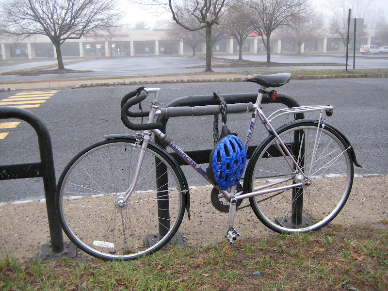

Really nice paint job. I've been thinking about painting a steel bianchi I have, but my options are pretty much limited to spray cans (no compressor big enough). I'm thinking about using hammertone finishes to hide imperfections in the paint job.
newer road bikes generally have "shifter bosses" brazed onto the down tube. Then you can purchase cable stops that fit over the bosses for the STI shifters, etc. These cable stops have integrated adjusting barrels.
If you just need cable stops, that's what they are called "cable stops". Some places you might be able to find this type of part are below. These stops generally do not have the adjusting barrels. However, you can also get in-line adjusters for cables.
I think they are called "clamp-on downtube cable stops". You will need to make sure it is a "clamp-on" type as the cable stops nowadays are very different (IE the frames mostly have brazed-ons.)

Thanks! that's exactly what I need. I wish I would have known so I could have brazed a couple on. I didn't really know how the shift cables worked.
I'm going to see if the local bike coop has a used one.
The rear derailleurs seem to work, but the springs aren't great. Especially when the smallest gears are used the chain has some slack. Is it OK to use something like this? Either with or without a new cassette?

The old derailleurs have a lot room to play around (as they only had to work for 6/7 speed). Before spending on new gears, you may try to pull the cable a little tighter. ( You can always use the stopper to control on both ends), unless of course you have your mind set of the new gears.
if your chain is slack on the smallest gears it could be that it is too long, or the derailleur does not have the capacity for your range of gears (now-a-days due to wide gear ranges, they make long, mid, and short length rear derailleurs). To set the chain length, I know of two methods. One is to put the chain on the big chain ring and small cassette gear. The correct chain length will position the derailleur to point straight down. The other way is to have a chain just long enough to fit around the large chain ring and the large cassette gear.
By the way, technically you should not use the "big/big" or "small/small" gear combination, especially with a triple chain ring. Not only does it put the rear derailleur at it's extreme it also results in the largest chain angle which put's lateral stress on your chain.
It just seems like the derailleur springs are pretty weak. I stripped it down and it's clean. It just seemed like it might be easier to throw a whole new one in there than replace springs. I can pull a few links out of the chain and see how it is. I figured a lower end replacement rear derailleur would be reasonably cheap and more reliable than the one that's on there. The one advantage to the current ones is that they are limited in movement so they won't push the chain off. The shifters are 3 and 7 speeds, so another derailleur with more range might be an issue.

Unlike the high end Campy, the Shimano and Suntour parts are not very easy to service. Are you sure that you did not lose an extra "turn" when you put spring together?
As of the extra low gear, keep in mind the bigger the gear, the hard to shift. Unless you live in a very hilly place, you might not need it.
By the way, the derailleur that you pictured will not work for you as you don't have a rear derailleur hanger. You will need the claw type of hanger for your old bike (the old style might not be easy find these days. I think I might have one in my part bin, at bottom of all my auto part bins now. I will take a picture for you if I can find it.)
