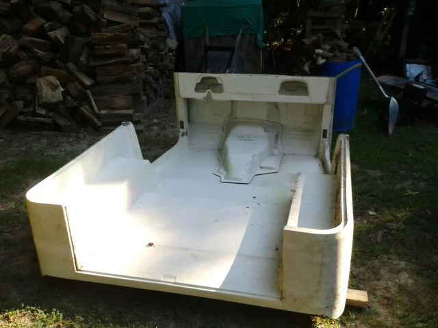

I just picked up a older but never installed Gozzard Fiberglass tub. It hasn't even been cut yet. The P.O. was going to use it to replace the body on his Red 40. He had the enire underside of the tub coated with what he thinks was Rhino Liner brand in bright red. I'm planning on using this to replace the body on my crashed light blue 40. Has anyone ever painted over Rhino Liner? Whats the best paint to use? Thanks, Jeff
They make paint additives for painting over plastic that make the paint more flexible. A "standard" paint is going to be brittle and flake off with the "rubbery" bedliner underneath. I'd be sort of tempted to put another coat of bedliner over it.
