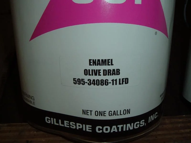

Rattle can pro but a rookie painter. need some recomendations on spraying this paint on this truck. As you can see Im not going to be clear coating this rig ;) I want this stuff on thick. Im just not to sure about spraying it, Rolling it or just brushing it on. Any advice will be helpful :beer:.
what type of advice in specific? it looks like industrial enamel. is it ready to spray, does it need reduction, & does it use a catalyst? we need more info.

That's just it I have no Fawkin idea. I'll dig back and get in touch with the folks I got the paint from and see if they can offer up some info. Thanks for the responses :beer:.
there should be some mix directions on the back of the can. if not, i'd say it's ready to spray. if so, u may reduce it w/acetone a little (10%) to make it easier to spray & then just let it fly. good luck,
Well the folks I got the paint from gave me some instructions Im gonna run with it.
"Most of our customer thin the paint, 4 parts paint and 1 part thinner with Xylene. You can purchase Xylene at any hard-ware store. We don’t suggest using a catalyst".
