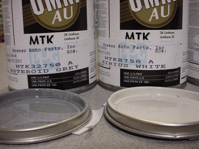

T-1391 - Sirrius white

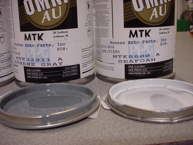

T-1506 - Pan white
T-1393 - Asteroid grey
T-1620 - Athene grey
When he punched the code in for Pan white it labeled it, "Seafoam". It's still white, but PPG must have had a new name for it?

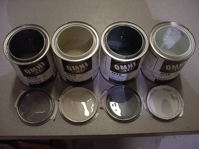

Pics of the stuff in the cans, hopefully I will be able to spray some white tonight on some test panels and then shoot the grey over the top tomorrow.

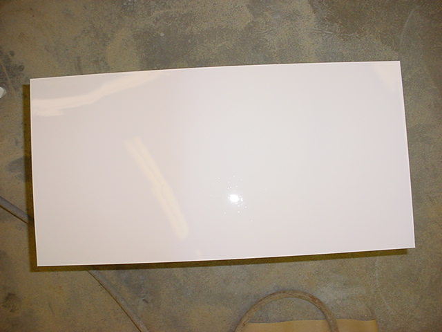

Ran home for supper because I have to work late tonight, sprayed Siruis and Pan white. Was hoping to spray both greys on 2 different test panels tomorrow, but my wife had a fit about something............. :frown:
