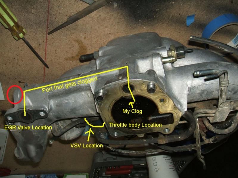

Does anyone know a way of cleaning the port with just the throttle body off? I had the throttle body off and that gave me enough room to get to the VSV and I was able to clean the port to the left hand turn. I couldn't figure out a way to make that turn with anything that would be stiff enough to scrape the carbon off. Any ideas? At this point I have a new EGR modulator, VSV, and a partially cleaned port. I haven't driven it enough since to know if this cleared my code, but I'm thinking that the port needs to be cleaned.
There is a way to clean the blockage without disassembly.

If the upper intake manifold is separated from the lower section there is access to what looks like a plug on the backside of the manifold (area circled in red). Is this a plug that can be bought through Toyota? If so, it looks like removal of the plug would provide straight access to the area that tends to clog. Then you could possibly use a wire shotgun bore brush in a drill with some fuel injection cleaner to give the inside a good scrubbing.

With the upper intake pulled, it would be easy to clean. Even without pulling that plug, you could uses all kinds of things to get in there an unclog the port. I was trying to figure out a way to do it with just the throttle body removed. Mostly, I don't want to have to remove the egr valve, but I guess it's inevitable.

Didn't want to pull a bunch of stuff apart just to look at it, so in order to check for a plugged egr port as shown in the pictures from Flank above, I just pulled the sensor and started the engine. No massive vacuum leak from that, so I pulled the throttle body. Port was plugged, so I dug it out with a pick, cleaned up the mess, plopped the throttle body back on, started it again.

My port looked and appeared 100% clogged it was actually worse than Flanks appeared bulging out of the inside hole and the hole that comes around where the gasket sits was clogged 100% as well. It puzzles me why I have not received the P0401 light prior to this due to the extent of the clog.

Did this to my LX450 today and what a huge difference. My port was plugged and bulging out by a 1.16th of an inch. I also had a lot of carbon and oil built up in the intake and runners which took the better part of 2 hours to clean to my satisfaction.

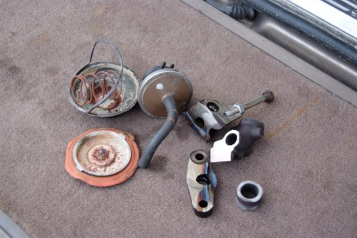

I have also defeated my EGR problems. I hate this system so much that I had to cut the hell out of it. Who invented this? First you use filters to clean intake air and then you let the EGR pollute it all. It's like breathing your own farts or eating your own... nevermind.
So it's 1:0 for me :-) EGR defeated and resistor installed
