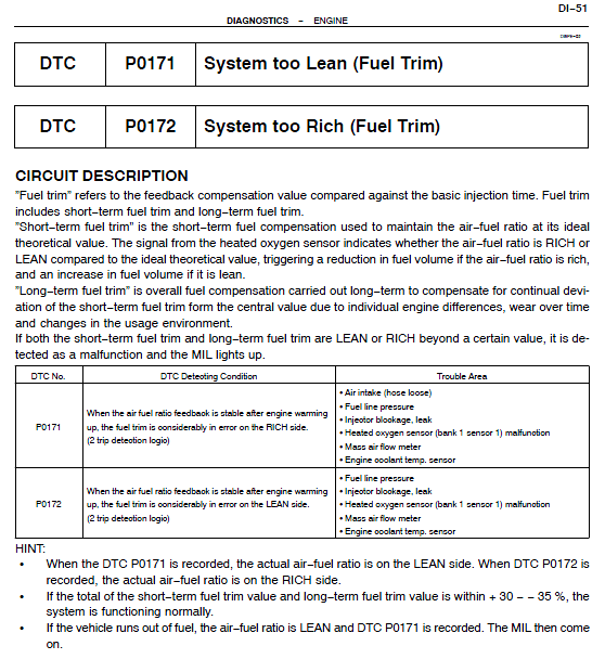

P0171 is lean mix. The code is indicated when the ECU compares two ratios to the sensor inputs, from a couple of sources.

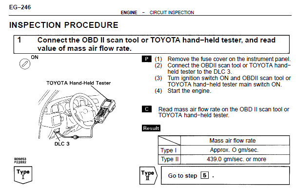

Thanks for the reply Malleus, heres the specs from mech. We tried used Maf( mech still thinks no good), new fuel filter, new gasket y-pipe, clean fuel injection system. I think im going to try and find a MAF in town here (one other cruiser that i know about) and throw that in if i can convice buddy to let me try and rule out that. Maybe bad injector, very slight rough idle sometimes. They think Fuel delivery is good.
This is the point I was getting at. It looks like your mechanic's using a generic testing protocol. He needs to use the FSM. I doubt your problem is the MAF. It's more likely a fuel delivery problem. This isn't something a mechanic can "feel", the system components and operation have to be tested. There are explicit diagnosis and troubleshooting procedures for this code.
