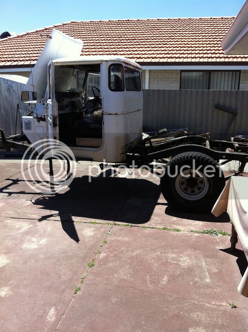

white cab is 75 the chassis under that is now destroyed, still have the 2f that is on the restored one
beigey colour on trailer is 77 and chassis that a PO recently restored (crap job), took some white parts with me and various others too

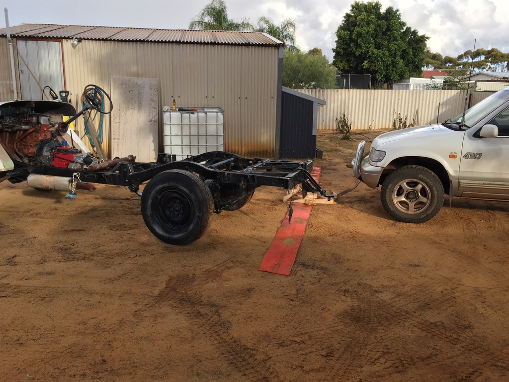

got it on the trailer
other body mounted on
all strapped up and ready to travel 900~kms

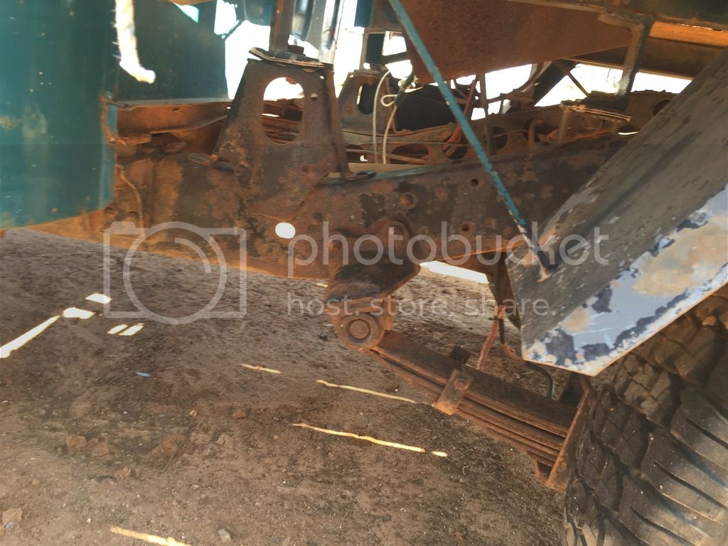

finally got the old girl(s) home and in the shed making it harder to move around and the rolling chassis undercover, towed about 3 tonnes worth with my 4 cyl diesel daihatsu turbo, she did well, but the trailer didnt hold up, broke a spring perch and didnt know till we unloaded which is good
some pics of the chassis

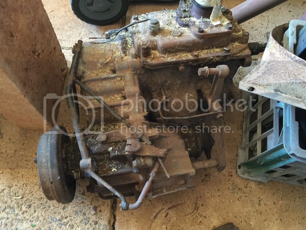

some pictures of the stuff i got given, most of the stuff im not sure what it all is but i posted on a FB group and got some help so ill name to th ebest i can with theese items. the first of which people would be familiar and i may put it in my build if it will fit ;)
early 4 speed pre split transfer / h41
h41 four speed late split type transfer, upposibly off a H motor
early 40 / j30 transfer case
split transfer from late 4 speed with vaccum shift / or a 60 series transfer supposibly / or a so called 1982+ 19 spline split case
custom made clutch fork to suit toyota cable im sure of.. riveted on there
now for the bell housing pics... no idea what its off but the rear of the adapter goes to a toyota box, some ideas were that its a h41 bellhousing, dyna 4cyl, h motor bell housing and fywheel housing 3 bolt holes could determine earyle type engine mounts, or an adapter to some 6 cyl old ford or hemi. pics below feel free to pitch in..
