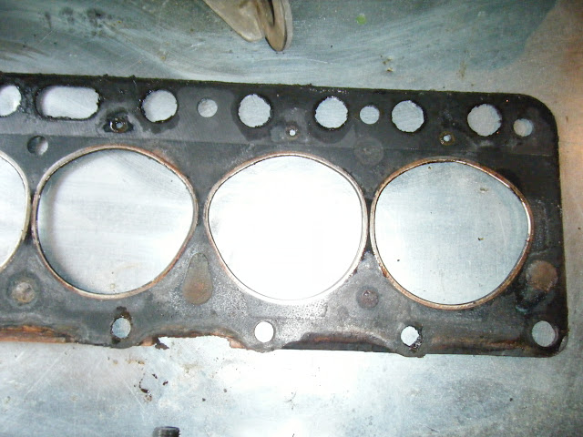

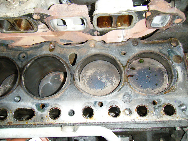

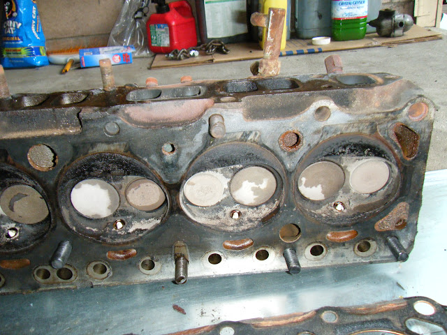

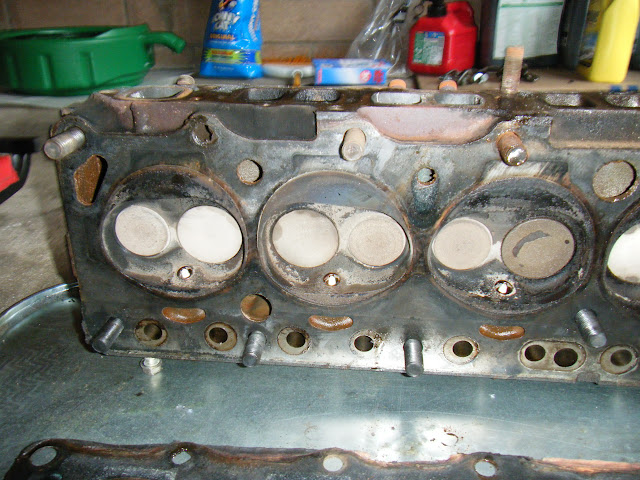

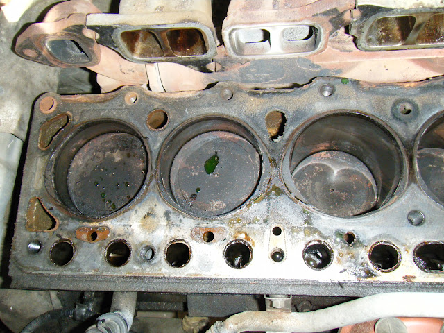

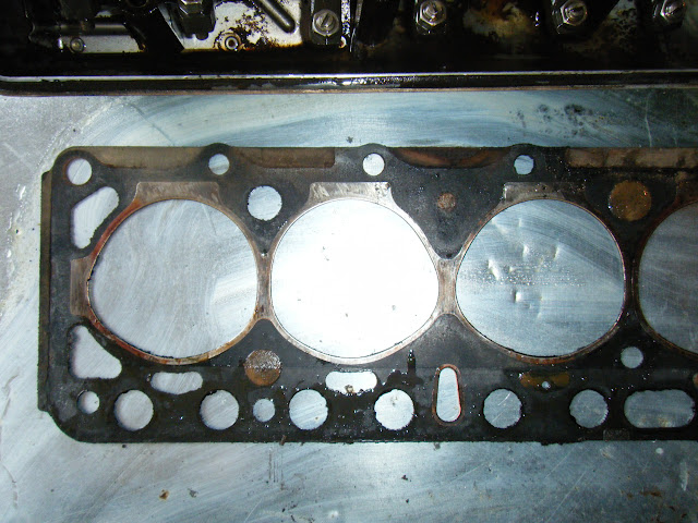

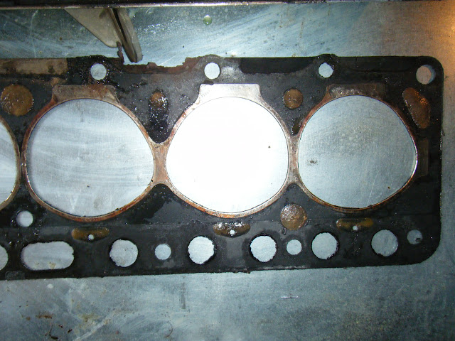

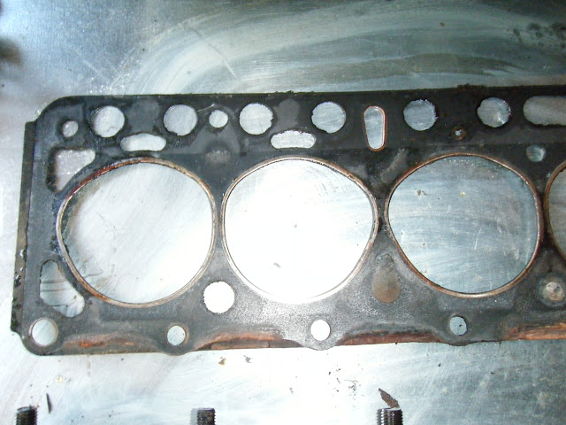

Today, I got the head off. I don't see any immediate signs of head/gasket failure. I just don't know...
All of these pairs of pictures show cylinders 1/2/3 in the first picture and 4/5/6 in the second.
Top of head gasket
Bottom of same
Head
Block

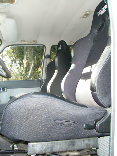

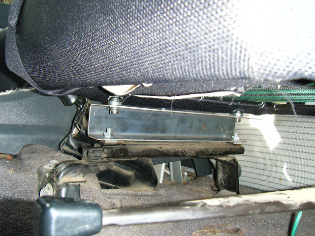

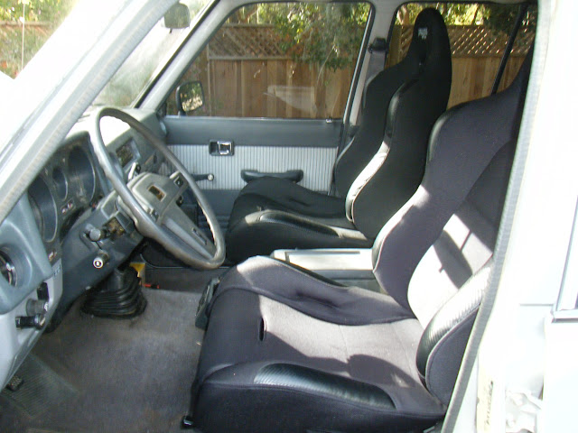

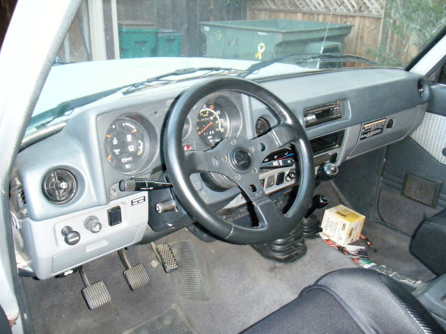

Once I got the head off, I couldn't do much else without making a big decision to take the plunge and pull the rest of the original engine out, so I decided to do some "fun" stuff. I had a set of Hunsaker seats and a Grant steering wheel, so I got busy putting them in.
I have very long legs for a 6' guy. I wasn't comfortable with the seats at the stock height, so I had some custom 2" brackets bent up at my favorite metal shop. I had some flat bar cut down and drilled as spacers so the factory sliders could work properly, and bolted everything to the factory mounting holes. I LOVE these seats and the revised seating position.
As for the steering wheel, I noticed that there was a good layer of crap on the original wheel while driving it home on the day I bought it. I wasn't to happy about grabbing on that all the time, and with the higher seat height, the original one was really close to my legs. I grabbed the Grant wheel off the shelf in my garage and put it in the Cruiser. I have GREAT gauge visibility with my seat height and think this will be a very comfortable driving configuration. I'm sure it may be a little tough to turn at a standstill once I put 33s on, but it'll be ok.
I purchased a Tuffy stereo security console from my local parts house and worked on getting it into position but ran out of time. I'll post pics of it in place once I get it in there. I will say that the top pad is at the perfect height for my arm to rest on and be ready to shift. I'm VERY happy with these upgrades as a whole. Now before anyone goes off talking about how I should get it running before making it comfortable, let me just say that, with the exception of the Tuffy box, I had all this stuff sitting around from previous projects. I hope someone here enjoys seeing this stuff.

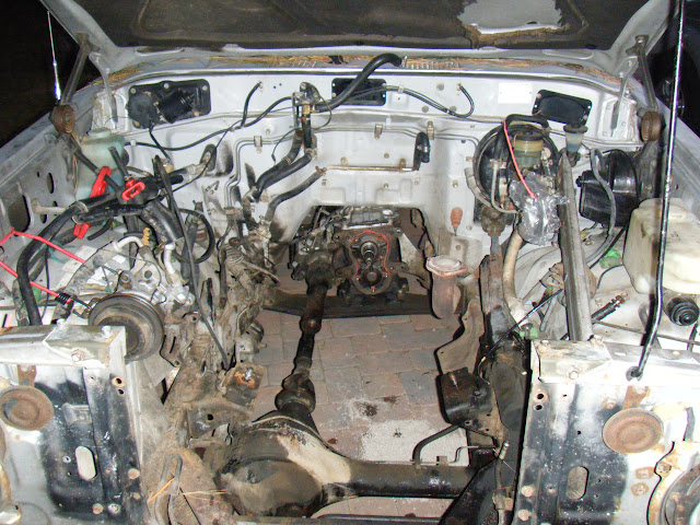

Well, the 2F is finally out. The engine bay is pretty clean, but I'll steam clean it and the undercarriage in preparation for the 5.7 Vortec I have on the engine stand. A Howell harness/computer and Mark's adapter kit are en route. Next week I should get the rig delivered to Ron and Frank at Custom Cruisers in Gilroy to get the engine mounted and radiator fab started. I planned to keep the H41, but knowing that the trans and tcase will come out for the machining of the tailhousing for a custom reluctor ring, I'm fighting the desire to get an H55 in there. $2000 I don't really want to spend, but I hear they're awesome. Anyway, here are a couple of pics.
