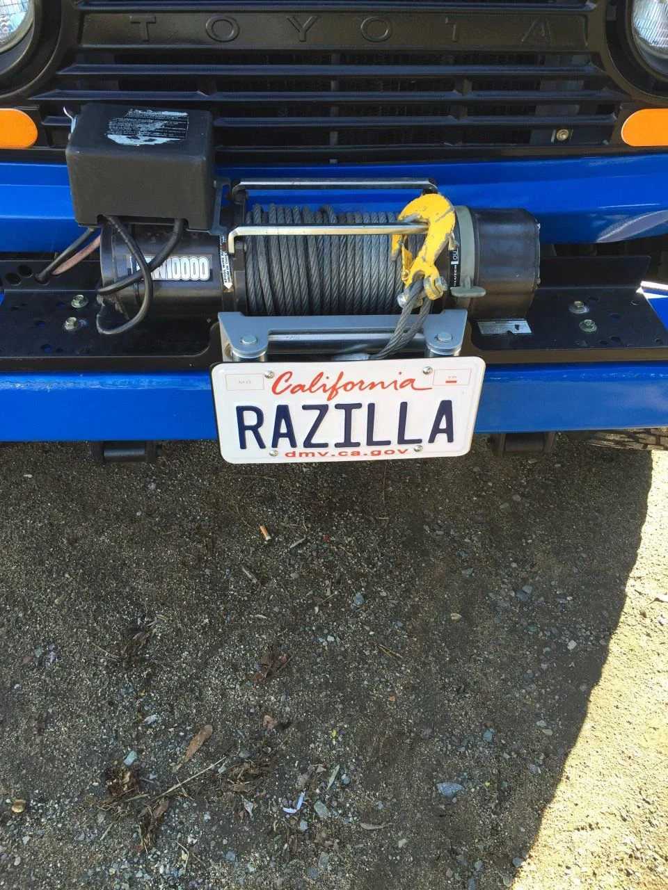

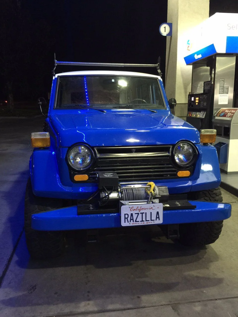

1972 fj55 the build is in month 15 sourcing parts from everywhere . 4 wheel disk brake conversion . Fjz80 master brake power booster and resevoir , fjz80 wheels , 8kwinch , tail gate motor from spector . Custom original bumper mod as seen in picture painted it blue , toyota 4runner power steering pump , header , 2 barrel holly carb , 1F motor , 3 speed trans , seats are original and new upholstry, new carpet kit , new rubber throughout , new turn lights , new back up lights , has a full tool set under back seat , brake lines new, new radiator hoses , tow package , new headliner from spector , custom knob from Pablo Cruz for glove box , new windshield glass and rubber , highland roof rack for my canoe , and more

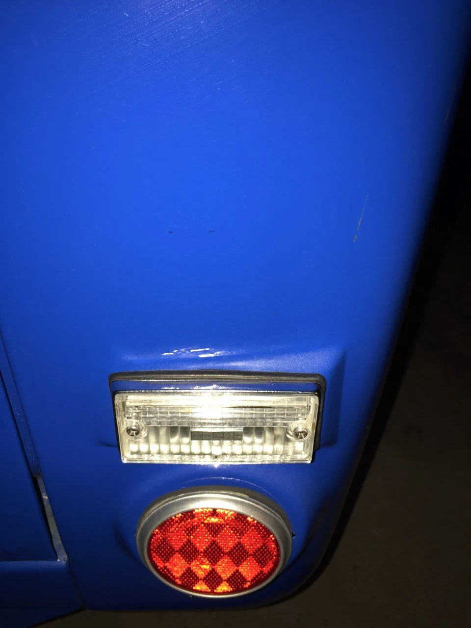

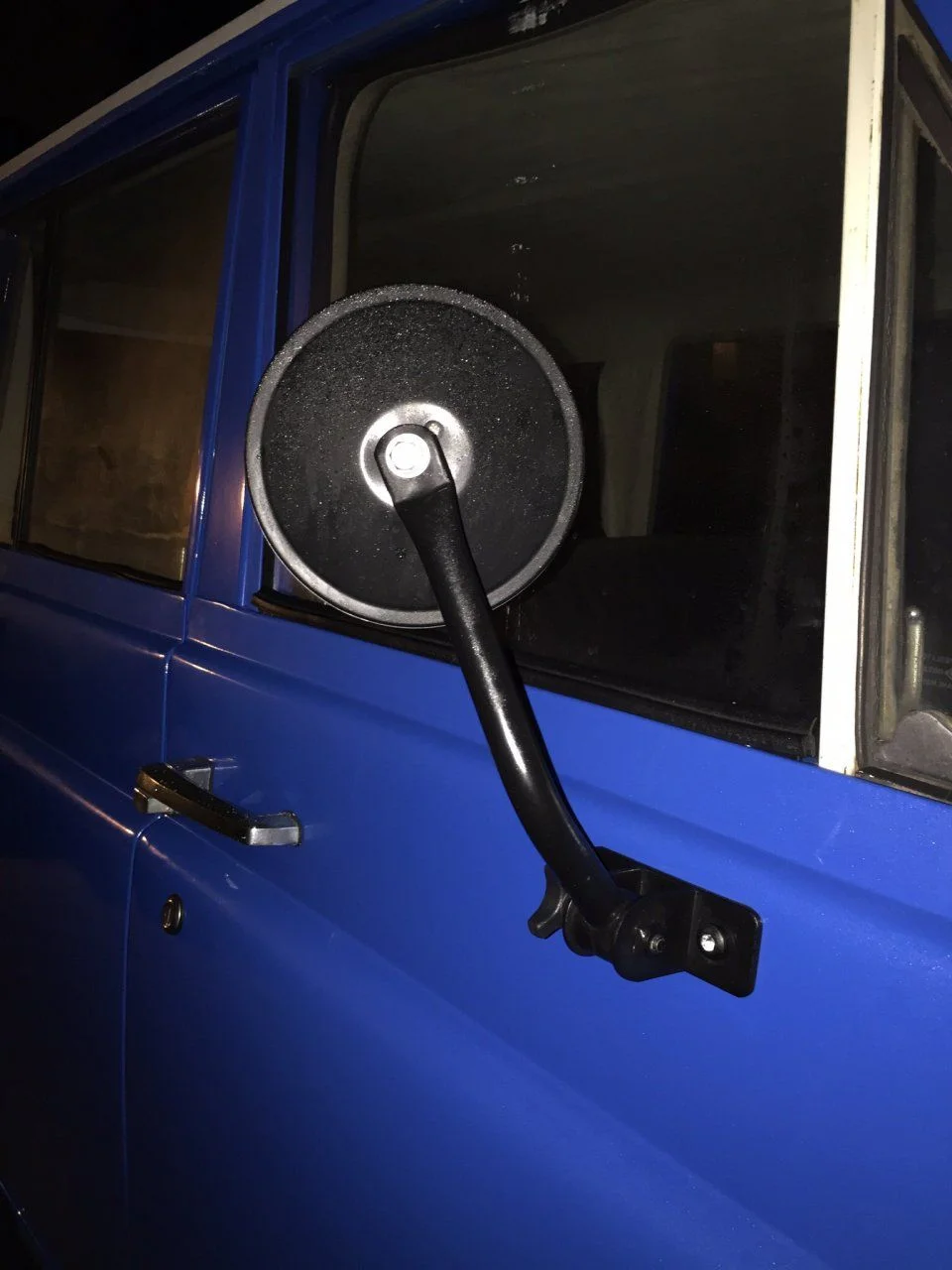

Did I miss the year of yours? I know on my 71, which has the smaller back up lights, you can get new state side. I can look it up, but I thought from a Toyota dealer. Really liking those mirrors.
The reflectors are from O'Riellys Auto parts but need a little triming to be the same size as OEM cost $5 ea
