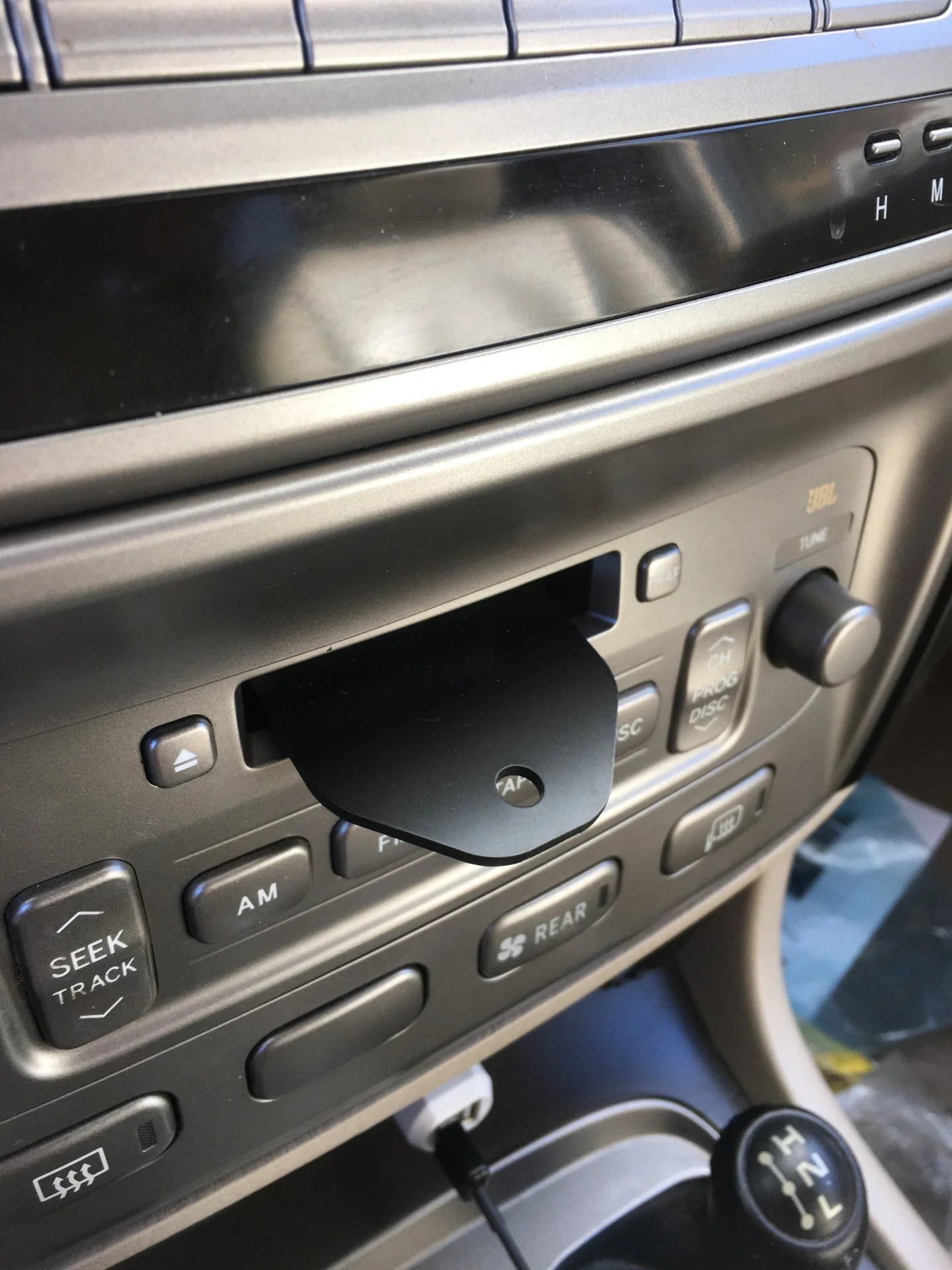

Installed mine a few weeks back, finally getting around to pictures:
I used this phone mount, although they also make tablet mounts as well:
Perfect Squeeze Phone Mount
Used two threaded balls to allow another arm below for my GPS, still working on getting this part dialed in and will post more pictures.
Overall impression is excellent, this thing is very solid and held up well to 500 miles of dirt/washboard/minor technical sections (hence the dust). The phone mount didn't move at all, although the GPS mount vibrated quite a bit which is likely an issue with the mount I have. Nice to able to change position of each device or remove depending on the current needs. As a bonus for me, it also allows easy swapping between the cruiser and the moto.

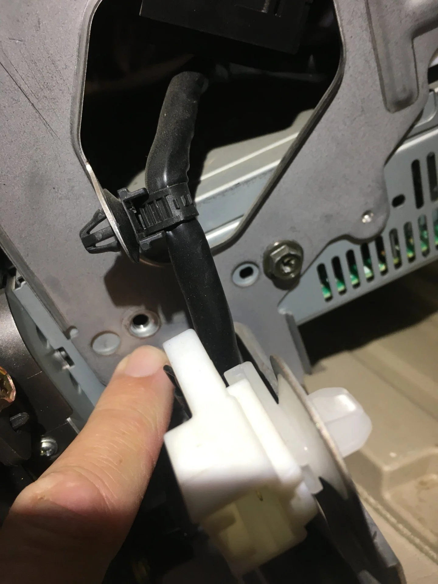

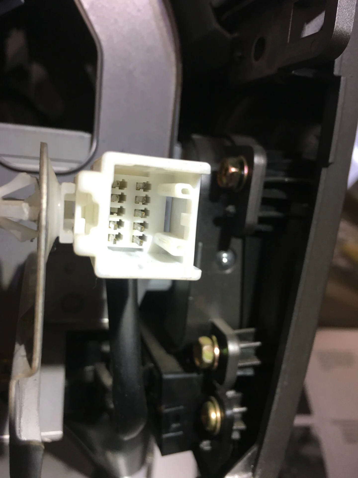

For the 2003+ Land Cruiser install, just remove every connector with an 8mm head (and two Phillips). While balancing the edge of the nav on the console location, the bottom frame section around the tape deck will fall forward allowing the deck to easily come out. One tricky connector is located under the nav that connects to the cassette frame. You’ll need an extension for this one. You’ll also need to remove antenna and, I’m assuming, gps cable from the back of unit. Great work on this @Ramathorn15 - feels really stout and can’t wait to get some weight on it.
Some useless photos:
