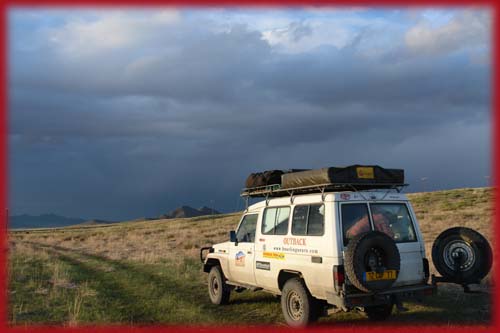

I'll play. For those of you who can read a little bit of French, here's a great web site I already wrote about in another thread, especially the one about these guys' HZJ 78.
http://www.chateaudebrou.com/humanitaire/materiel.htm
And in action... in Mongolia:eek:!
