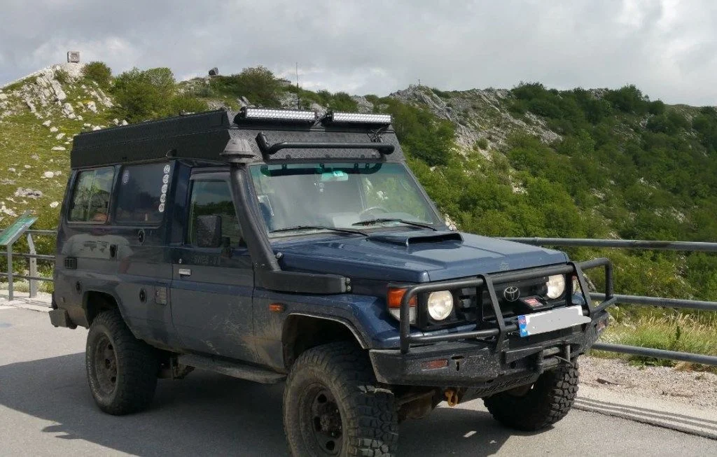

I got this 2001 78 2 years ago. The car had a pop-up roof and some old trashed interior. I tore this out and rebuilt all of it. I have a blog where you can read about the building, water, diesel heater etc. Also some 80 build stuff in there, and a summary of my 10 year of overlanding experience. What mods, and what stuff to bring. Plus travel stories and cruiser DIY stuff.
