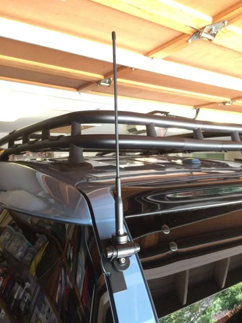

At this point I bolted the crawl console bracket back in and turned my attention to wiring. No pictures of that, since it’s straightforward. But to summarize I ran ground and +12v power directly from the battery, the antenna wire from the Diamond K400 mount on the rear cargo door, and an ethernet cable I had previously installed in the center console for the microphone. All of these went up through the DS A-pillar following the factory wiring path. I ran them laterally straight past the crawl console bracket and then looped around above the headliner over the passenger seat so they could all exit through a 1” hole I cut in the headliner just forward of the plywood spacers. Norm Abram would have approved: I measured the location for the radio mounting bracket, plywood spacers and wire hole about 10 times from several directions and then “cut once.” It all turned out great.
Just a few more photos - one of the Diamond K400 NMO antenna mount and Comet SBB-1 antenna, and a couple of the microphone in the center console. I also needed to purchase a 3m SMA male to SMA female RG316 coax jumper cable ($15 on eBay) because the coax that came with the K400 wasn’t long enough to reach the radio. As a final step in the installation I measured the SWR at the radio and it was 1.1, so nearly all the RF is going to the antenna.
