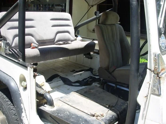

let me see if i can post a pic..... i used a dodge caravan seat came out good...

na i fit back there with top on i'm 6'2 sat it back there figured about where it needs to be... left room for the rear angled the bottom of it up a hair and bam 30 dollar seat works great.....yea troop seats do look great but only 4'6 person can sit comfy....

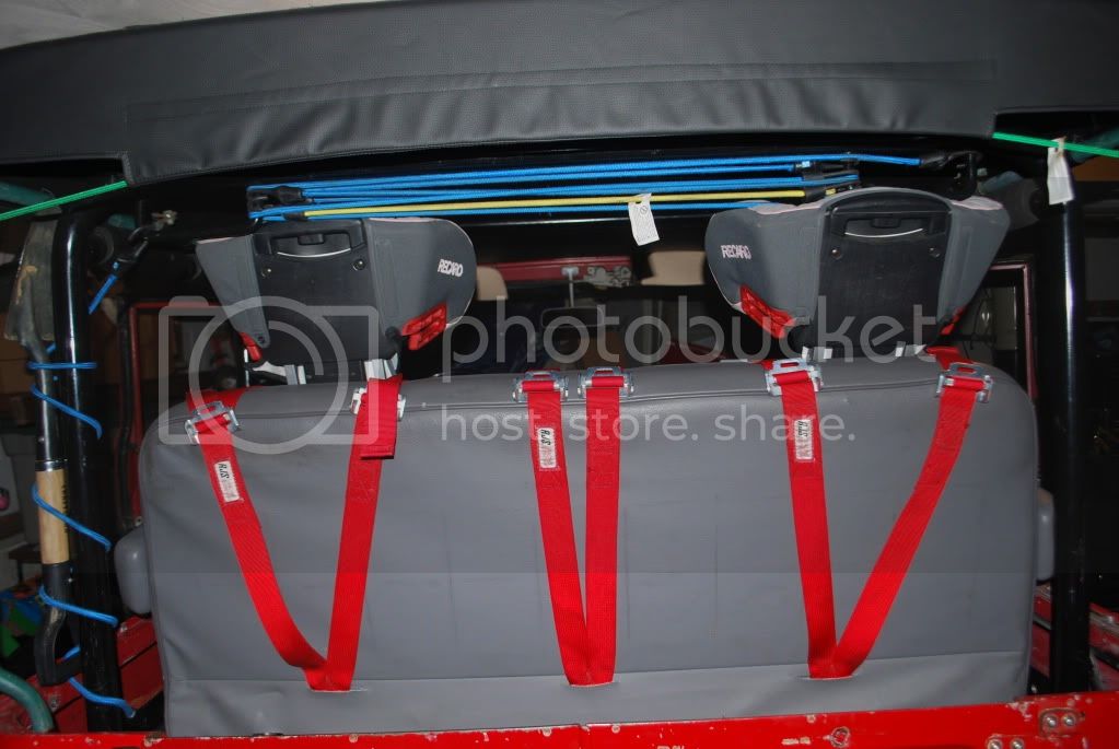

Here's my set up. The seat sits on the wheel wells and is from a full size Chrysler van. It is 54" across and seats three kids very comfortably. It is still just mocked up in these photos as I haven't had a mounting bracket built yet.

If it's over the wheel well, how high up are the kids sitting. Obscure your rear view any?
What kind of seatbelts are those? Are those Wesco?
