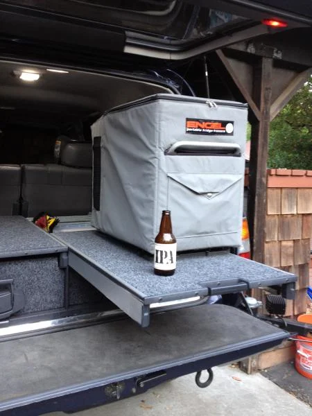

This was our first install of this product and I have to say I'm pretty impressed. The fit and finish and modularity (word?) of the system is superb. It's quite a feat of engineering to make this such a robust but universal system.
Pictured: Roller floor on driver's side, drawer with fixed top on passenger side. 80-series fit kit on passenger side (cannot be used - without modification that wasn't completed here - with the roller floor). Engel MT60 Combi fridge and freezer with insulated transit bag. Added power inverter in cubby of fit kit on passenger side.

Very Nicely Done!
They could add some tie downs and dividers in drawers.
Looks great. How difficult would they be to remove if i needed to?

Not too difficult. Most of the install time is taken up in the initial fitment. Once that's done and the frames for the two sides are locked in position it becomes one unit and won't come out of alignment. Would take maybe 30 minutes to remove. You'd need two people to lift it out unless you wanted to completely disassemble it down the the frame, which would probably take another 20-30.
