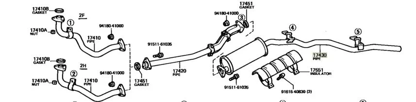

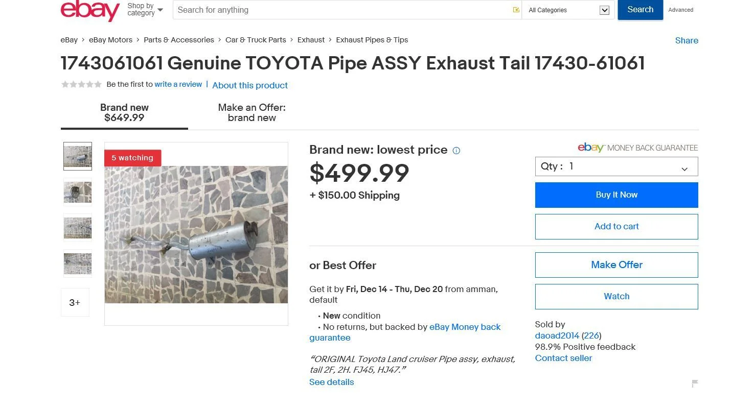

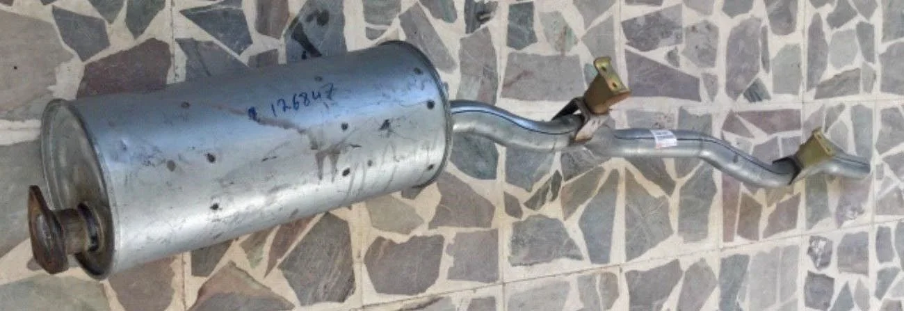

Yes, as far as I can tell the OEM is still available but at a hefty price and mostly not in this country. With the shipping and cost of the system you can pay up to $500. It consist of the tail pipe, muffler, and I think the front flange pipe of the muffler. Part number 17430-61061. Looks to be the correct size pipe wise for the FJ45.
