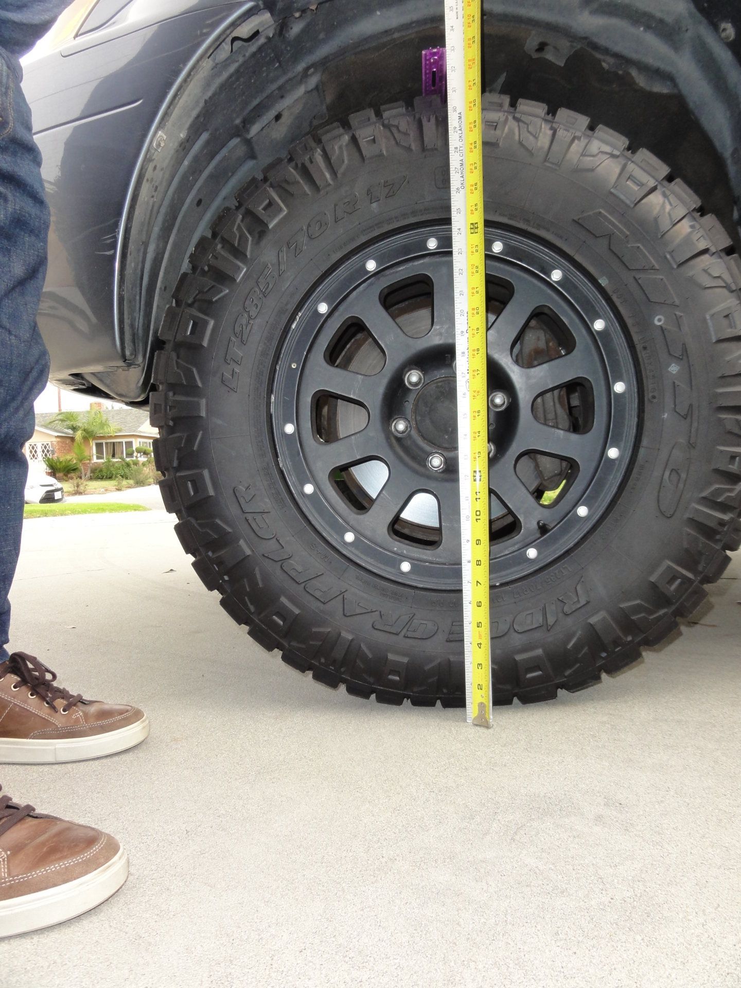

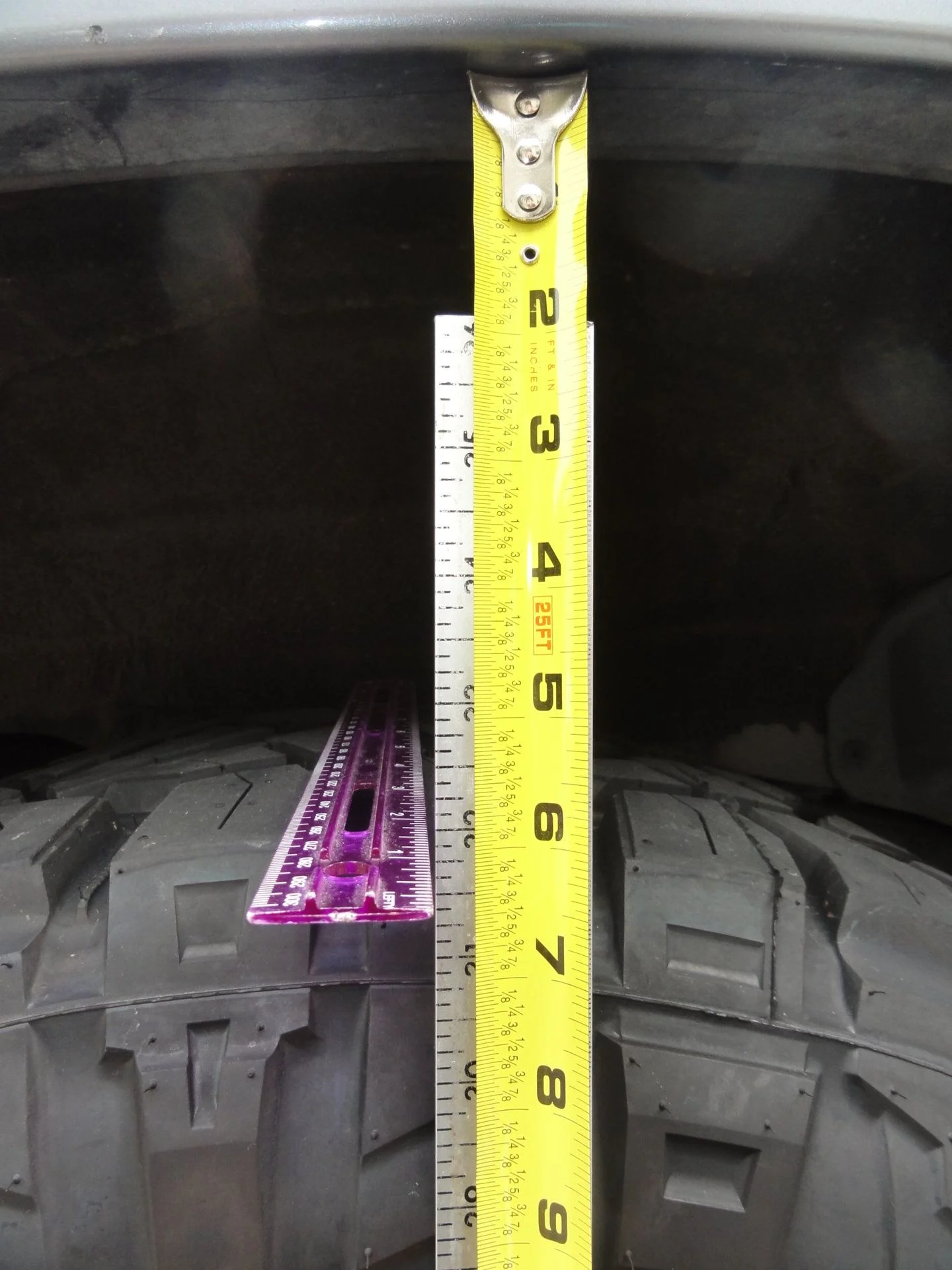

How are you guys measuring the hub to fender distance? I'm having a heck of a time doing precise measurements. I'm eyeballing it, but can't get that perfect measurement.
Gound to bottom of fender:
Front = 38 1/8
Rear = 38
Estimating the middle of the hub:
Front = 15.75
Rear = 15.5
So, 38 1/8 - 15 3/4 = 22.5 for the front and 38 - 15.5 = 22.5 for the rear. I'm just eyeballing. How are you getting exact measurements?

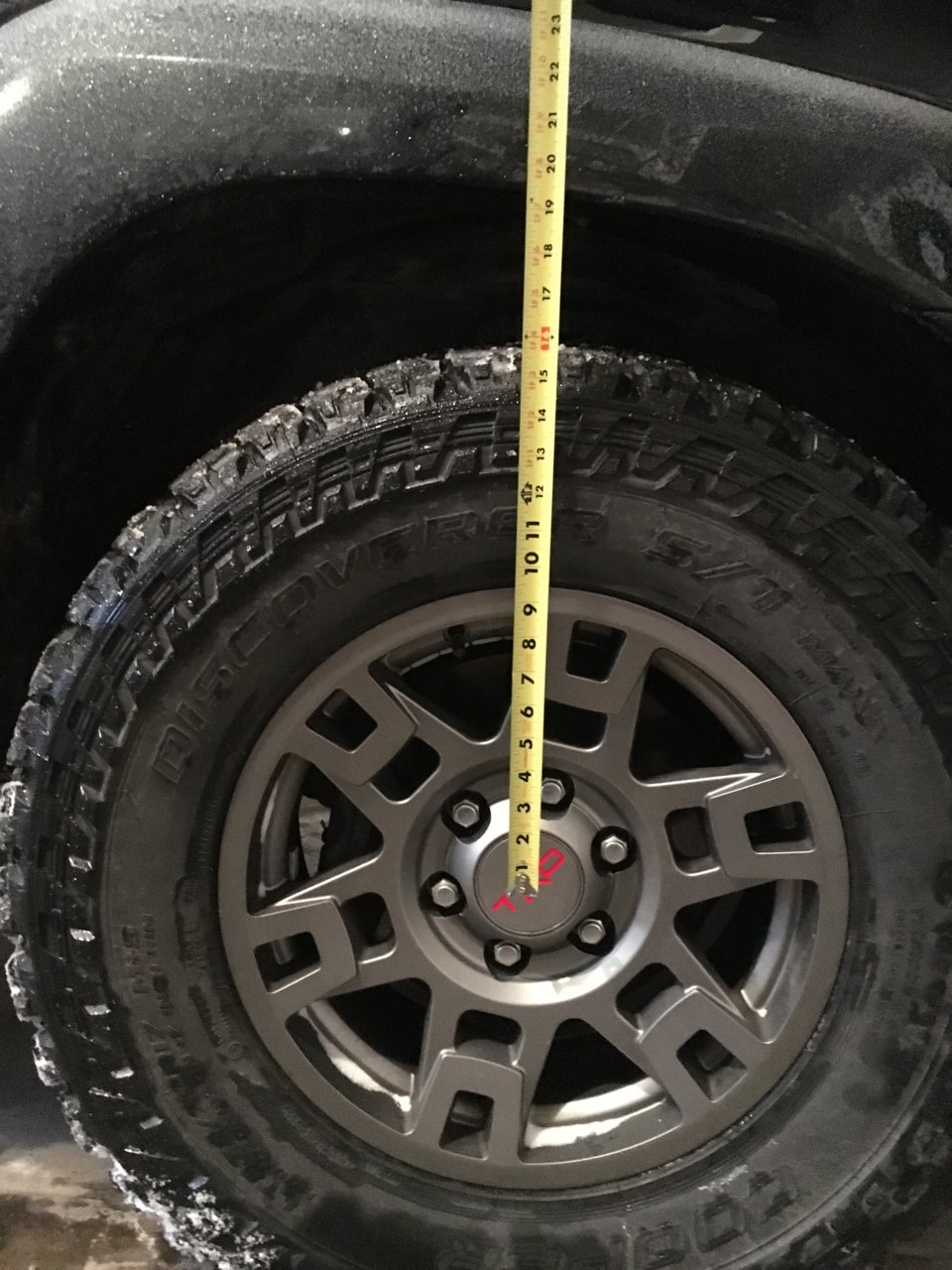

I measured from the center of the hub up with a level so I went straight vertical to the fender. I found the center by measuring the diameter and starting at half the diameter to approximate the center of the hub.
That’s honestly as much thought as I put into it.
Okay, but I noticed that my tire is 32” tall even though it’s listed as a 32.78” per Nitto specs.
I did notice that the bottom half of the tire that touches the ground is about 1/2 to 3/4 of an inch shorter than the top half of the tire. This makes sense since the tire is squished at the point where it touches the ground.
So, my 32” tire is 15.5” on the bottom half and 16.5” on the top half. Add about 6” gap between the tire and the bottom of the fender and I get 22.5”
Anyways, it’s not exact and that bothers me.

Haha I'm not sure what's going on in those pictures. Reminds me of this meme.
full
Anyway, just eyeball the center of the hub and then go as straight up as you can to the fender. It won't be precise, but it works.
It's even easier when you aren't doing it one-handed and taking a picture.;)
