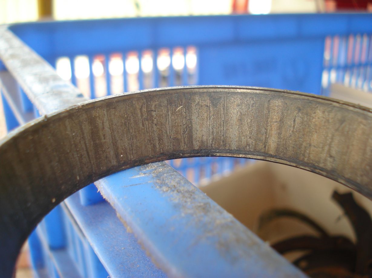

3mm high tensile ali sheet is impossible to bend by hand or even with decent tooling. Ive had to get it all rolled... ah well
another update,
Started on the funnel side, i have to get the other piece rolled b4 i can finish the manifold side.
Its gonna take some specky pieces to go from the 3" bend to the funnel.
