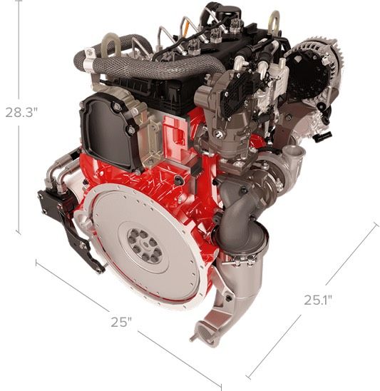

And as Stan said ... The 2.8 .... WOW if it was going in a 40. But a 6000 LB 80 would need a little something more.
In Mexico and Brazil, the F-350 we received last decade was still in production as of 2015, with a Cummins 2.8-litre diesel. With the right gearing, it may just have that something more to push an 80 around.
"Ford Motor Company offers the ISF2.8 Cummins in its South American fullsize chassis cab pickup line. In these applications, the engine produces 147 horsepower and 265 lb-ft of torque. In the Ford Brazil F-350, the Cummins powered pickup comes with a payload rating of nearly 4,700 lbs; quite a haul for an engine that only displaces 169 cubic inches."
The 4x4 F4000 runs a 4.88 axle ratio and a 6.13:1 first gear. The 80 in low range may be comparable. 2nd gear in the F-4000 is 2.83:1 which is more comparable to the 80's 2.804:1 first gear ratio. First gear in the F-4000 is just granny low, so unless towing, you prob start off in 2nd gear anyways.
F-4000 4x4

I would like a computer controlled Cummins in Moonshine to have more control over my tunes. I love that I can flash a tune onto my ford depending on the situation (towing vs street driving). I'm scared to put the full-on power tune on my Ford because I don't want to get a taste of what this engine can make :D
Cummins has made plenty of variants of the 4BT that are computer controlled, the ISB3.9, QSB3.9, and QSB4.5 as examples. If I had 9k to spend on an engine setup and $X to spend on a transmission, I'd go with a QSB4.5, ZF-6 transmission and atlas 4-speed transfer case. Plenty of gearing for offroad, plenty of OD gearing for the highway, and a computer controlled 4BT with 25% more displacement than what I have now.
That said, I may be biased, because I have a QSB4.5 sitting in my garage that will eventually become moonshine's next engine :hillbilly:
Would it be harder than a 4BT with all the electronics, or easier? Can you just buy a chip?
If you get an engine kit like the R2.8, then all you'd have to do is wait for a while till the big diesel tuner shops come out with tunes for the R2.8. Once they do, buy their tuner and tunes, then plug into the OBD2 port and flash the tune onto the ECU. Takes maybe 5 minutes total time to flash a tune. Same with the Duramax engines, Powerstroke engines and Cummins engines in the dodge trucks.
It goes without saying that an engine has to be tuned in a safe way. Turbo diesels need intercoolers and need their EGTs in check. Gas engines need a safe AFR and applies more so when forced induction comes into play. Too much fuel in a diesel will make it run hot, and could melt it down. Just the opposite in a gas engine, too little fuel in a gasser will make it run hot, and could melt it down. Ring gaps need to be opened up if adding a lot of forced induction to a NA engine, etc. Lots of little things add up to a tuned rocket ship of an engine that maintains it's reliability.
That is a solid question. I'd go with a diesel for sure, the question is which one :hmm:

The QSB4.5. I know what software I need to get in and read the ECU to change parameters on my own, when the time comes. I don't think there are tunes available, but I can make my own :P
The QSB4.5. I know what software I need to get in and read the ECU to change parameters on my own, when the time comes. I don't think there are tunes available, but I can make my own :p
Awesome on the tunes.
I meant which version of the QSB 4.5. I may be wrong but I believe there are 4 different versions for that engine from Cummins with the best making 520 ft/lbs.
There are dozens of iterations, not four, of each engine cummins puts out. The major revisions have a model designation, 6AT, 6BT, 4BT, ISB5.9, ISB3.9, QSB4.5, QSB5.9, etc. Each major revision, called the "Engine Model", then has an associated CPL "Critical Parts List" that defines the specific assembly parameters. There are dozens of CPLs per engine model.
To directly answer your question though, this is a 110hp model, CPL 8401:
