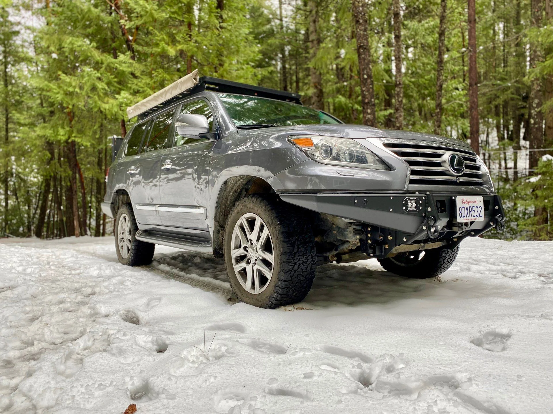

Well, winter rolled around again, as it is prone to do once a year, but this year I vowed to get out more. And so we took the opportunity when the kids were out for MLK Jr Day to head up to El Dorado NF. The kids wanted to play in the snow and while I was keen for some winter camping, the wife had some work to do, so we found a great cabin that was inside the FS boundaries and had electricity. Everybody was happy.
We spent the days exploring around Stumpy Meadows and Wentworth Springs Road. We planned on going all the way to Loon Lake (starting point for the Rubicon), but there was too much snow going over the higher ridges.
Overall though, the KO2s did really well. The snow was loosely packed, but there were a few mud bogs. I only had to lock the center diff once. The rest was handled pretty well by the ATRAC and the tires.

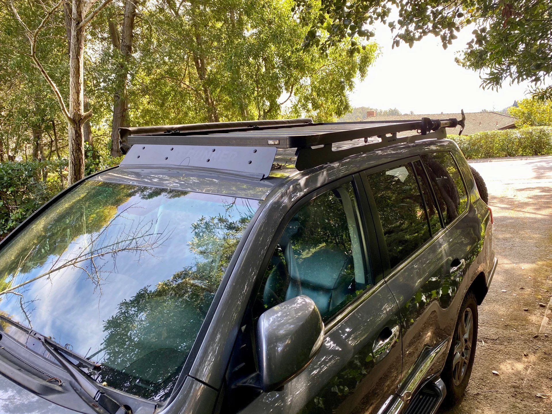

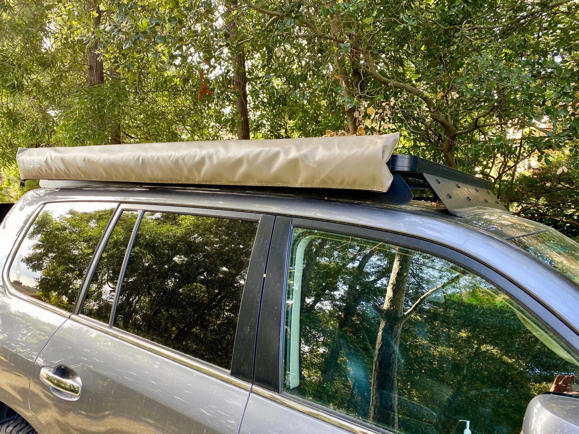

But I did manage to install the new wind fairing from FrontRunner:
Man, what a difference it makes. It is like night and day with the default "fairing". Damn is it expensive though.
I like FR as a company, but they absolutely should include this fairing with every rack. There is no excuse for it.
Still, I am much happier with the noise level and the fact that we can actually use the moon roof now.

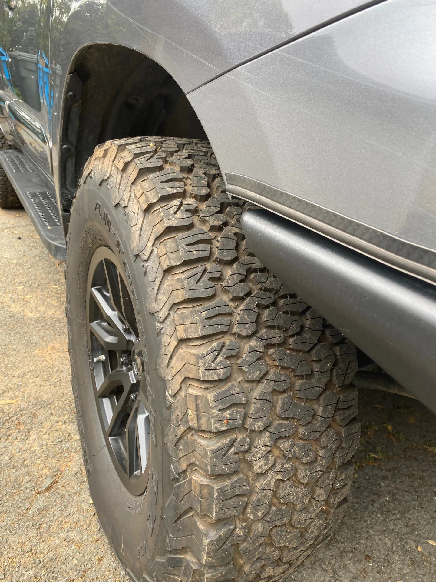

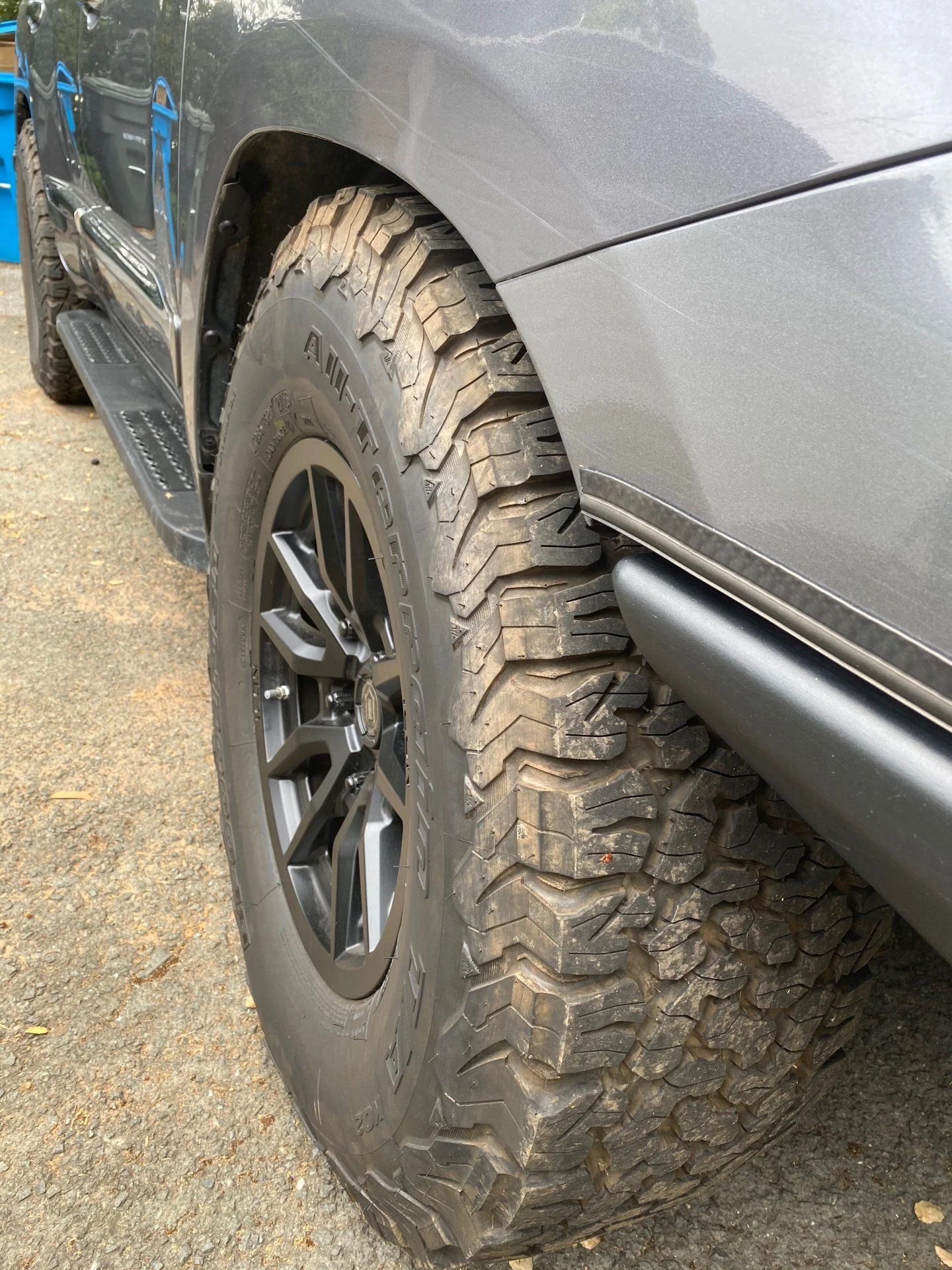

Amazing what some new wheels and bigger tires does.
One of the major questions I had pondered over the prior months was what size tire to go with. I really wanted 285/75/17 but of course this is not a common size for LX builds, and I was unaware of anybody that had this size on an LX without spring spacers or the sensor lift mod. It was a risk, but I decided that I would never be happy unless I tried it. The worst that could happen if there were fitment issues would be that I could exchange them for 285/70/17s or do a lift mod. Either way, no biggie.

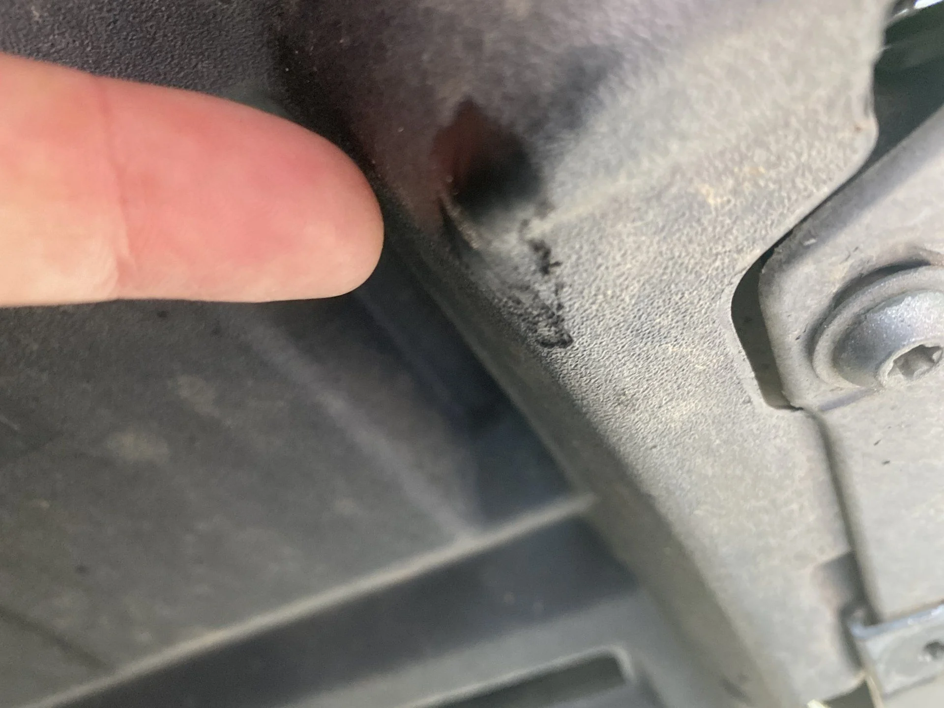

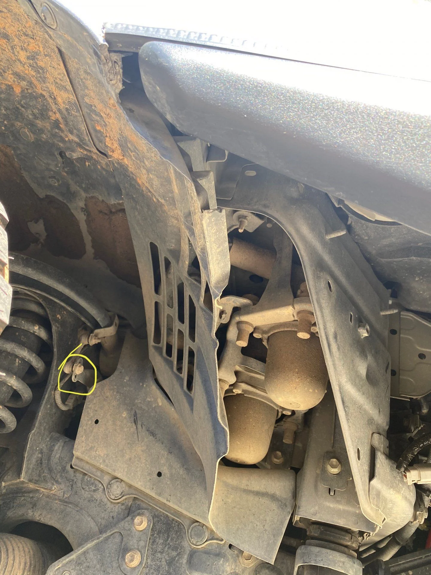

The drive from Ben's shop to my place is a straight shot down Interstate 80 so I did not expect to experience any potential fitment issues until I was out on the trails, so it was quite alarming when I was traveling at 70 MPH over a squishy dip and heard a scraping sound from the front drivers side wheel well.
Ugh!
The whole way home, any bouncy bump which caused a deep compression cycle.....

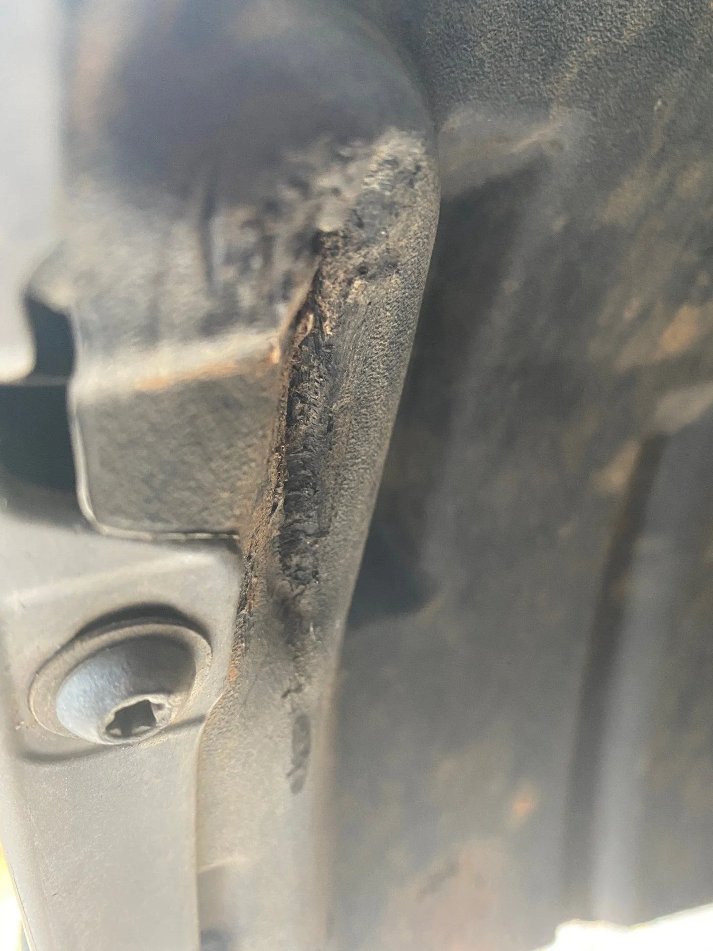

It turned out that the very edge of the tire was kissing the very corner of a hard edge of the liner, right near the panel:
After a little freaking out and consulting the fine people of mud, I settled down and pulled out the heat gun. Problem solved:
Pushing the corner in seemed to do the trick. No more scraping on the highway.
Although by this point I wasn't able to get it out on the trail to test under different articulation situations, everything seemed pretty good. In Normal, I have a little rubbing against the liner when backing up on an incline with full lock (maybe even a little before full lock), but nothing that bothers me.
In Low, I can pretty much only drive perfectly straight 😂.
Here is high:
Normal:
And Low:
With the fitment issues solved for now, I was pretty damn pleased. The wheels and tires turned out way better than I expected and the sliders are fantastic. The wife is happy that we still have a decent step with entry light too.
Probably the best part about the wheel/tire mod is the improvement in ride. It's just remarkable. It is exactly what I would expect and have wanted since I bought the truck, but has been elusive to this point. Combined with the new wind fairing, and it is like a new truck. Nice smooth ride, and a nice quiet cabin. The handling is much better as well in my opinion.

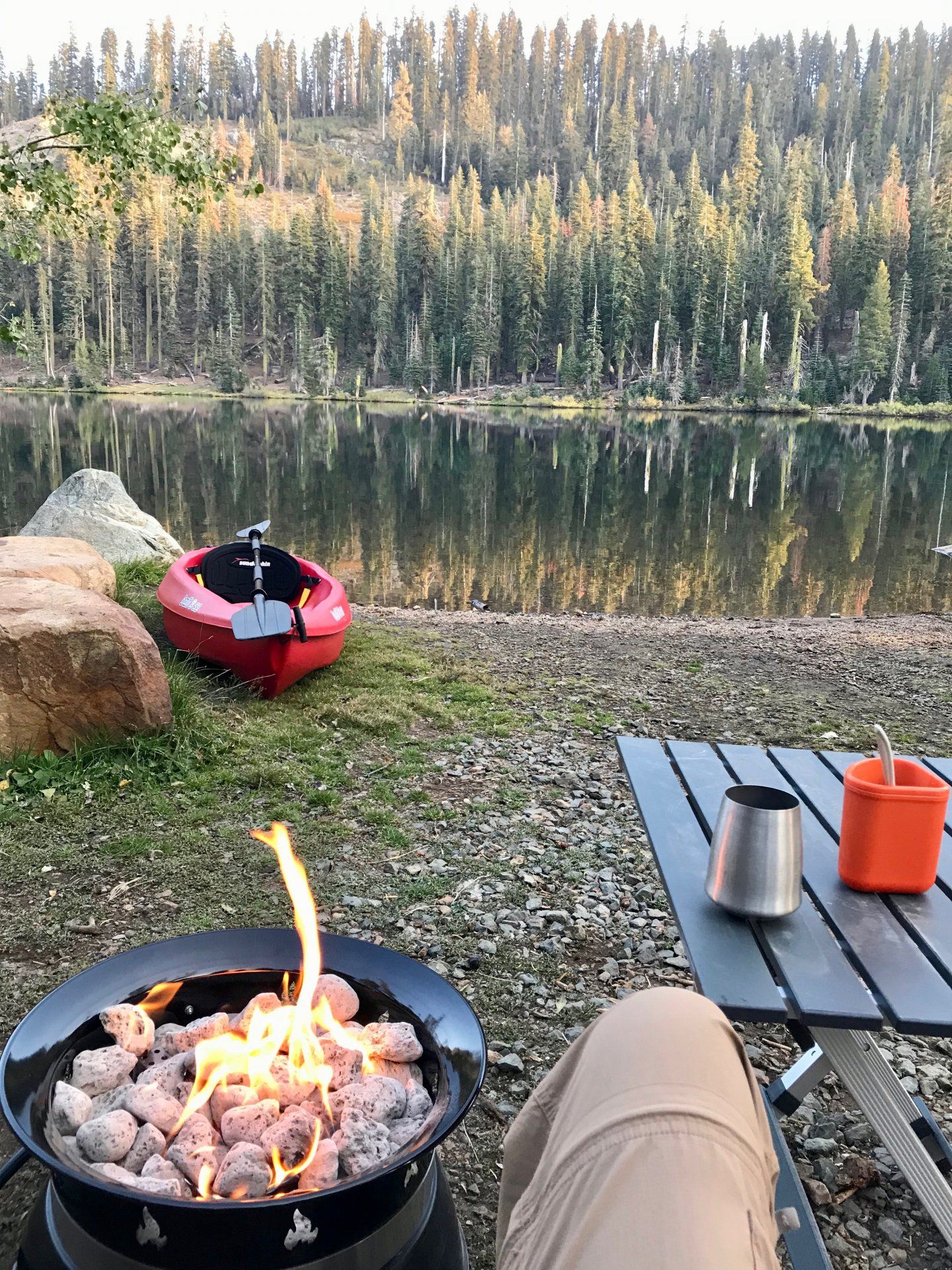

The other piece of gear that has turned out to be better than expected is this Outland Firebowl:
It's ~25 lbs, has it's own carrying case, and has a substantial flame to it. In this pic it is set a little less than medium. It is approved for use when there are fire restrictions in place (still need a fire permit though), so we have sometimes been the only ones with a fire (which makes us popular in campgrounds).
It seems like extra weight and bulk, but it is almost exactly the same size as a "standard" bundle of firewood, and what an amazing thing it is to be able to setup camp and sit down with an instant fire - no fuss. And no smelling like campfire.
Call me spoiled - I aint apologizing.

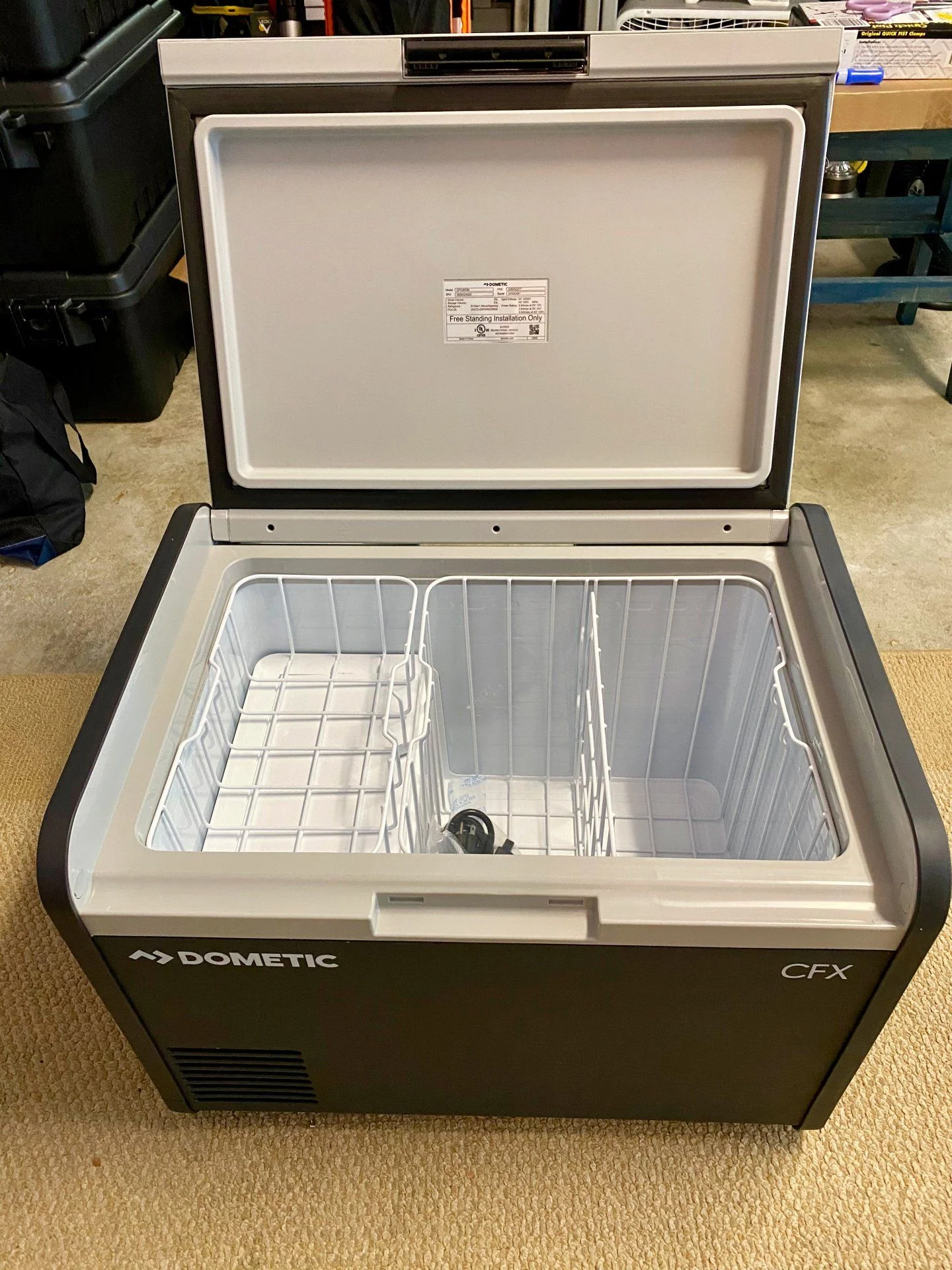

Speaking of extra heft, we finally broke down and bought a fridge. For whatever reason, I had been resistant to do this. I think mainly because it seemed like such an "appliance" and messed with my notion of simplicity. I think we can all agree, though, that I left simplicity sitting by the roadside long ago. There isn't any going back with this build and for some of the trips we have planned, a fridge is the only solution. Frankly, I was also really frustrated from one of our recent trips that all of our stuff was waterlogged in the cooler. Usually we take great care, but for whatever reason, we ended up having to throw out a lot of food. I know this is bound to happen sometimes, but it still sucks.
So after over-analyzing and over-researching, I realized that the major producers of overlanding-worthy fridges are a lot like the major producers of household appliances. There are only a few suppliers for the internal components with the compressor being the most important component, but otherwise, it all boils down to build, features, and price. There are a few considerations: Dual-zone? Side-opening or end-opening? Size? Power draw? Insulation? Bluetooth capable?
We decided that we did not need a dual-zone. While it might be nice to have on a few occasions, for most of how we travel, we don't need to keep things frozen. We wanted to focus on something that would support a 6-7 day trip for the four of us. Something well insulated and low power draw. We decided that something ~50L and mid-range would suit us rather than larger and high-end.
We had sort of settled between Dometic and ARB when we realized that REI is an authorized distributor of Dometic and the annual member's coupon was coming up, which would mean 20% off regular priced items. At REI, these sorts of deals are great, but only to a point. There are a lot of high-end items that get excluded, which isn't uncommon. Surprisingly though, the Dometic products were not excluded. ~$200 off? Done and done!
If you go this route, be aware that this is an "online order only" item.
My first impression was that this was a very well made piece of gear. Very high-quality build materials and clearly well engineered. This particular model has a tray with a lid that sits on a shelf that can make ice without any extra effort. It came with very cool little ice trays with spill-proof silicon lids. Honestly, we will never use this feature. Luckily, the whole setup is removable to recover the space.
I was very impressed with this fridge, but without any idea how it would perform in the wild, it was all cosmetic at this point.
