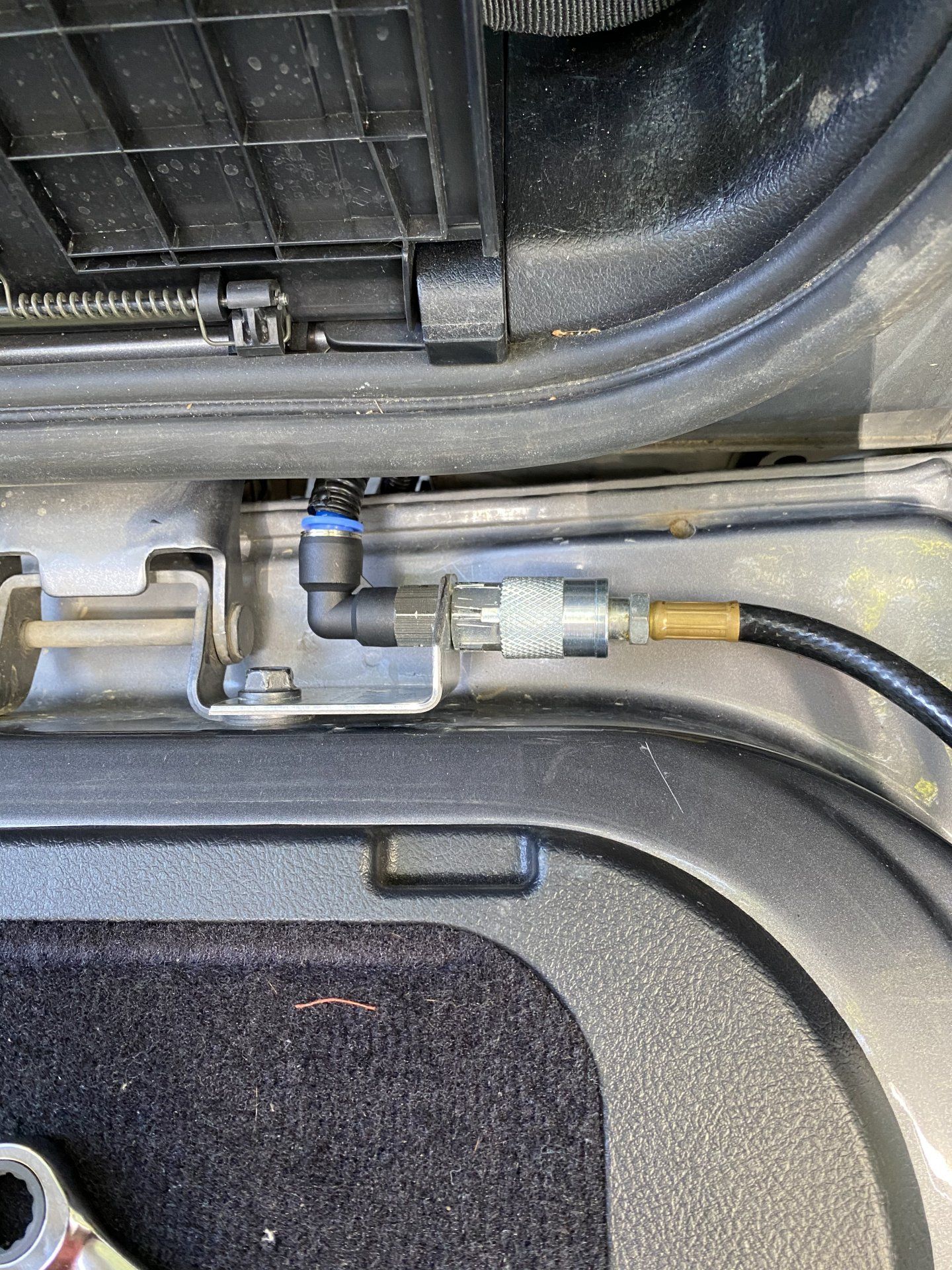

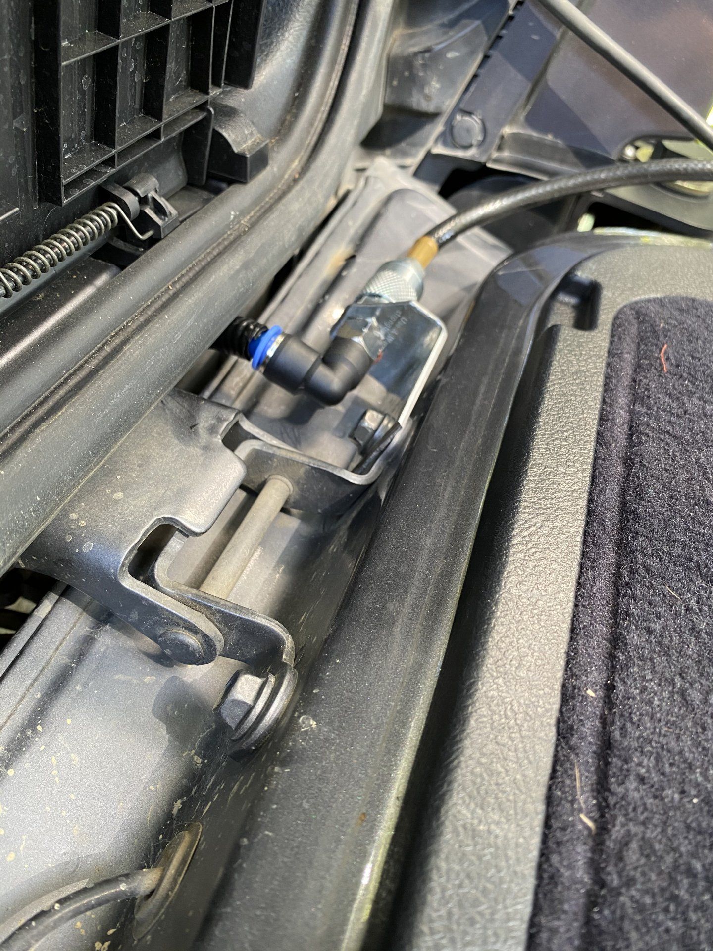

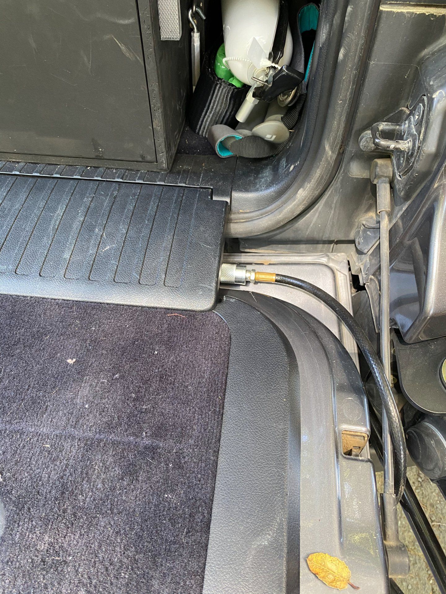

Ha. Yeah, that was an immediate realization. My first test run of the setup was topping off the spare. I had hose in hand and just about set it down to go to the cab.
I also realized that I can check the battery charge anywhere around camp.

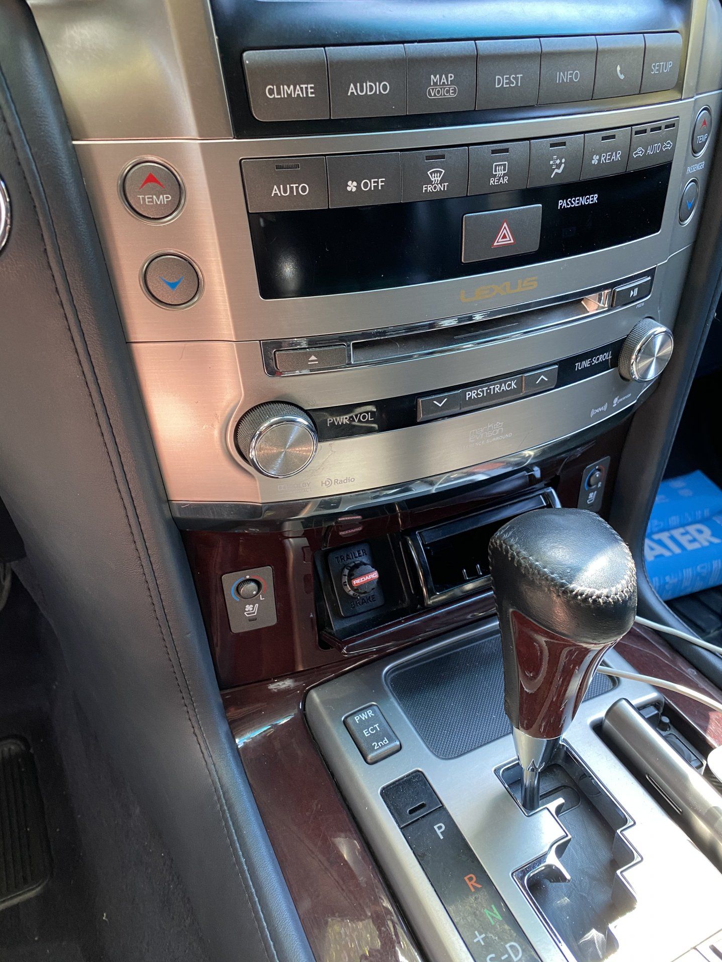

Alright. Another project wrapped up.
I ordered a Redarc Tow Pro Elite awhile back and finally got around to installing it. At first I thought about taking it into a local shop, but I decided to repurpose the 12v socket in the ashtray compartment. My hand is commonly resting on the shift lever in case I need to downshift so it seemed like a natural location. I also like that it is hidden when I don't need it. Also little chance of accidentally hitting it there.

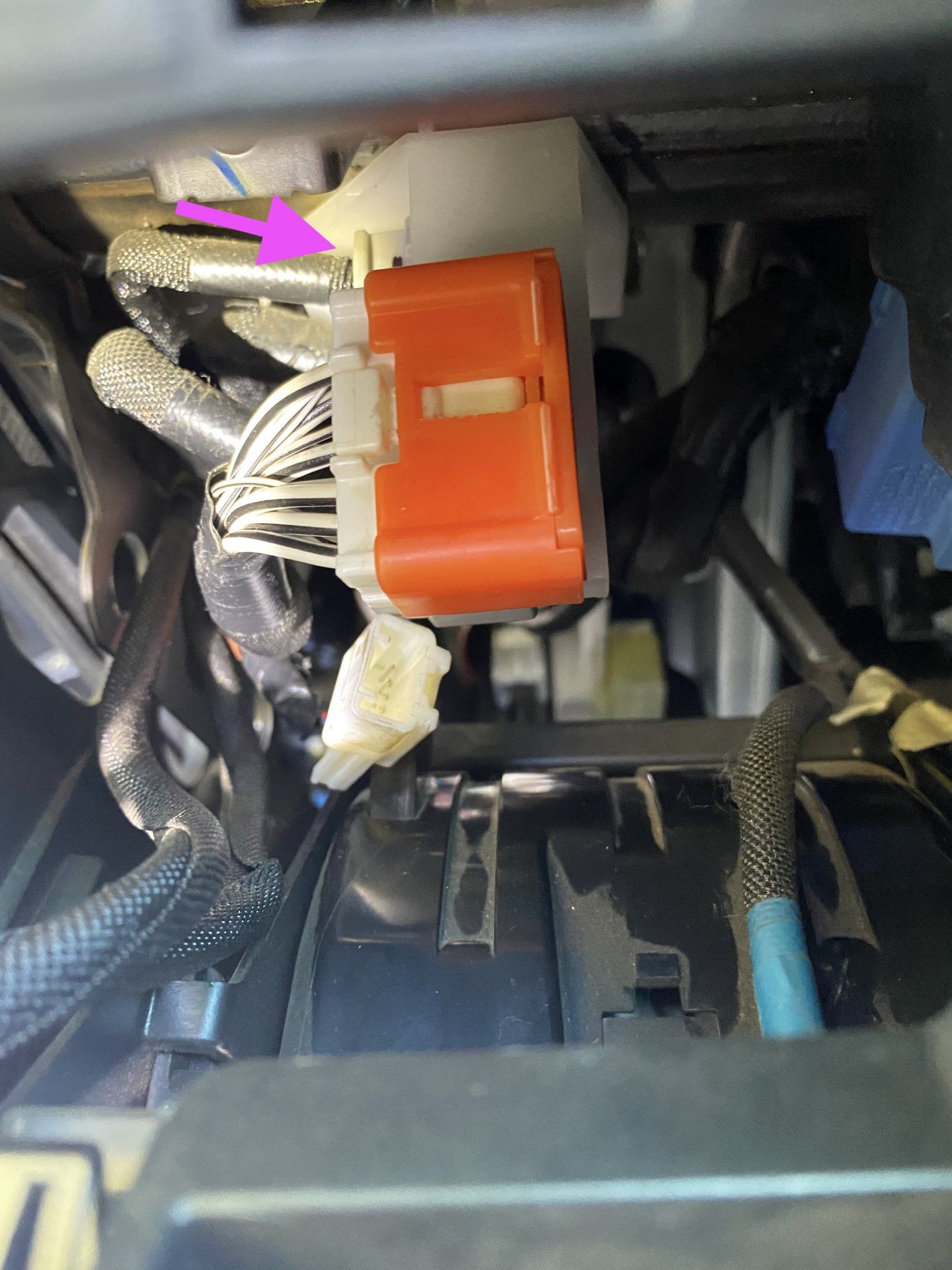

The installation was easy except for locating the harness under the dash. For anybody that has difficulty finding it, on mine it was plugged into a dummy block directly behind the change drawer below the sideview mirror controls. It is below and behind the orange block in this pic:
