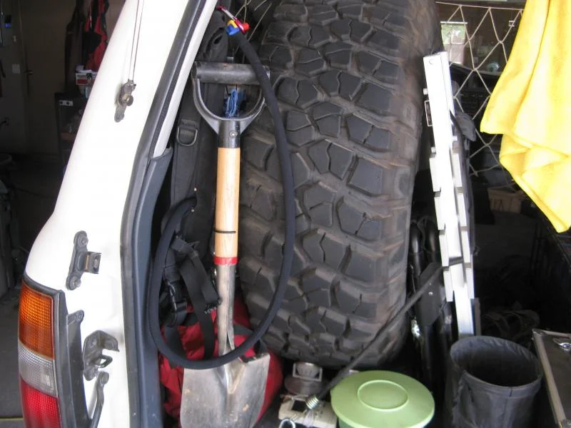

Design goals – Simple, convinces, and dual purpose.
I start each trip with ~7 gals
4gal – Swiss water bag
.75gal – Camelbak
1gal in the rack
1gal in the fridge
.25gal driver seat
Swiss water bag (tap water) is used for in the event of a cooling failure, shower (1.5gal needed), dog water, and general clean up. Could double to haul fuel in an emergency.
Camelbak (RO water) is used for hand and face washing, jetboil cooking, teeth brushing, quick drink for the dog, and also portable for hiking or MTB riding.
1gal out and 1 gal in fridge of RO water for drinking and back up for the Camelbak

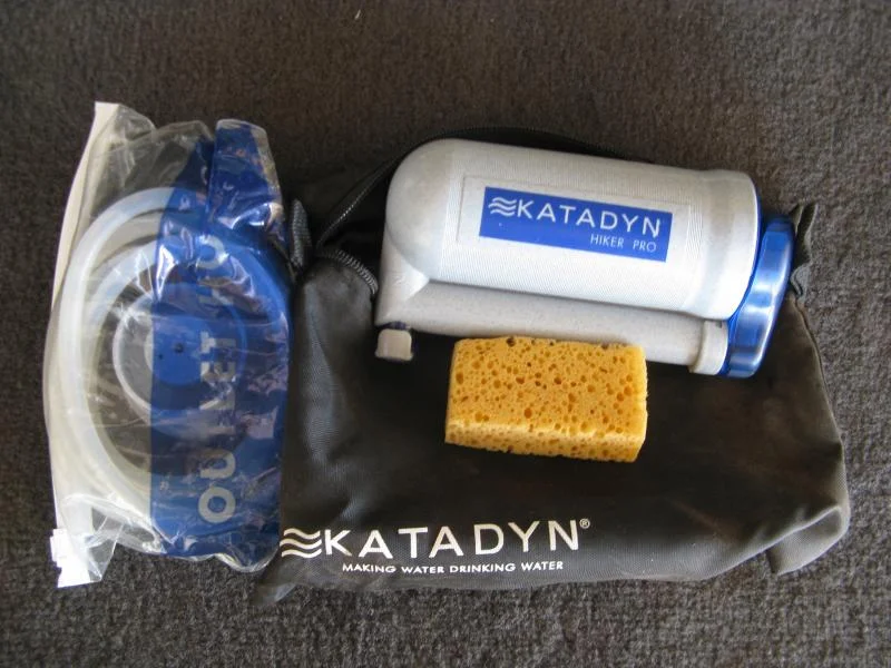

To keep everything filled during extended travel I carry a Katadyn water filter if RO water is not available.
I choose not to put all my water in one location for convinces, usability, and backup. If one location fails Im not without water.
Fabbed a mount using the seat belt bolt to hang the Camelbak. I cut a hole in the side of the Camelbak for better flow and to lengthen the hose to extend over the tailgate. Added an optional tip for better water stream
As I refill my personal water bottle I replace it with warm rack water. At quick glance I know where my drinkable level stands.
The swiss 20L water bag is super tough. A 200lb man can stand on top without failure. I store it under the dogs platform in the floor keeping the center of gravity low and very accessible. In the past I have used the bag to put out a vehicle fire. It’s portability makes filling the shower bag easy.
This system makes living out of my 80 very convenient and trouble free. Now just need to get more free time.
