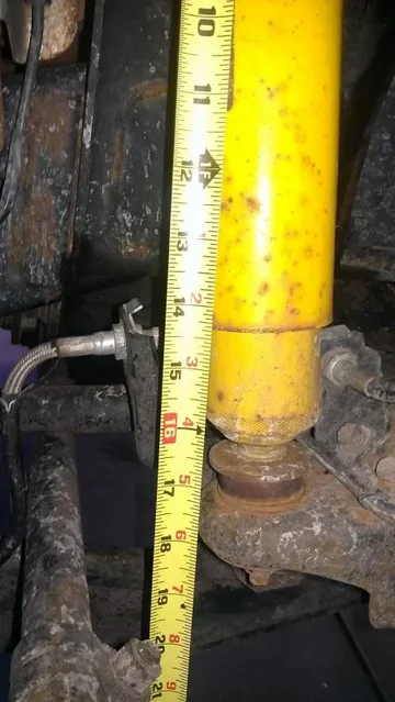

Not sure if this info has been supplied elsewhere, but I was adding a spacer to my 850s the other day so I thought I would check this out. I took the spring out, disconnected the top of the shock and compressed the non-L shock completely taking it out of play. Then I lifted the truck up completely until the bump stop was compressed and the entire front weight of the truck was on the bump stop. My measure from the underside of the shock tower to the top of the lower shock perch was nearly 17.5".
So, from this measure, even taking into consideration the bump stop would compress even more dynamically hitting a hole, it would be hard to over compress even the L shock at 15".
Am I miscalculating this? Does anyone have a real world example of over compressing an L shock on the front?
