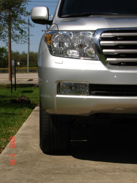

Ok, if all goes well, here are my after pics. Yes, there is lots of space in fender wells but I like the look for now. Towed 1/4 load camp trailer earlier this morning and it had not impact!:clap:
