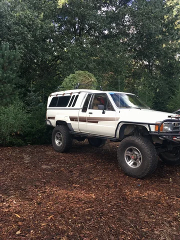

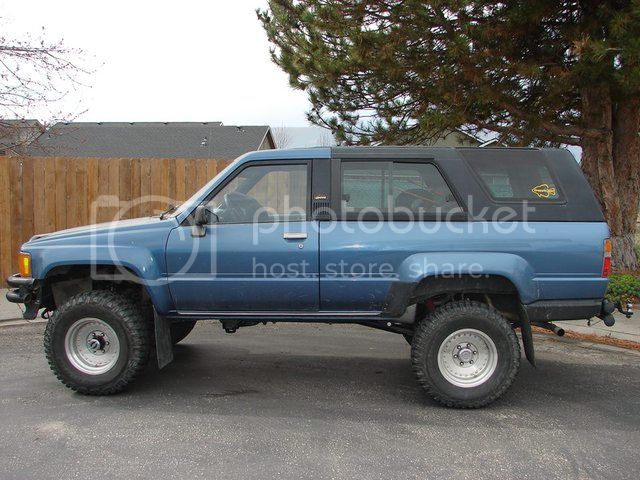

I had a hard time explaining this concept to people, so I took these photos to help show the frame difference between ifs and solid axle trucks.
Front is measured from the bottom of the radiator support, Rear is measured through the body mount, to the bottom of the floor. The measurements are not correct, due to variations in the camera angle, but they give you a rough idea.
My very bad measuring skills shows the 86-95 frame to be 1.5" lower at the front cross-member, and between 7/8 to 1" lower at the shackle.
My '86 mini has 1.5" lift YJ Wrangler SOA Springs on the front, and I ended up about 3" lower than a Trail Gear solid axle converted truck with 3" Springs.
