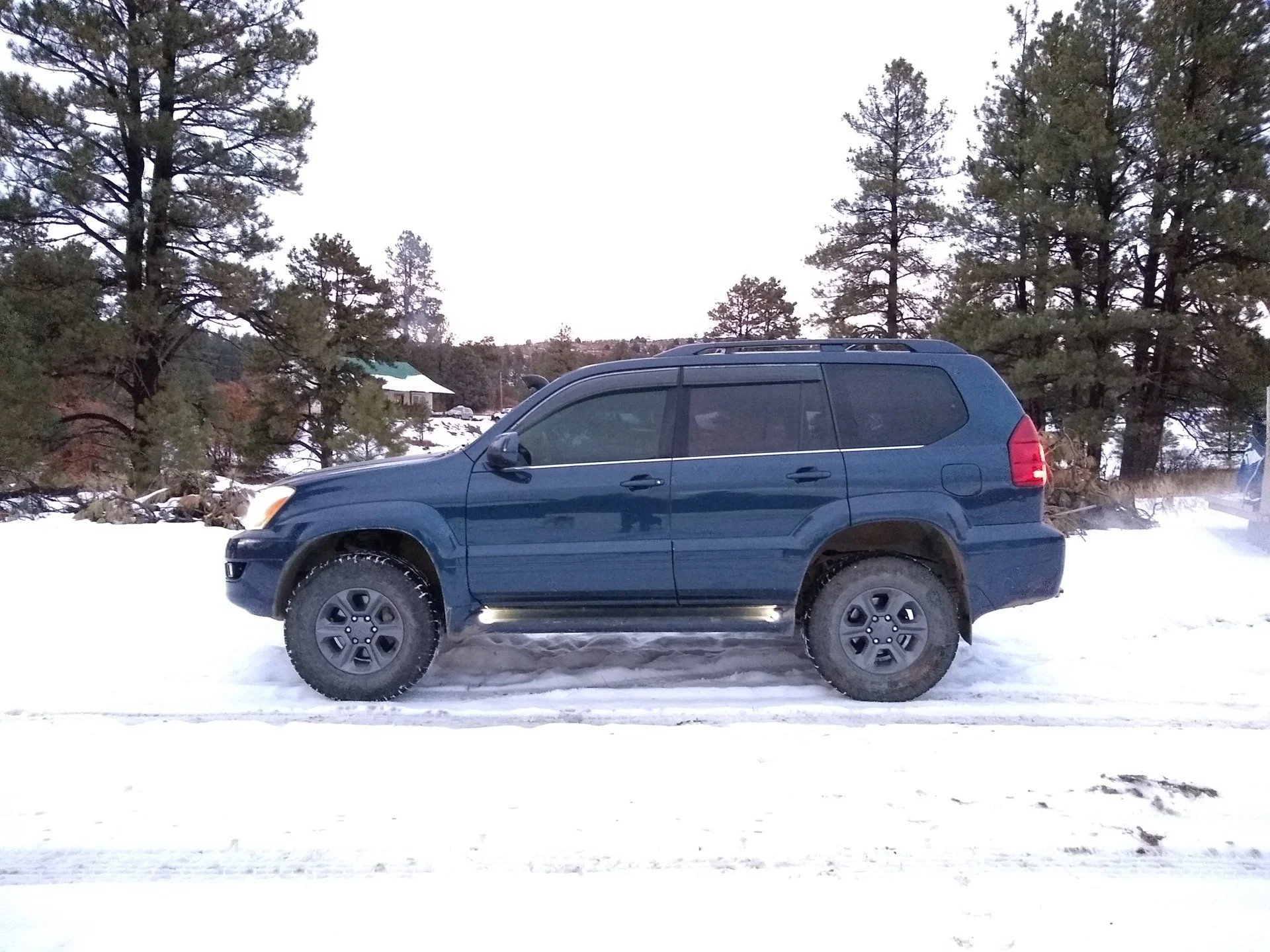

I'd like to keep a similar rake to what I have now. Currently running 285/70/17 using the Toytec 2" rear springs and OME 2884 coils on Bilstein 5100 shocks. I recently took advantage of the Coastal off-road sale and will be hopefully soon running a front bumper with winch. Also in the process of building some sliders. Would y'all recommend going with the 2885 or 2886 front spring? I'd like to keep a rake to the vehicle so the front end isn't up in the air when I'm towing something or loaded for camping etc.
Looking at your side pic and wondering if a winch and bumper might drop that front end just a tad and give me what I'm looking for....
