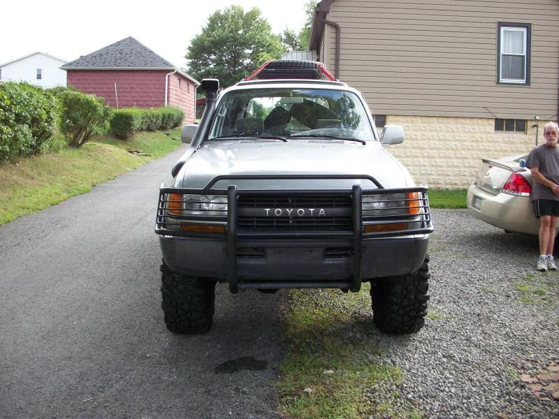

ome 3" lift and 35" bfg km2's. before and after shots, with wheeling pics snuck in.

the before, photo 1

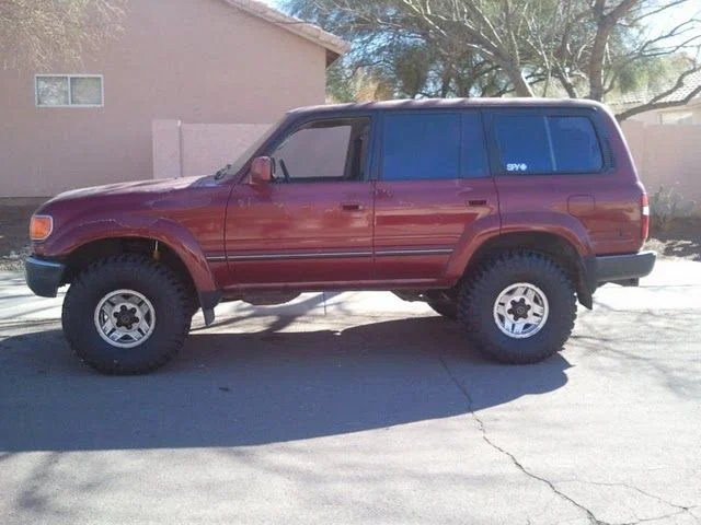

after photo 2

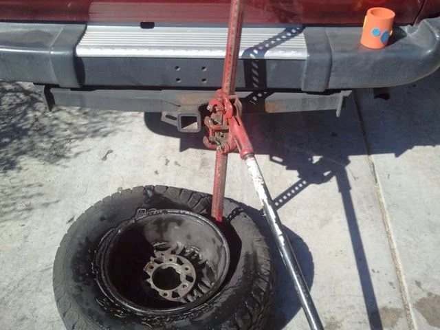

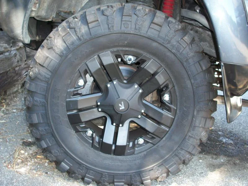

my mounting technique photo 3

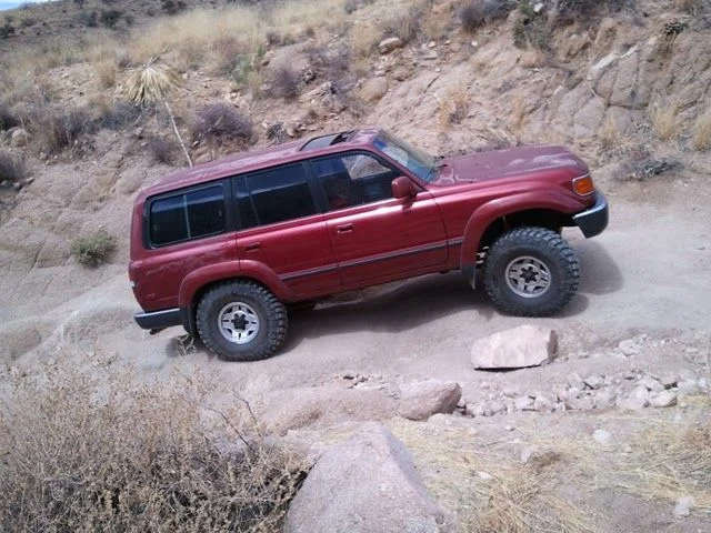

wheeling pics from charouleau gap. which i can never spell right.
for non-az folks, this is one of the "baby" trails in southern az. one of the places i first cut my teeth in the world of rock crawling.
and i haven't wheeled a non-buggy in a long time. i have to say i really missed it. having to actually pay attention to where i was putting my tires had become a bit of a lost art. :)

the high lift was the trick. and there was no way i was paying a tire shop a $100 to do it.:D
but it wasn't so bad, these km2s are like butter. load range c and 15" wheel. they almost "popped" on by themselves.
this makes me fear that they will wear out in a year though.
but man, do they ever hook up on the rocks. even wet they grab better than the maxxis creepies i have on my buggy.
I like the look. Are you planning to regear?
Nice rig, way to go.
^ Exactly! I have the OME kit but 35" KM2s are next on the list! How much power did you lose with the tire size increase? 5%? 10%?
well, here is the deal with the regear...
i have no idea what is actually in it. because on the 31's that came with it the speedo was close to 10mph off. and that was that i was "actually" doing ten less than what the speedo told me. so now with 35's it is pretty much right on. so that was weird to me.
as far as power loss goes, it is barely noticable. but what i have noticed is that i have to manually shift the tranny a lot to get it to drive in the right power band. otherwise it feels like a dog off the line.
offroad, i never had power issues. it crawled and climbed like a demon. i was kicking the crap out of the jeeps that were locked and geared and whatnot. it had plenty of low end control. made me realize that all the time i have been a slave to a manual trans for rockcrawling is just dumb. :D auto is waaaaaaayyyy better. so much more control. a lot of the old myths surrounding the "manual is better" are easily dispelled by driving one with a good auto.
so at this point, i see very little reason to regear.
