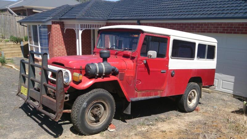

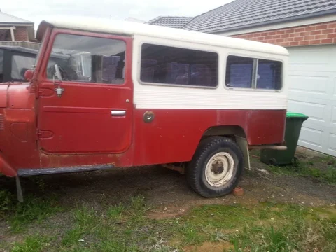

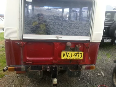

Here are the first of the photos, and the start of a lot of questions
The first question is... What have i actually got??
drop down tail gate, and tie downs along the outside

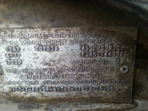

took me 15 minutes of scrubbing the compliance plate to reveal details
now for the pix
still have not even brought her home..
more when she is.
I have my fingers crossed that it is a factory soft top RKJQ
but what i dont understand, is the why year 1963 is above where it is dated 4/77 on the compliance plate
Anyone with ideas.
The tailgate and factory roll bar are good indicators. Not sure about that vin plate? Seating for three? It was the very first year for a troopy so who knows. I actually bid and won a factory 77 soft top on ebay a few years ago, get this, it sold for $455!! It was beat up but still had the bows and canvas top! I ended up shipping the top and bows out here to california! I think the troopy was scrapped? Im pretty sure you have a factory soft top, if the tailgate has original mounting holes, no other troopy had a tailgate. Also look for the bow hardware mounting holes on the inside fender wells. Congrats on a rare rig mate!
Pretty sure its a factory soft top. As others have said the factory roll bar, tailgate and foot man loops for the soft top all match the other soft top troopy's I've seen. The fibreglass top is also the same as I've seen on others and is a period part.
I'd also hazard a guess that the V/T on the compliance plate stands for vinyl top.
I'd say it's a '77 FST, and the 1963 stamping is a misnomer. The footman loops, tailgate, roll bar and that glass top give it away. Seen two others like that - one had the same glass top. Was probs be a 2F/H41 with drums. Plans?

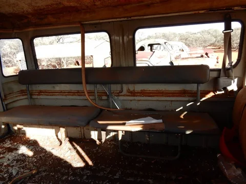

Mine was only ever complianced as a 3 seater but the rear had all the mounts and bolts for seats and seat belts so when I found seats and belts they bolted straight in. I have seen in another soft top troopy that there were no original mounts. Has your's got them?
nice find! I may know of a tatty set of rear seats... they in a h diesel hardtop troopy of your era... and no doubt a long way away from you!
Will double check when I get home but I do recall several threaded holes with nothing attached.
I would require the single seats for under the roll bar and double wide to the back.
would be very interested if seats are available without rest or weld issues.
Thanks

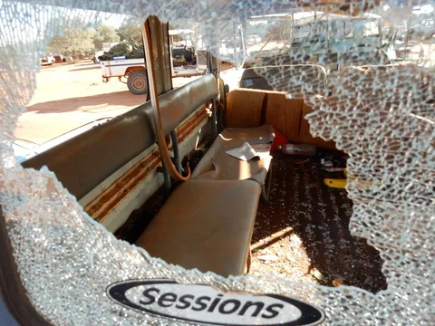

ok heres a pic haha
only got one side there ozefj. mates wreck. seems the locals in my parts just have to smash glass...

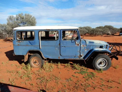

Shame to see that blue troop carrier in such a state. However, sadly,
I think that it's rear jump seat's upholstery is in better nick than all of mine.
Ozefj, will a full length back rest fit in behind the roll bar?
