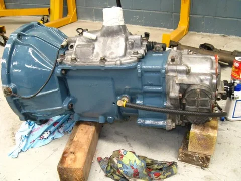

My troopy, "Old Yella", will be getting an H55F with split case in the near future. I've planned this ever since I bought the old steed about a year and a half ago. But a couple of months ago she lost mobility, and has been parked out the front of my house ever since. The inner Hi/Lo range selector lever had become disengaged from the clamp on the outer lever and dropped into the T-case. So this meant it was a perfect time to put in that H55F that I had sitting out the back for ages.
So I've been doing my research (mostly here on MUD), collecting the bits required, and cleaning and repainting the gearbox - yes, it's blue. I wanted something a bit different. Probably shouldn't have bothered painting the bellhousing in hindsight though. I actually quite like the result:
There's just a few queries I have before I get Old Yella towed to the workshop where the swap will be done.

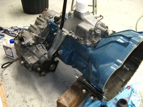

And finally, I want opinions on the state of the input shaft, namely the scoring on the surfaces in these photos:
First off, beautiful!
Why do you have an oil return hose between the tranny and transfer if the seal between them is new?

Firstly I must apologise as I cut that first post short, as I had to run urgently. So to continue from where I was at:
The scoring on the input shaft. Here's another photo, from around where the clutch fork/thrust bearing sits:
slightly worn, do you think it will be ok? Its worse on the underside.

this tranny is not new. Its not even been rebuilt! I figured I'd just clean it up, make it pretty and then put it in. It only looks new thanks to gallons of elbow grease, wire brushes, a ton of kerosene and a tin of POR-15 engine enamel ;). Hopefully it runs ok :hhmm:. So the seal between the tranny and t-case isn't new, and must be busted because the PO had some crappy homemade oil return hose that I replaced with the one you can see on there. Good to know that scoring wont be a major issue!

Matt, that explains why it's got that tube inbetween the two. Damn it looks good man, good work!
Other than hitting the scored section lightly with an emery cloth, I'd call it good. Mine was scored a little bit like that and it's fine.

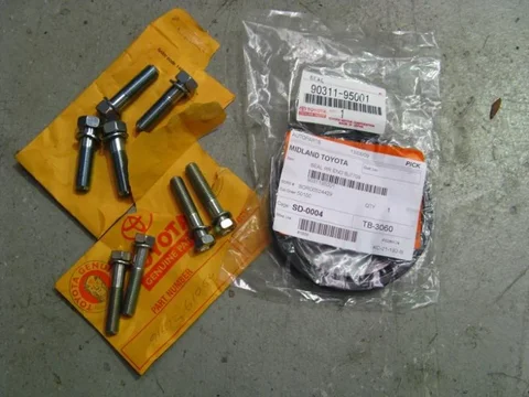

Just picked up new bolts for the bellhousing to block, and a new rear main seal, as I am going to replace that while I'm there. I am pretty sure those small bolts aren't right, plus I only have 8 bolts; there are 10 holes in the flange of the bellhousing .... serves me right for not checking first. Back to the FSM.
Nonetheless, brand new genuine parts are exciting to get!

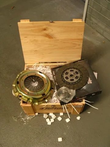

I bought a clutch kit through eBay, a 4terrain kit. Hopefully it will be arriving today. Toyota parts were out of stock for clutch kits, surprisingly. I think it must be due to the large number of aftermarket replacement kits available on the market, from cheap replacements (~$300) through to hard core heavy duty kits (~$650) - whereas a Toyota kit costs about $540.

Anyway, my clutch kit arrived yesterday, purrty:
Came in a sweet box too, that'll come in handy for parts in the future :D
