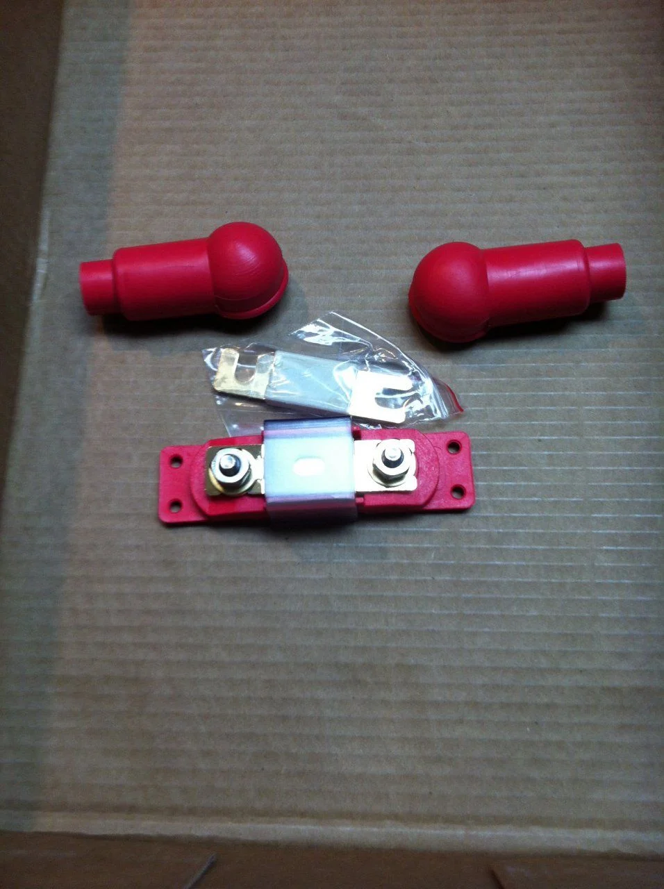

This is the 500 amp fuse I got for the positive lead going from the battery to the winch. While I eas at it I got a spare fuse figuring I wouldnt be able to buy one locally. Now if I can remember where I put it when I need it and dont forget.

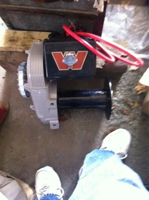

Here is a pic of the finished powder coated winch with albright solenoid and a 6HP motor. I wasnt able to drill for zerk fitting on the dead end of the spool because there are no holes for the plastic plate to mount the zerk fittings will have to silicone the plastic cap on and grease the bushing before i assemble it and mount it on the FJ40 if I every get it back from painting.
