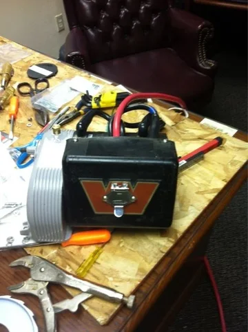

I cut 1/4" off the new female connector that bolts to the plastic cover over the Albright Solenoid. This left the sleeves the wires connect to on the connector just below where the connector was cut. I screwed the wires to the male connector on the female connector bolted to the cover. Then i put heat shrink about an inch long on each wire. I reused the little black plastic sleeve that came with the connector that covers the screws and the connector of the plug. I put on one of the terminal boots i got from summit racing that is used to cover the 2 gauge wire connections. The boot narrows the last 1/8 " so i cut that off so it would fit over the female plug bolted to the cover. Test the fit and the cover now fits over with plenty of wire protection at the plug from the heat shrink, reusing the 1/2 inch diameter plastic sleeve that comes with the connector and the terminal boot. Sorry i didnt get a pic before i put the boot on it wasnt an easy fit and i didnt want to take the boot off to shoot a pic. With the connector bolted to the cover its not easy to get the boot on. Hopefully the description helps the next guy. Here is a pic of the boot over the plug.
Now the cover still has the vintage look even though the solenoid is an albright. I got all the cables from Genuinedeal.com the online order sucks because three of the cables needed are less than 12 inches and online 12 inches is the min. I called them and asked what to do. They told me send them an email right away with the right length. Well the email didnt work. I would call them and order it over the phone and express to them you need the exact length. I got the 12 inchers to work but Im not happy how it turned out as the pic shows and it wasnt worth 27 dollars for new cables. ATTACH=full]1016643[/ATTACH]
