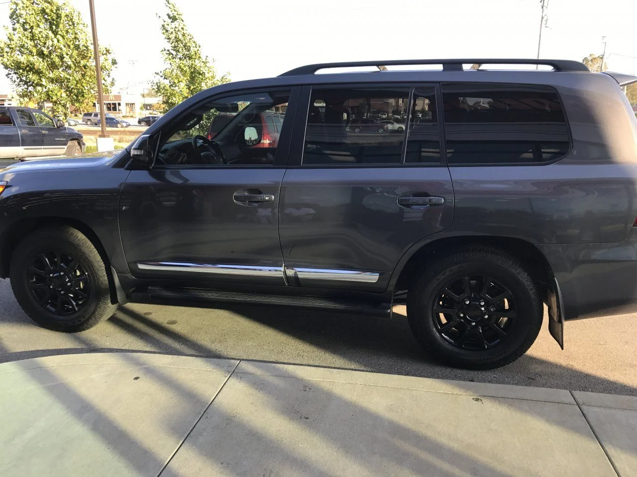

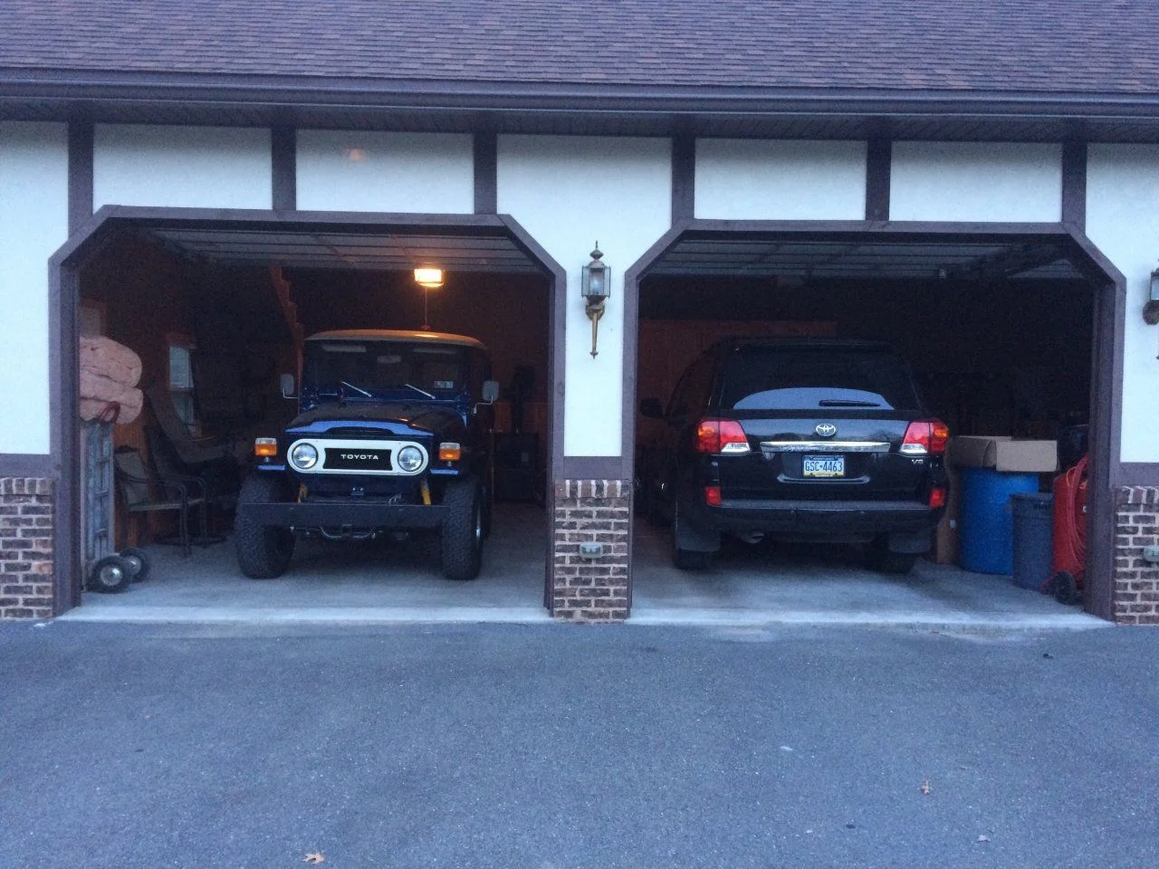

Nice looking garage setup!!! Let me try to shed a bit of light on this for ya! On your stock 18's you can roll 285/65 R18's or 275/70 R18's with little to no rub. You can roll the RW's which have a 50mm offset and 285/70 R18's with no problems. You said you like the Fuel Anza's, that's what I roll right now. They are only available in the 5x150 in an 18 inch wheel so far as I know!?(no 17 inch option) That said if you roll the Fuel Anza's they have a 25mm offset, but only come in a 9 inch wheel(stock & RW's are 8), which is going to increase the odds of rubbing! Your best bet with no lift would be the RW's with 285/70 R17's IMO. If you rolled the Fuel Anza's with no lift and 285/60 R18's it might work, not sure! You would need a 6 pack and a sawsal forsure:)

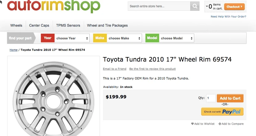

  • Plan A - Buy new. Before they went out of production, dealers were selling them for under $400 at retail but now some dealers are asking close to $600 if they have stock. I have seen some online listings at good prices, but the ones I tried are "stale" prices and not available at posted prices.

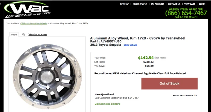

  • Plan B - Refinished rims can be had for under $200 but then you need to pay freight, buy new trim/install bits, etc. so your looking at close to $350 all in.
  • Plan C - Used rums/rings can be had, often at good prices, but then most require some clean-up. You have to keep at it.

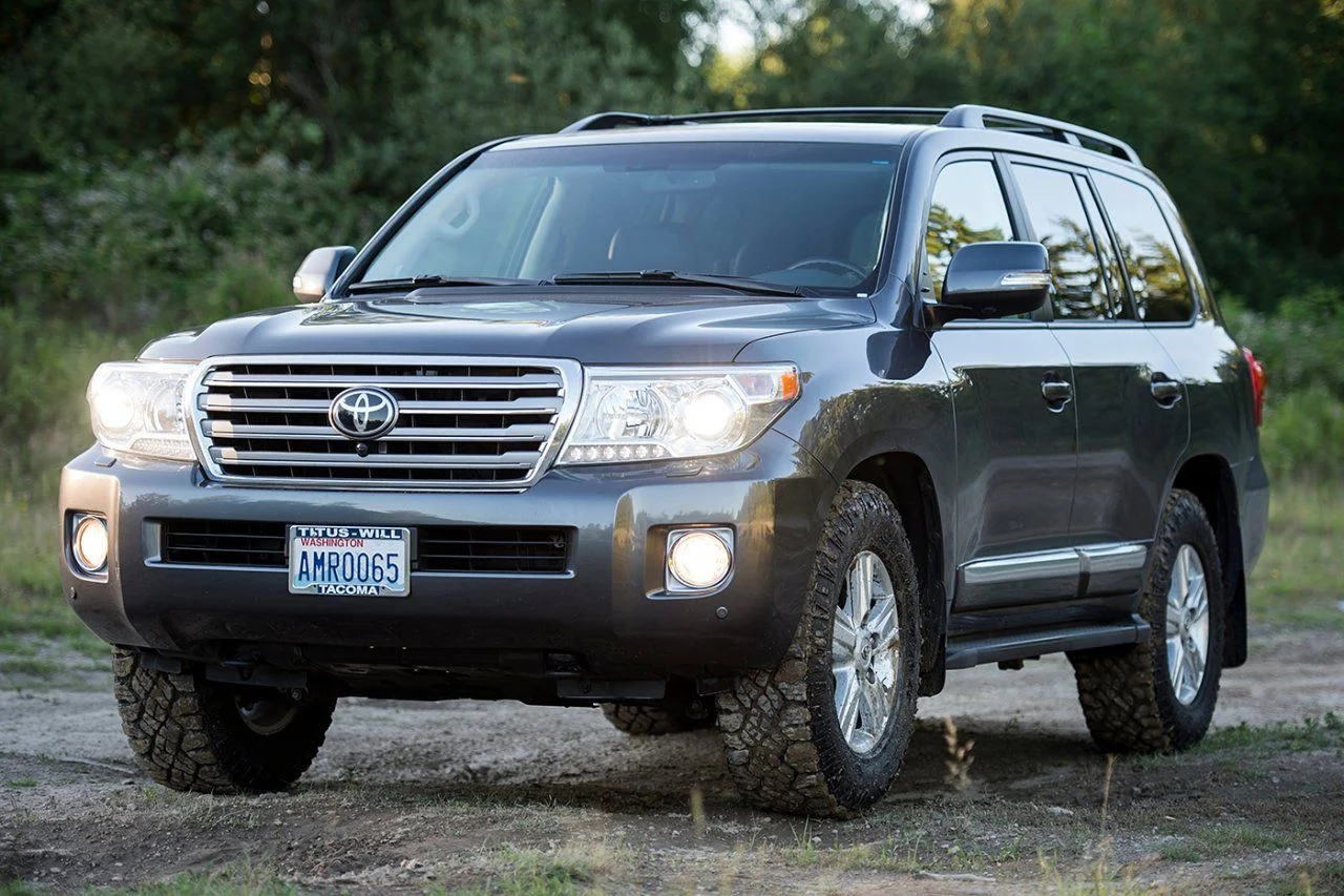

yep, I'm rolling the 285/70 R18 KM2's right now. I've been putting them thru a ton of abuse and really like them! I only added them after my lift and wheels so I don't have any first hand experience on how they would fit with no lift and factory wheels. I know @Hellatoy is running them on his rig with no lift and factory wheels and said he has very little rubbing. Maybe he can give us an update. based on this post below I would say you should be able to run them. Cheers!

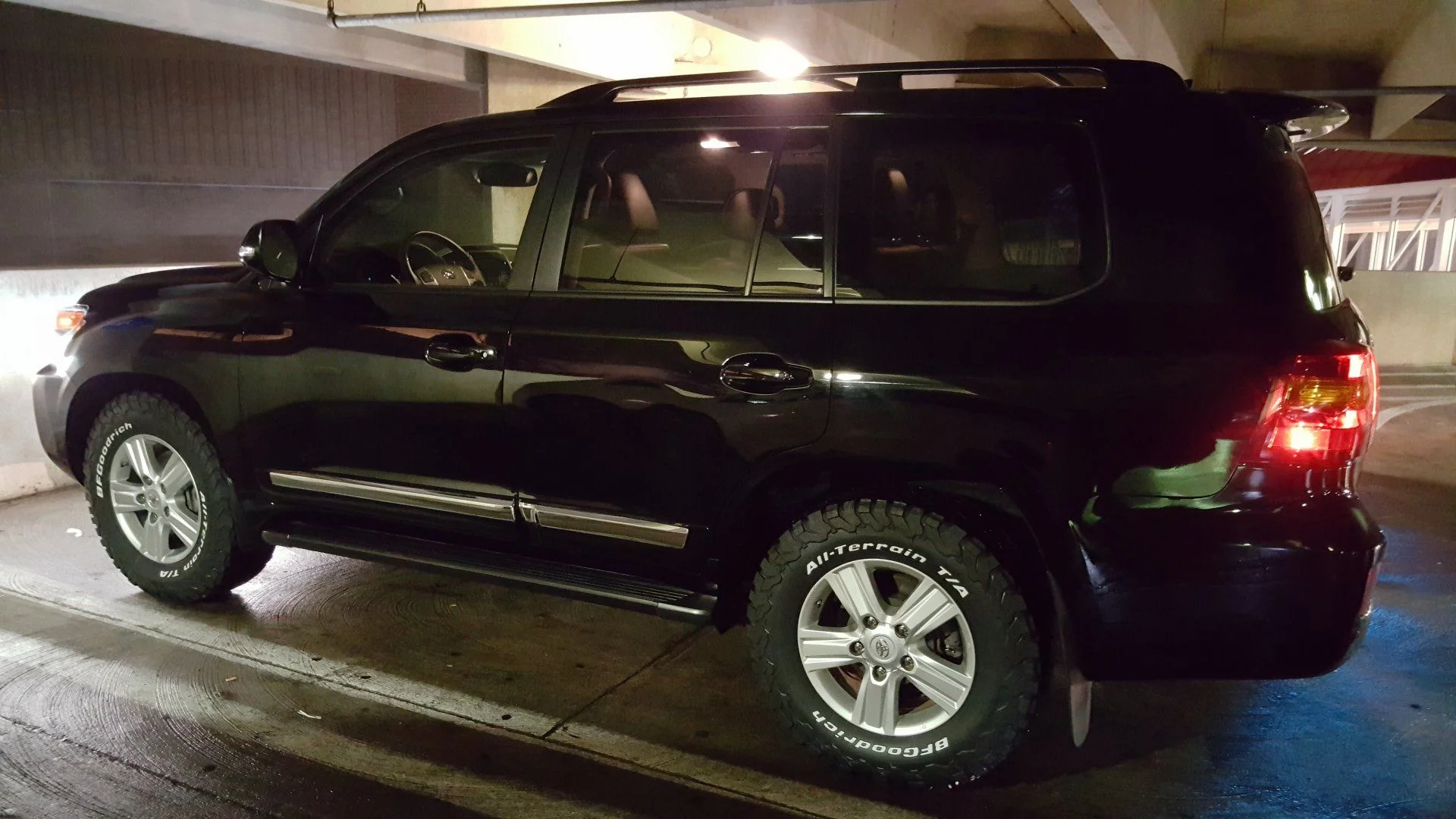

Maybe it is all tires, but my truck rides better on the 17" RW rims than it does with the 18". The 18" rims are running a new set of Michelin tires where the 17" are an old set of Toyo open county....
more side wall more plush ride
