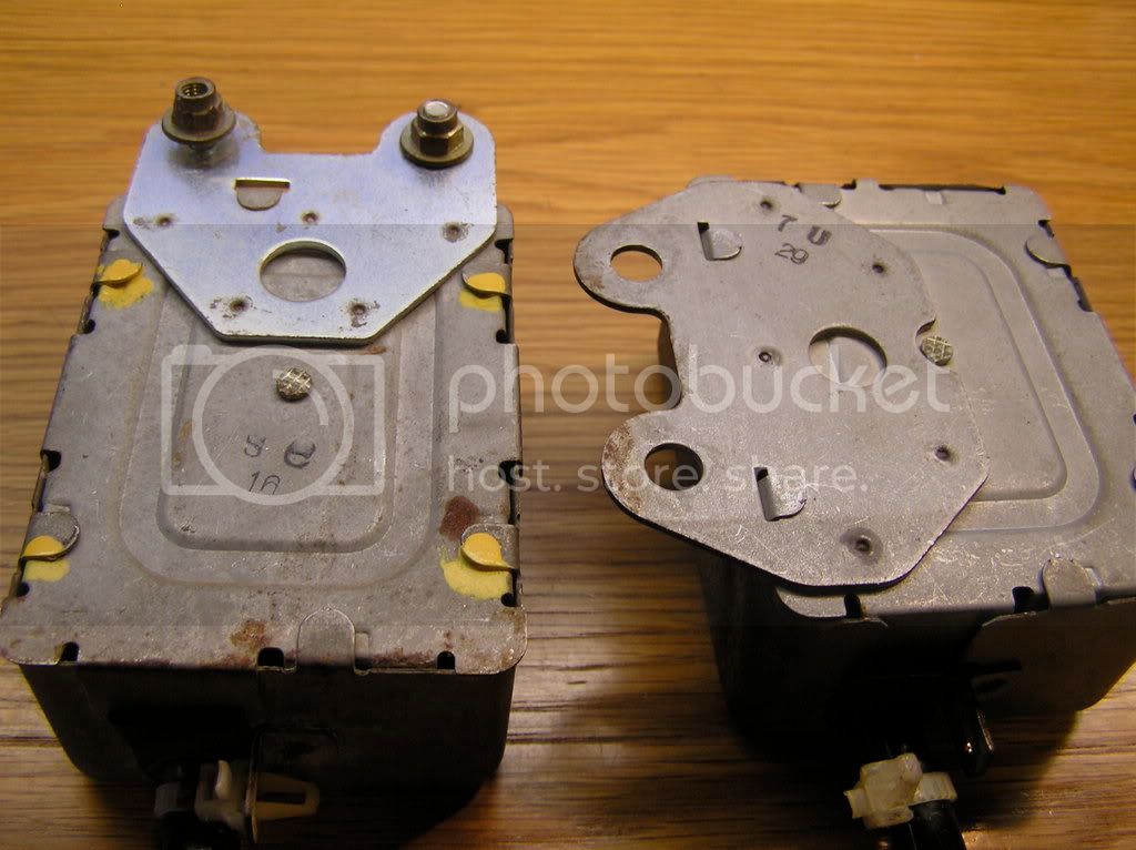

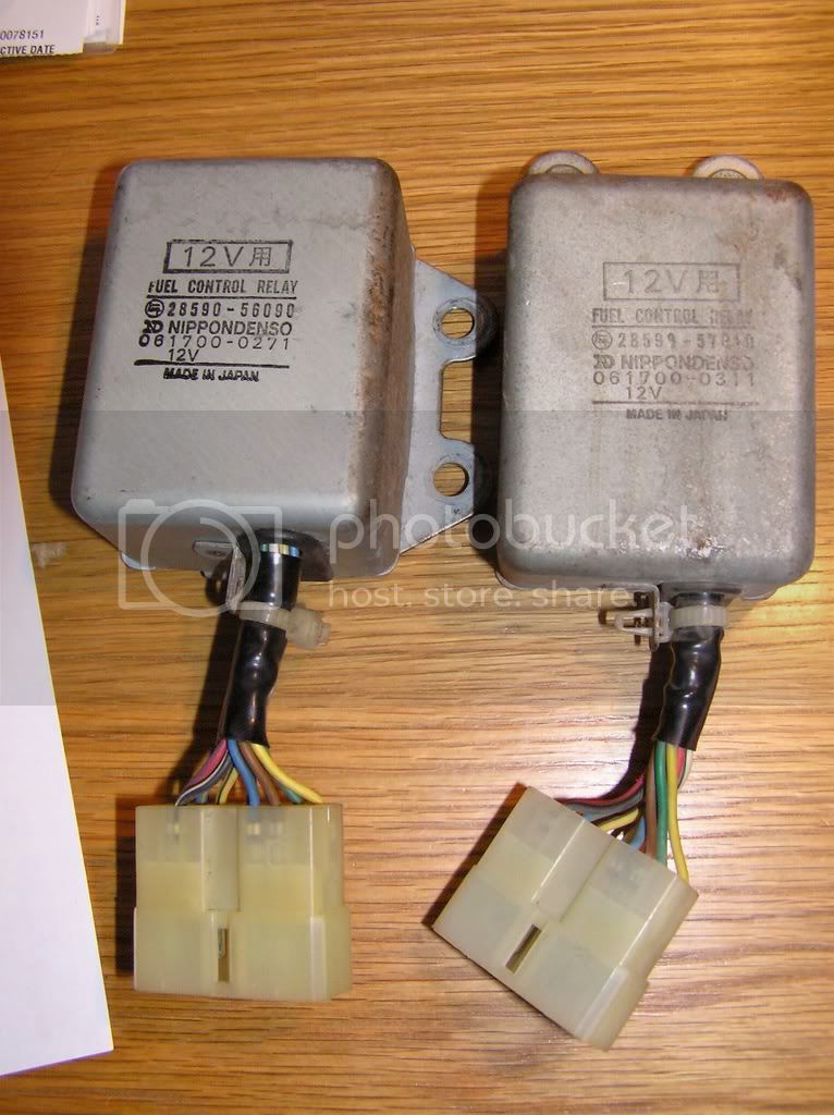

Original relay 8/81 HJ60, Australian, on the LEFT. SOR replacement on the RIGHT.
Original Right, replacement Left.

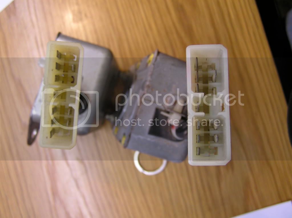

Plugs are identical.

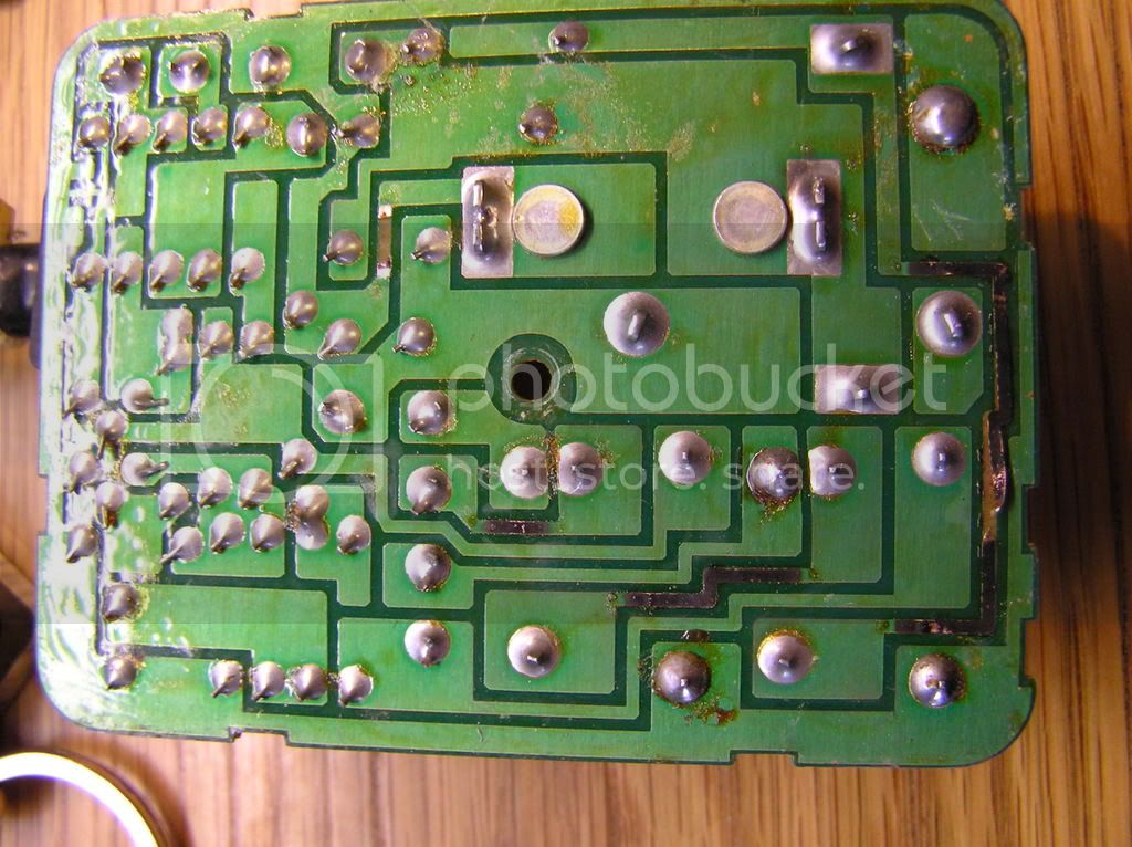

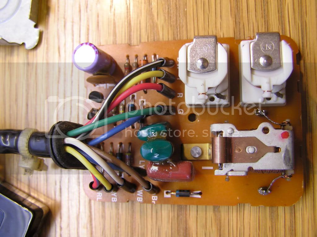

Guts, original.
Guts, original, note fxxxage...
That's interesting.
Looks like someone has altered the Toyota part number on your SOR EDIC relay. I believe it should read 28590-57010.
I wonder why they would do that? :hhmm:
Anyway. The big question is - "Does it work?"

I don't want to pull mine out for photos-- but my EDIC relay was faulty at the relays themselves.
We soldered in new bosch relays, which now hang outside the metal box, and it works just peachy.
Those EDIC circuit boards are pretty simple once you really look at 'em. I'll bet some college student with some EE skills and spare time could make up new EDIC control boxes that are smaller, cheaper, and better .... if they wanted to.
