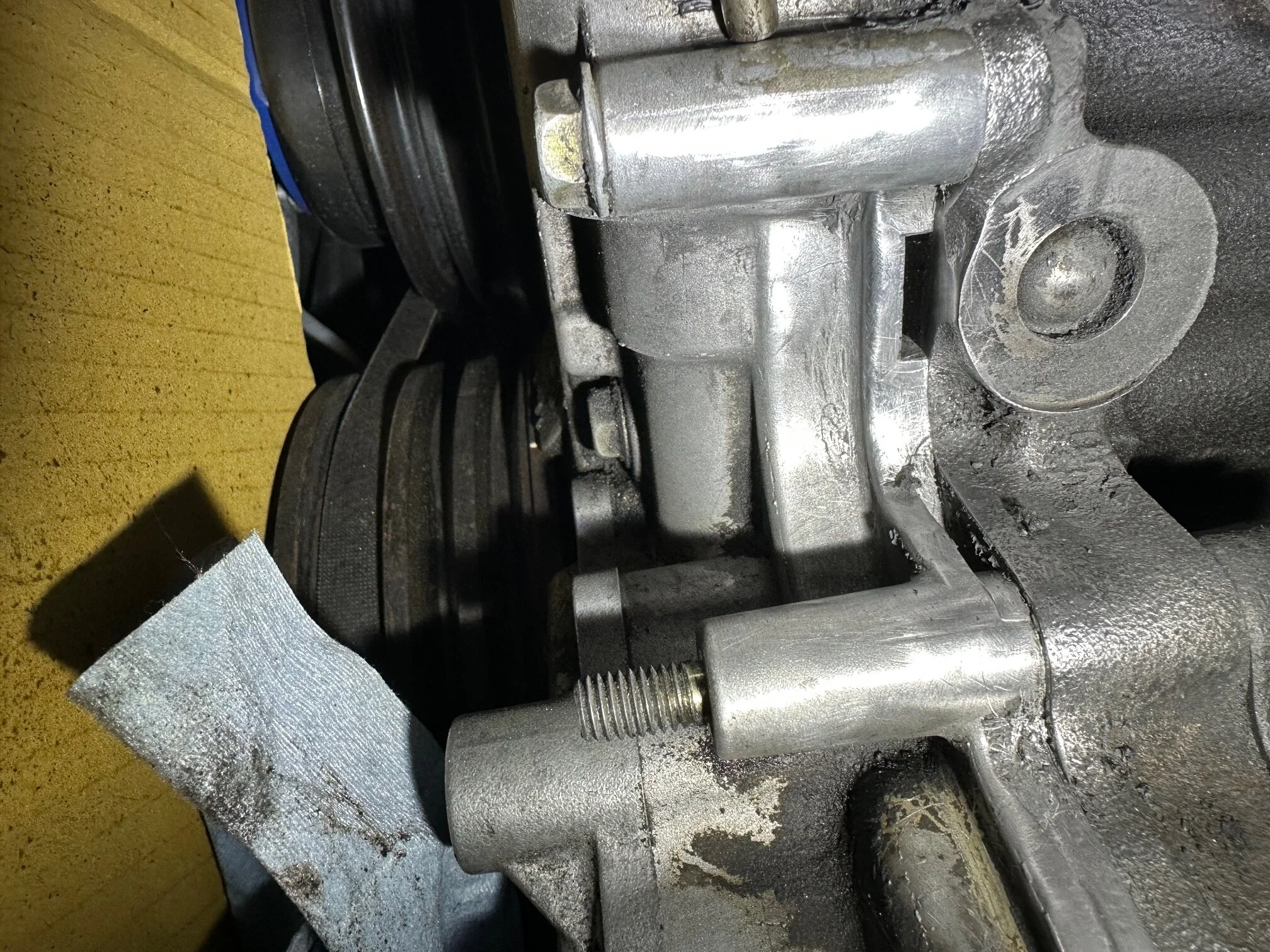

IIRC I used Permatex Ultra Gasket maker and it's still dry in that area after ?? years. Lots of other choices, Toyota FIPG (black), The Right Stuff, Hondabond, Yamabond, everyone has their favorite as long as it's meant for (engine) oil exposure IME.
Key IMO is to clean every bit of oil and grime out of that area until it's squeaky clean so the sealant will stick, just a quick wipe then slathering the sealant over grime won't hold. IIRC I spent well over an hour (probably more) cleaning that one small area ie: degreaser, wash, repeat, then manual cleaning, picks (and even Q-tips), wash, repeat, repeat, repeat. Final cleaning was first with CRC Electronics cleaner (TCE, no Acetone) and just some final swipes with Acetone on paper towels and Q-tips. I did not spray any strong solvent directly into the slot because of the O-ring that's down in there (see photos above); IME strong solvents like Acetone, Toluene, or Xylene (brake cleaner, Throttle Body/Carb cleaners) can damage old rubber components very quickly.

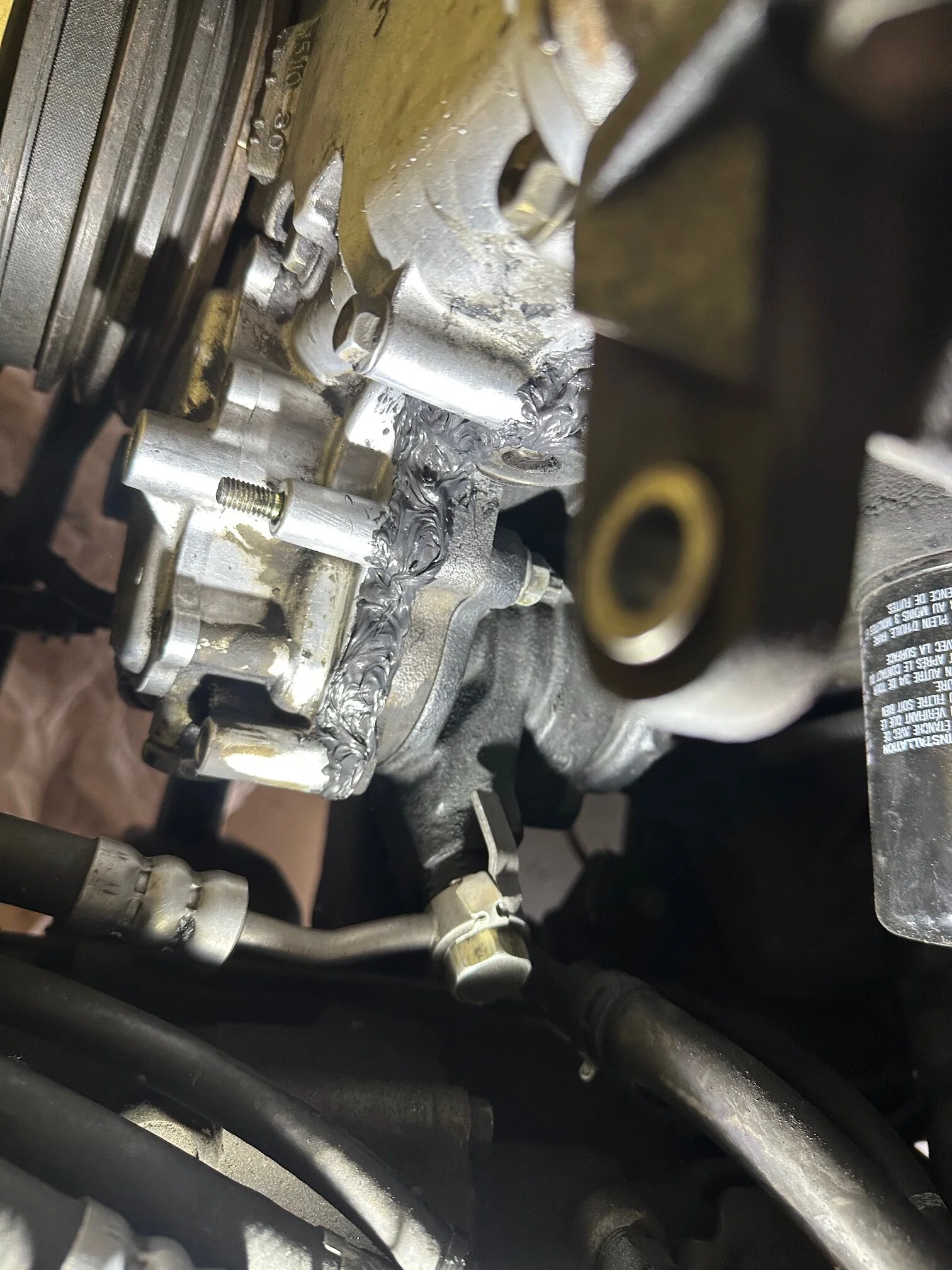

I had pooling ontop of the oil pump and would leak onto the ground... Ended up being a cracked timing cover. So far I've patched half of it, need to pull the water pump to get the other half. Unfortunate, but did stop most of the leaking.
Thanks for the insight on this, gents. I have an 80 series here that appears to be seeping out from the pry point in the timing cover. I've been pulling my hair out trying to get a solid diagnosis on it.
Couple years ago I got a drip of oil seating right on top of the oil pump It look it was coming from the bottom pry slot, so I cleaned and applied FIPG to the whole area the leak stopped by 80 percent for couple months. After reading this thread I decided to remove my alternator and distributor to do a better cleaning and apply some Permatex, I could clearly see that the leak was coming from the vertical pry slot. I cleaned very well and applied a lot of Permatex we will see what happen.
update. I didn't work!! after couple weeks aprox. 500 miles I see the oil coming out again from the same place. its not as much as it used to be, but it is coming out again. Any suggestions how to fix this
If you're absolutely sure that leak is coming from the timing chain cover seam/pry point, you might could try a different sealant. Hondabond for example, after removing the old sealant and super-cleaning the pry-slot, again.
NOTE: IMHO most people probably won't spend enough time cleaning before they apply the sealant. Super squeaky clean down into the slot is the key to getting this cheat method "fix" to work. If it doesn't work even after removing all traces of oil deep into the pry slot, that could mean either the O-ring behind the pry slot is significantly deteriorated and/or the original sealant between the timing chain cover and the block has failed. In that scenario this fix probably won't work.

Thanks! thanks! Thanks!! I did it one more time!!! a month ago, this Time I cleaned very well inside the pry point and I applied the Toyota FIPG right inside the hole, and it is holding very well for now it is dry !!
