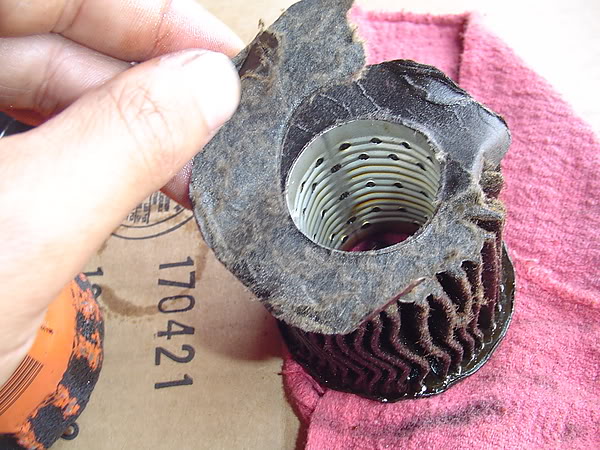

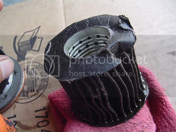

I used a FRAM filter on my 01 dodge cummins. The filter media came apart and clogged a piston oiler destoying the engine:mad: Fram sucks.
many folks have cut apart fram filters to find the filter media is nothing more than a super cheap celluose paper fiber resembling cardboard - and the media is cheaply glued together which can come apart under major engine load and high oil temps. also many of the filter elements in Fram filters are much smaller than the leading filters such as the WIX and Purolator filters.
i'll see if i can dig up some pics.
basically Fram is a NO NO. most of us already know that.
some super shoddy FRAM filter construction:
you can see the end plates of the filter ribbon are super cheap paper construction.
many higher quality filter brands use a metal end plate, and a much stronger filter media.
of all the filters ive seen disected, Purolator Pure One and WIX had the best construction, best anti-drain back valve, and largest quantity of filter media in the filter body.
I believe Purolator's Pure One has the highest quality construction and best filtration
