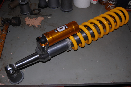

Ohlins Shocks
Sneaky peaky.....
They look well built.

The shocks above are Ohlins latest great TTX. Twin tube (not emulsion though), high speed compression, low speed compression, and rebound adjustable. The last 1.5" of travel has Ohlins PDS Progressive Dampening System. It's basically another small tube and piston inside the main body, no more bottoming out.

Yes, the Tundra has a different shock as it uses the longer A-arms... those allow more travel and will support more lift w/o alignment issues. Otherwise the 200 and Tundra front suspensions are the same beast. Different valving is not an issue, get a stock shock on the dyno for the baseline and go. These shocks can be run soft and bottoming out is not an issue.... these are waaaaaaaaaaaaaaaaay beyond the OME shocks.

Had the fronts on for a short time last year, they work just as good on the LC as they did on the Tundra. As soon as winter is done, front and rear shocks will be mounted back up with their new tweaks. Are you interested in a set?
