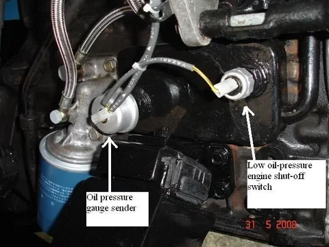

This is what the "oil pressure gauge sender unit" and "oil pressure EDIC switch" look like on my B engine:
They are on my oil cooler but on your engine I believe they screw into your block instead (and should be easy enough for you to identify)

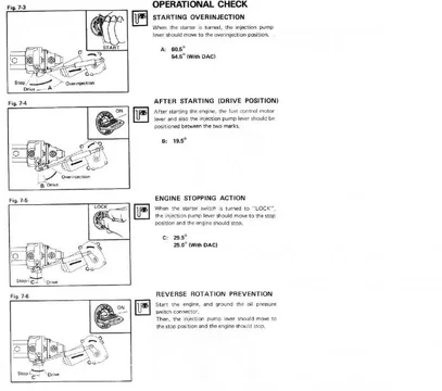

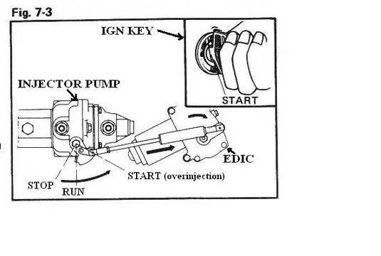

Well this image from my FSM should enable you to check for the correct lever positions:
(I imagine that unclipping the arm should enable you to find all the positions too. Because where the lever rests naturally should be the "run" position, the clockwise limit should be roughly "stop" and the anticlockwise limit should be roughly "start/overinjection".)
Note: Apart from "stopping"and "helping to start" your engine - the EDIC serves no other purpose.)
