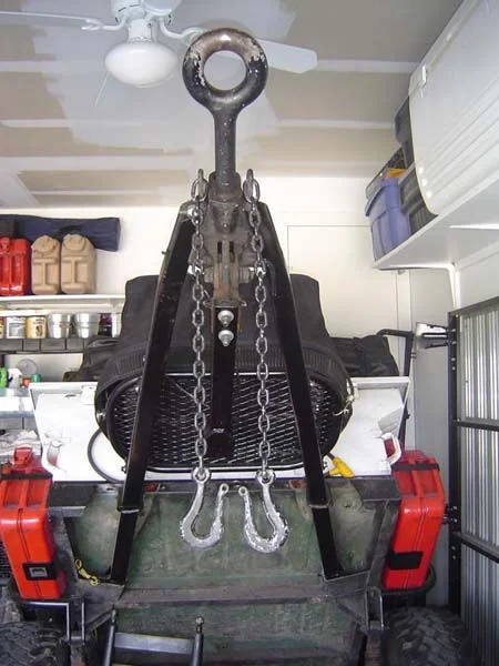

Thought about it, but I don't want to add weight to the tongue, and a huge reason I did the tongue lengthening was so I could jacknife the trailer without hitting the truck. If I moved the cooler basket forward, I'd hit it...I'll figure this out, it's just going to take me some time and I *don't* want to do it more than once.
Below is a picture of the lengthened tongue:
