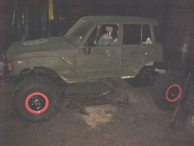

Last one for the nite too dark in the shop........will get some in the daylight tommorrow..........the beast is on all 4 IROK's got to go fab the drag link so it can steer.........:D :D :D
WOW, glad to see it come together. I am interested to see ho wyou finally finish up the rear body panels etc after the roundup.

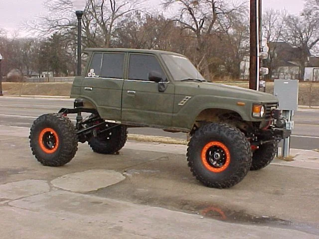

As Kowpoke said we flat out been too busy to even think about takin any pix...........
Yesterday Josh and I had lots of people show up to help, it was like Monster Garage........our maybe more like Overhaulin' cause I ain't near as big an ass as Jesse.......
Since then we have mounted the compressor and tank, wired in the ARB, fabbed and installed all 8 shock mounts, bump stops, fabbed twin sticks on the Rockwell T case......fabbed mounts and plumbed installed the Rock Ram, swapped the stock trans and tcase out for the SM 420/Rockwell.....fabbed up a sick crossmember for it....installed some rear FJ40 bumpstops up front to protect the steering linkage and Pitman arm, fabbed and installed a rear hoop, and 2 down bars at the ass end, the top rear shocks mount into these, shortened the e brake cable and fabbed a bunch of mounts to tie to the Ford cables.......
