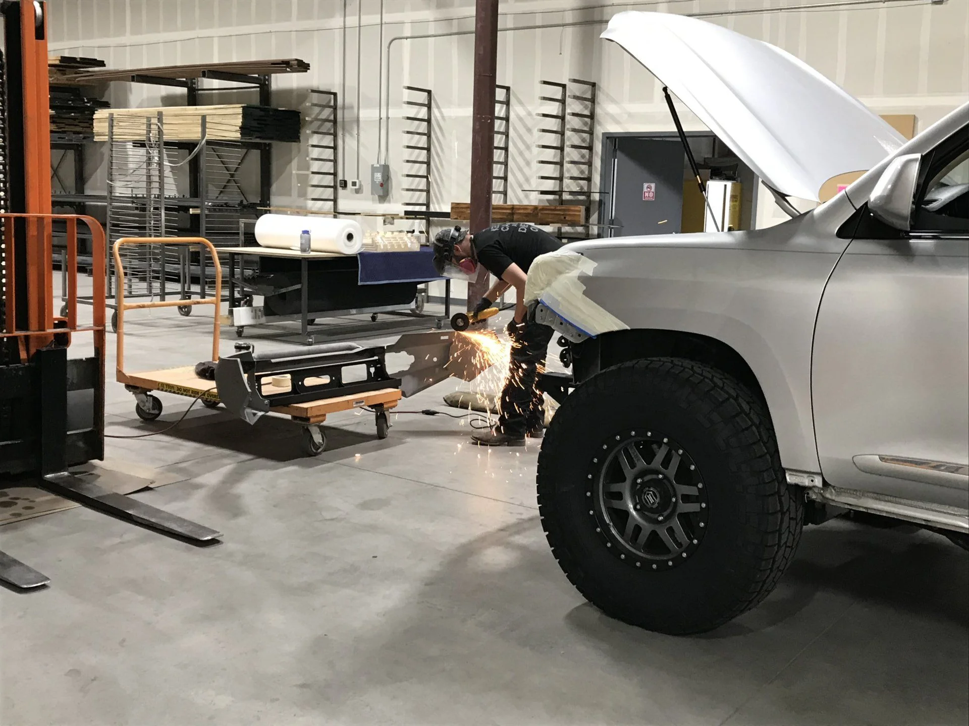

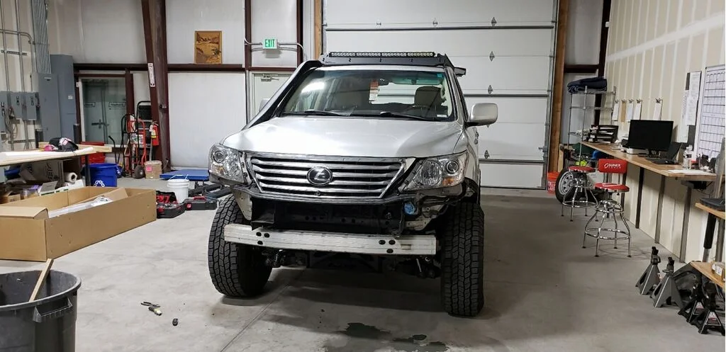

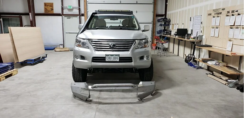

We’re going to be wrenching all day Saturday and likely Sunday, so you should swing by if you want. I’ll text you the location. Lots of changes - bumpers, winches, snorkel, etc are going on!

No it's a very comprehensive change - Tundra front end swap, Tundra bracket lift, body mount chop, and all kinds of stuff going on. It will be unlike any LX in the US without question.

@Ali FJ80 It should be a fun day tomorrow if you want to stop by and see the madness. Sliders, front and rear bumpers, winches and a snorkel. Might take a while lol. @RyanR if your plans change you know you’re welcome too!

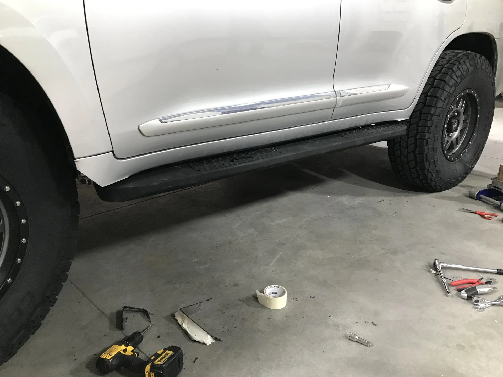

Slee sliders are on and retained the factory LX rocker panels just trimmed up. I couldn’t do work this good, but Greg made it look easy. If you’re skilled with a reciprocating tool and get sliders I’d just cut the rockers like this.
Did you guys have to take off rocker panels to cut, or did you guys do the cutting on car? Any close up pics of where you guys cut?
I left mine on the car to mark where I wanted to cut, then took them off. It's really pretty painless.
