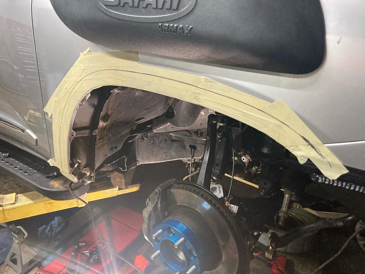

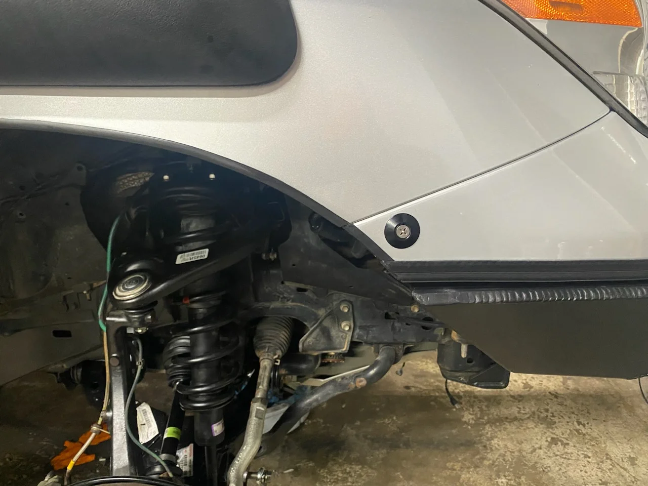

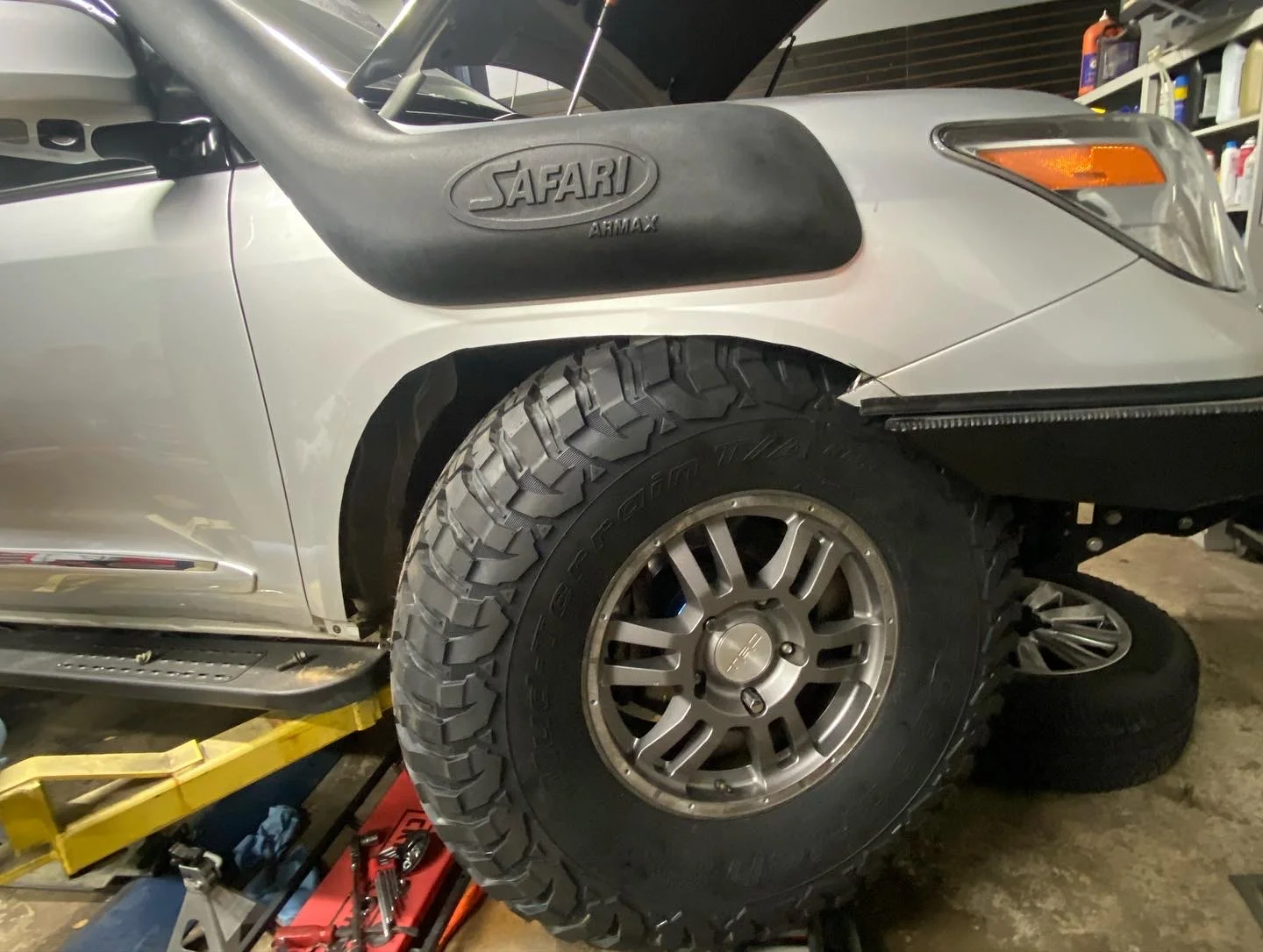

Did you happen to trim your front fenders?
Oh yeah, a ton. The first 2 are the early pics, ended up cutting more before I was done. The Dissent aluminum bumper wings were cut and shortened about 2” as well.

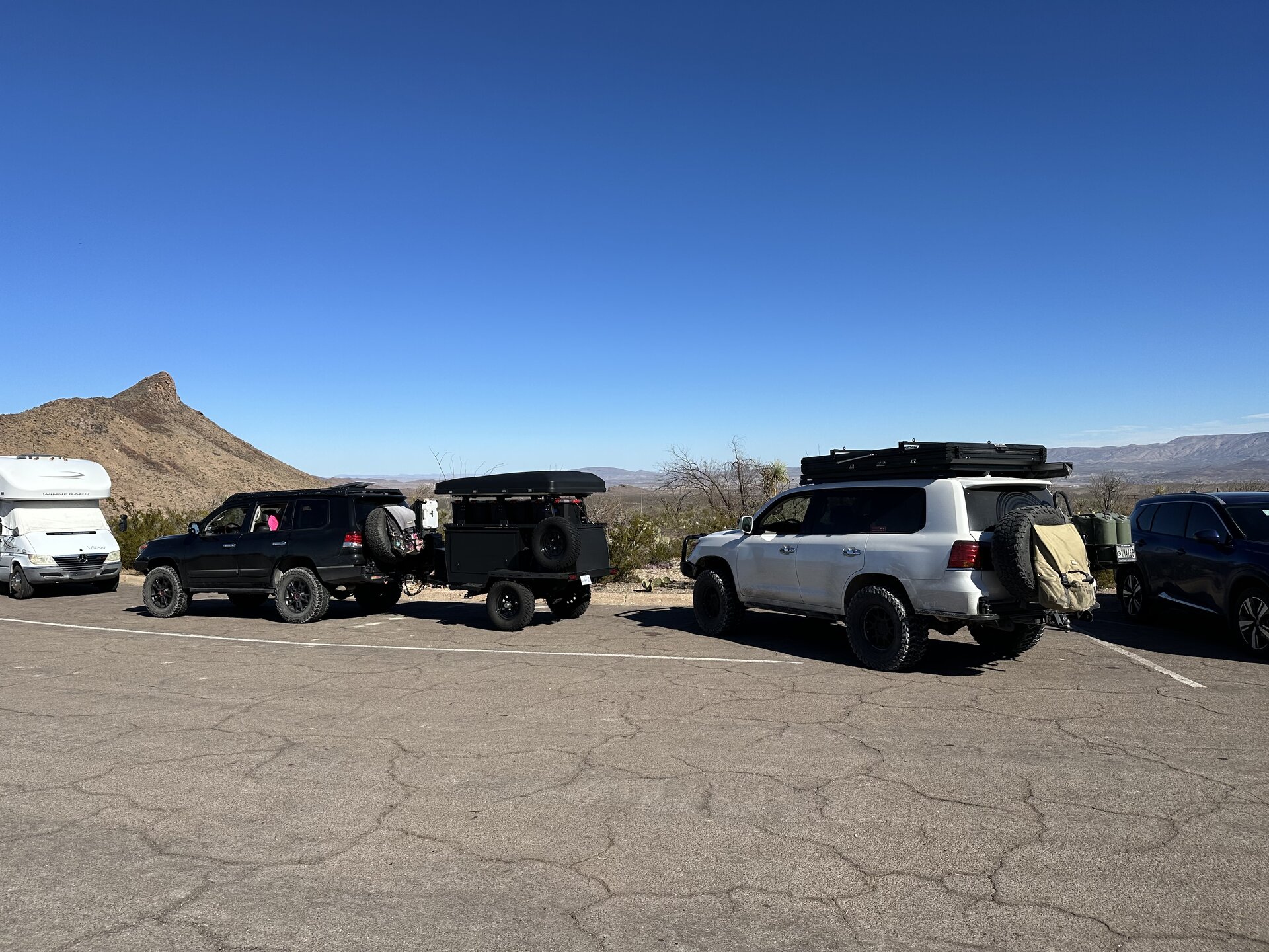

I randomly ran into a fellow mudder at Big Bend National Park!
I had seen the modified truck earlier in the week, but didn’t recognize his rig. On the way home, I decided to stop at the visitor’s center to check all the trailer chains and saw him again!
Conversation went something like,
Me: “hey bro, is that kinda like a Land Cruiser??”
We introduce with our real names and pleasantries.
Me: “are you on mud? I’m Radman”
Him: “yea, I’m ‘x’ “
Both: “holy crap, I know who you are!!” And we bro out until the wives make us stop talking and leave.
I’m not going to name him yet in case he doesn’t want the world to know where he is, but iykyk 😉
Only a couple of the finest built LXs conveniently bumping into each other. 👌

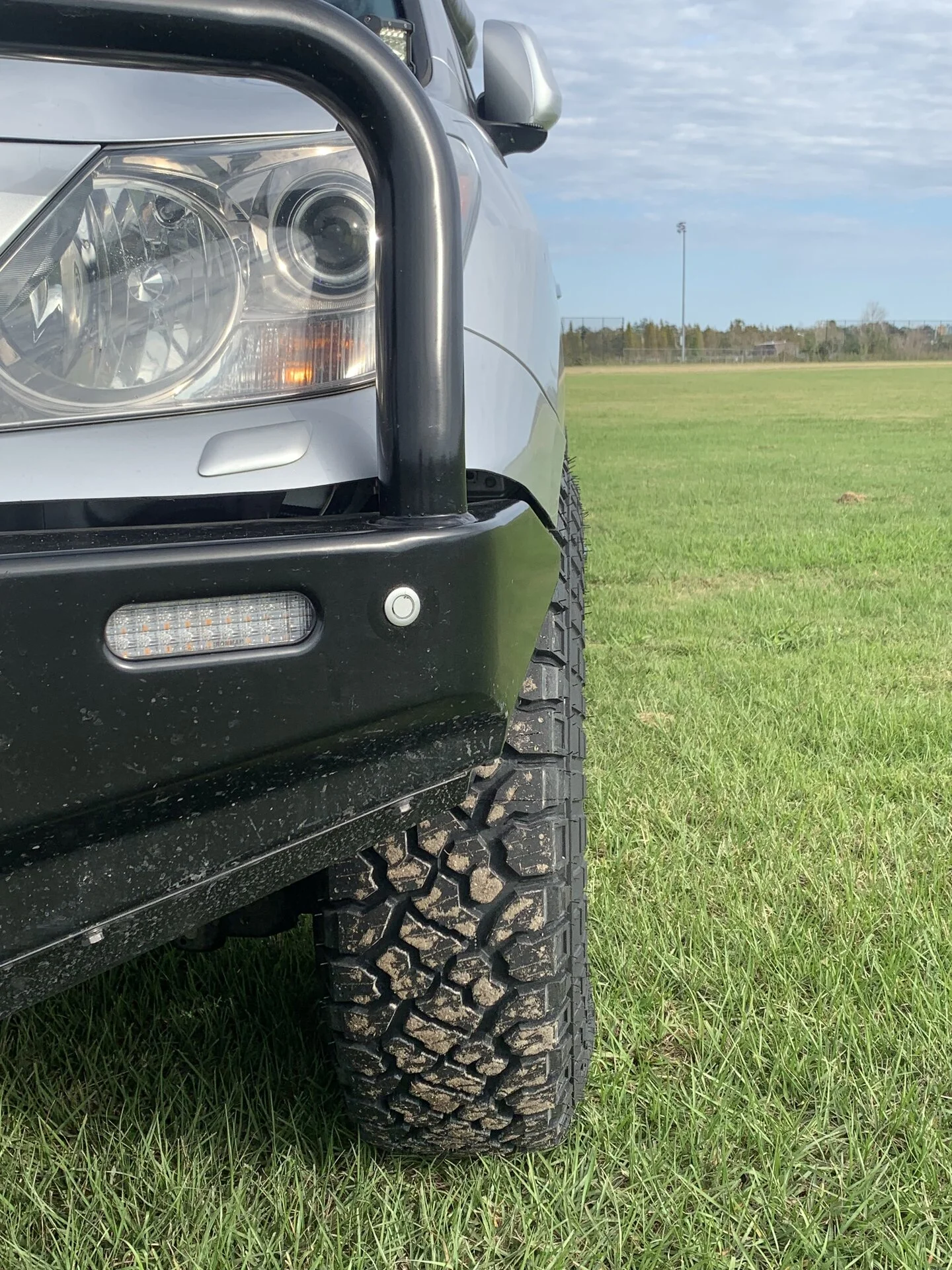

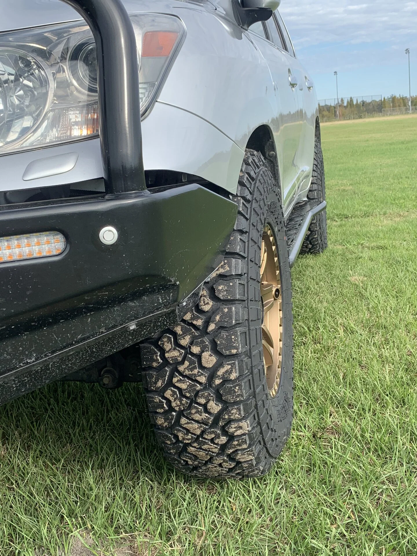

normal height, kenda skinny 35’s on 15 offset

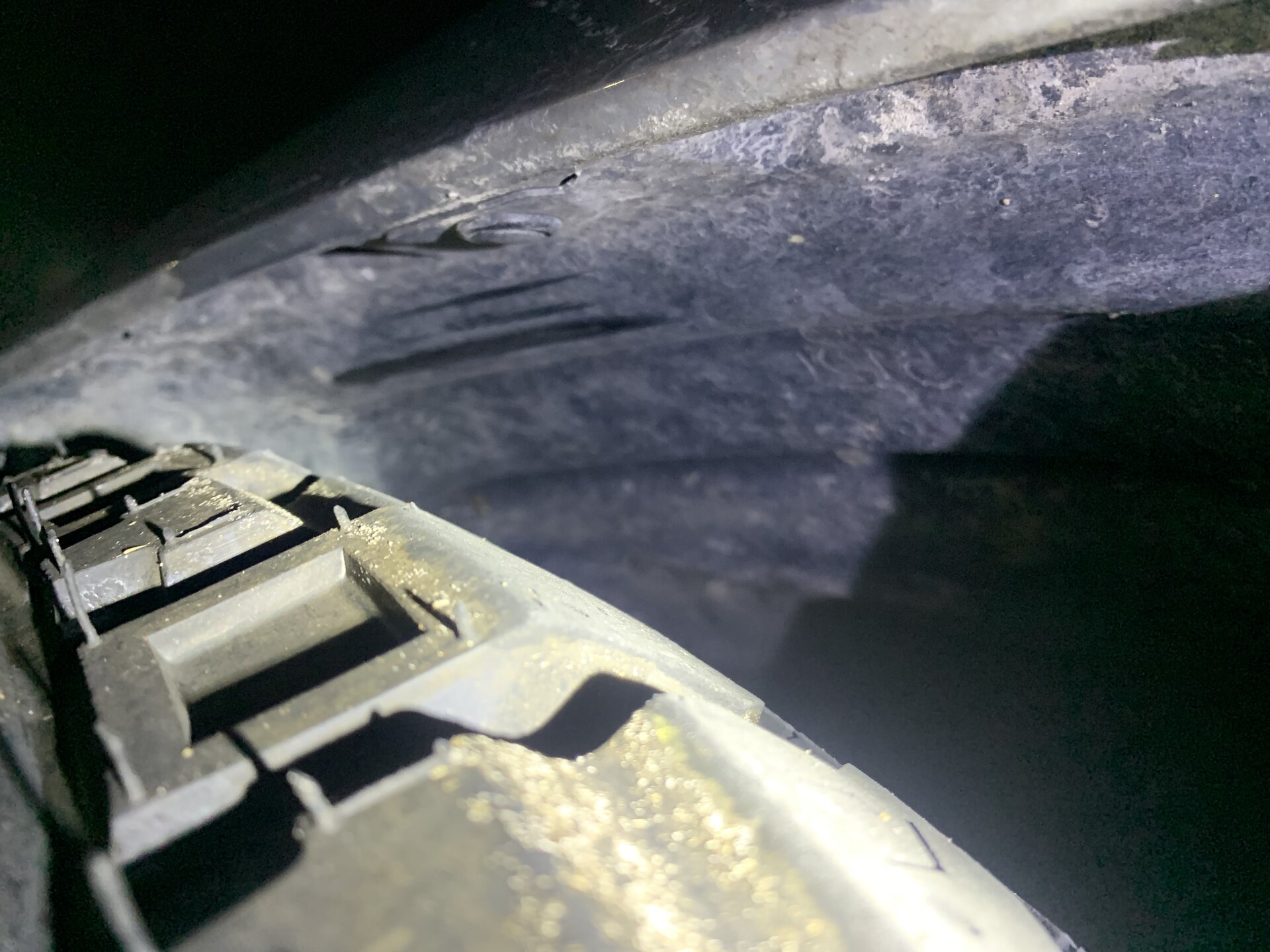

Do you have extended bump stops?
Nope. I need to move my front wheel well liners up a bit as, under full compression (normal height), there appears to be a bit of rub.
The tires stay inside the fenders though so I’m not too worried about it at this time.
There's a super easy 10 minute hack for more upward clearance.
In the top picture where you show the plastic clip and liner. Take the clip out. Stack the liner over instead of under the metal fender tab. With your fingers, you should be able to bend the metal tab up further.
That's it. No need to put the clip back which eats up clearance itself. This should hold the liner up that much higher.

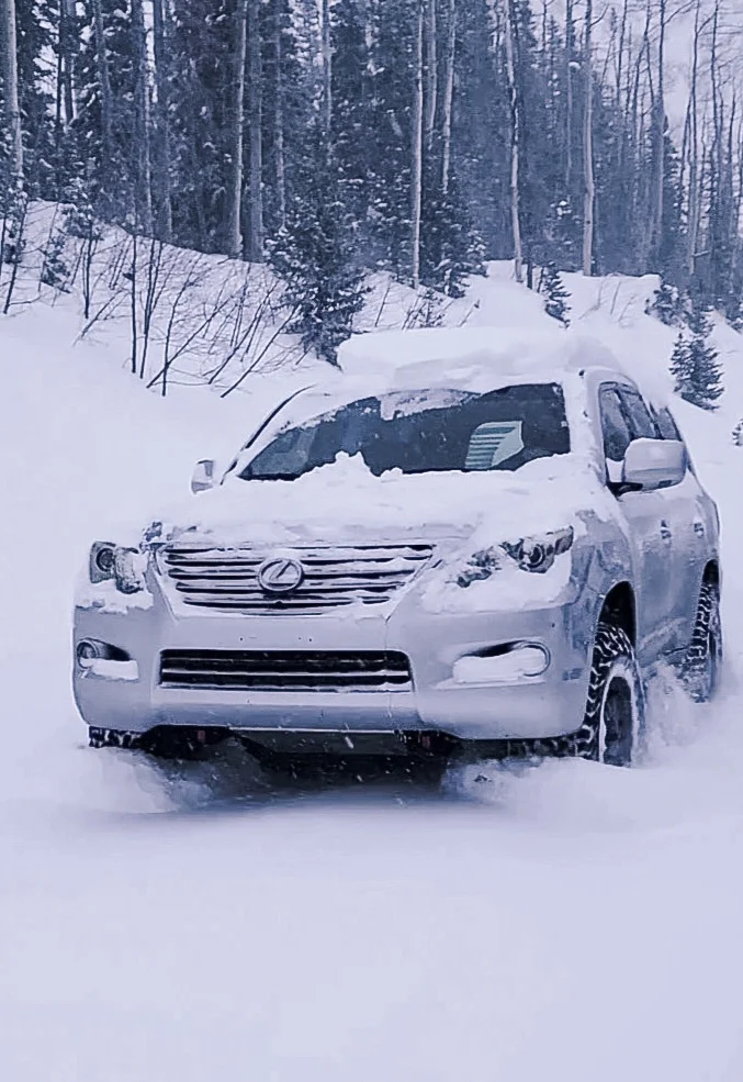

Making fresh tracks in Utah.
