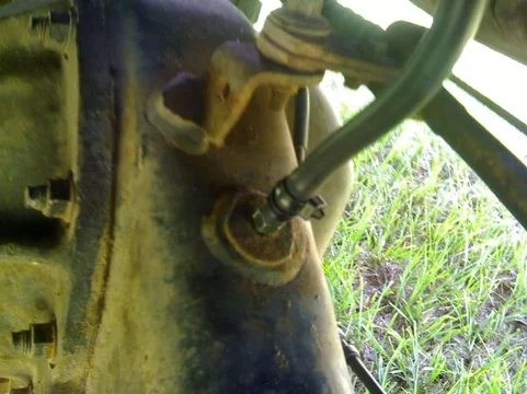

I have a rear lift and really need a longer brake line. I can get away with the stock one if I don't get wild. I've priced the aftermarket ones and just didn't want to fool with it or shell out $40 for something that isn't broke. Well, I got to thinking today, since I'm running some other 'custom' projects around my head...
(all part's brands were picked for their measurements and autozone lists the sizes and/or fittings of most things when no one else does)
ToyTec is 20", Tundra w/out ABS is 20.25", stock Taco is 15.5".
$40 here
http://www.toyteclifts.com/index.ph...ategory_id=63&option=com_virtuemart&Itemid=72
$21 here for the Tundra one
http://www.autozone.com/autozone/pa...fjc1Z8knpa?itemIdentifier=689924_168069_3559_
The stocker for reference
http://www.autozone.com/autozone/pa...dcjxZ8knpa?itemIdentifier=689829_168069_3559_
The eyes on the T-100s have a smaller rubber, but it can be greased and reasonably forced on with the bolt that holds the shock on. The Tacomas are actually side specific and the T-100s are not. Doesn't really matter that much. But a T-100 would be more than a 2" rear lift puts up.
The stock rear shocks are: compressed-13.52", extended-21.79", 8.27" stroke
http://www.autozone.com/autozone/pa..._/N-jdcjxZ8oxxx?itemIdentifier=412124_0_7413_
The T-100s are: compressed-14.88", extended-24.9", 10.02" stroke
http://www.autozone.com/autozone/pa..._/N-j9ifpZ8oxxx?itemIdentifier=310511_0_7413_
