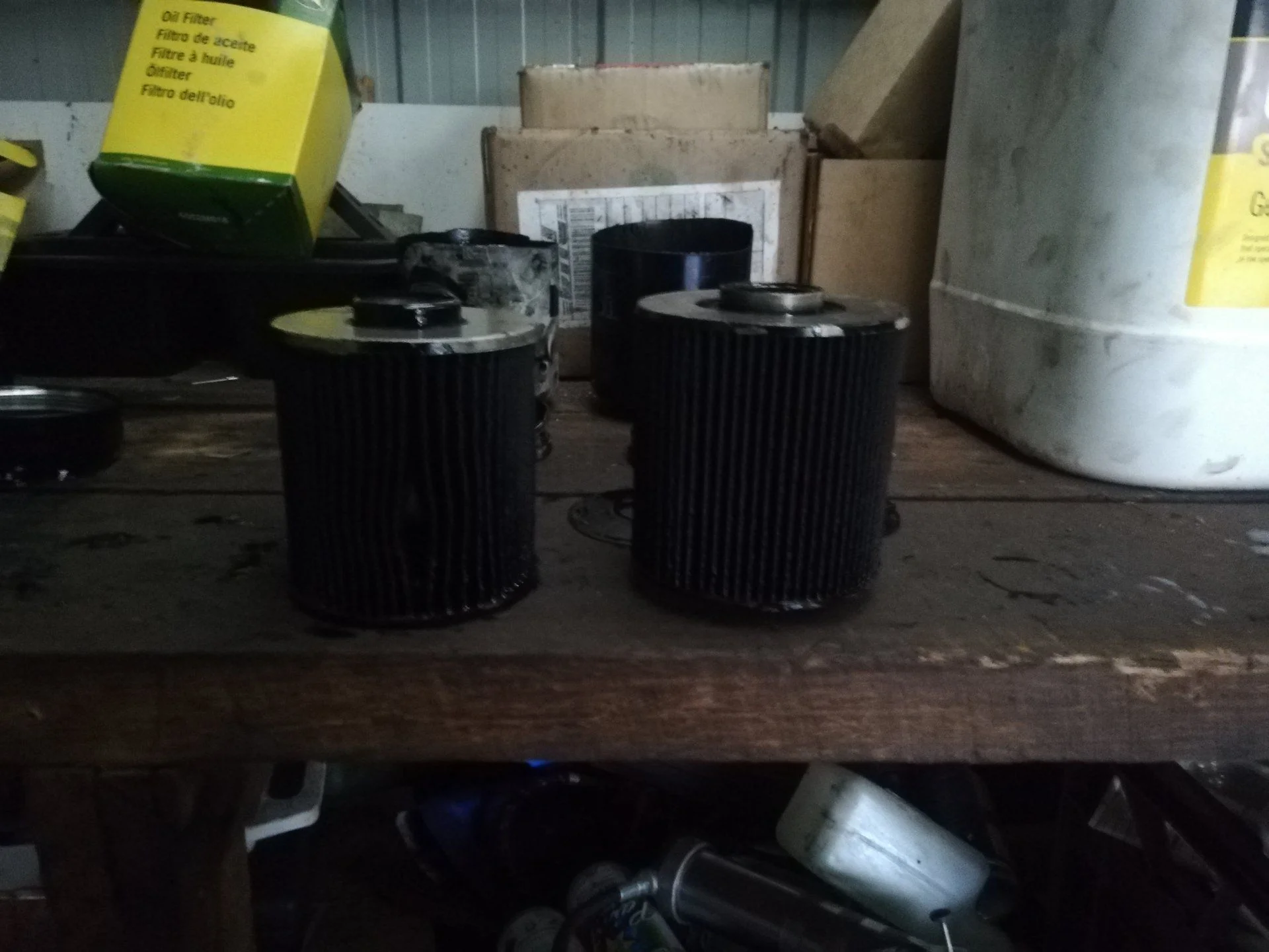

I've got a few myself off of my HJ60 that I will share to start with. First up is the fuel filter. Even with good brands they still sometimes let you down. Ryco on the right, genuine on the left. Genuine is so much bigger and has alot more paper in it. The spring in the housing would have struggeld to puch the filter element up to seal with the face of the housing. The sealing washers that came with the ryco also weren't up to scratch as they were all flat faced orings, where the origional uses a half curved on to seal the bottom of the bowl properly.

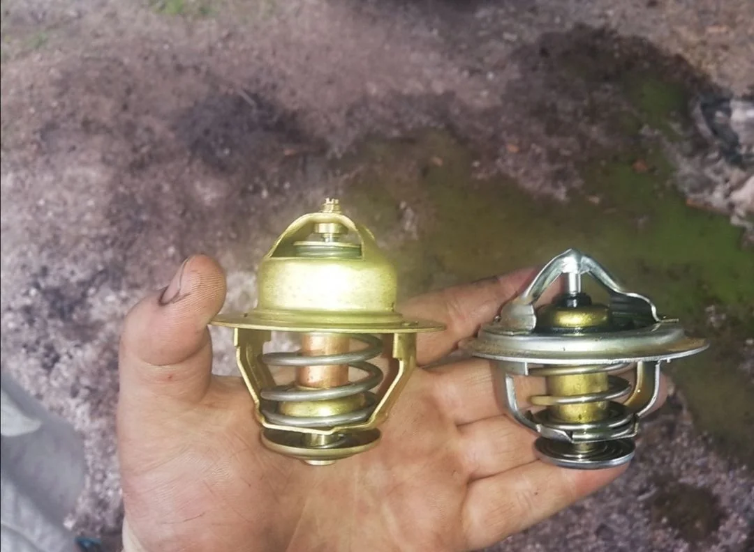

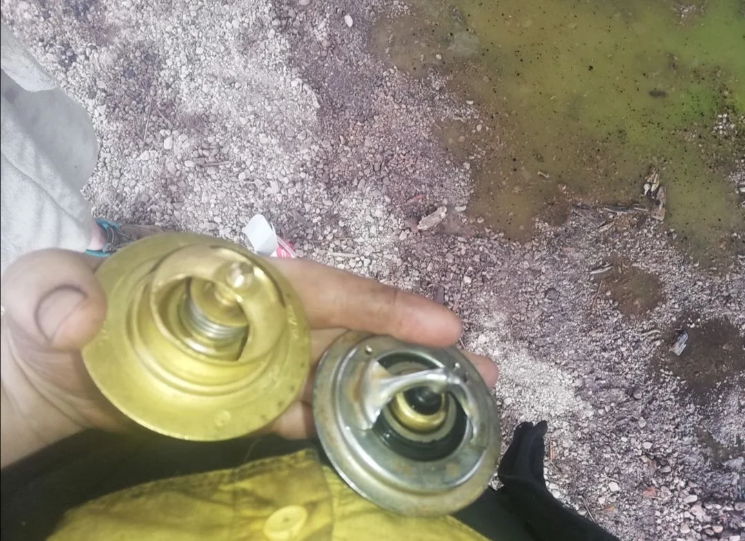

Changed the thermostat a while back. Thermostats are definitely one of those parts where they can pass it off as fitting many different models easily. As you can see they are quite Different with OEM on the left. Old one didn't seal in the housing properly, new one is a nice snug fit. Obviously quite different materials. The OEM weights about 4 times a much as the old one

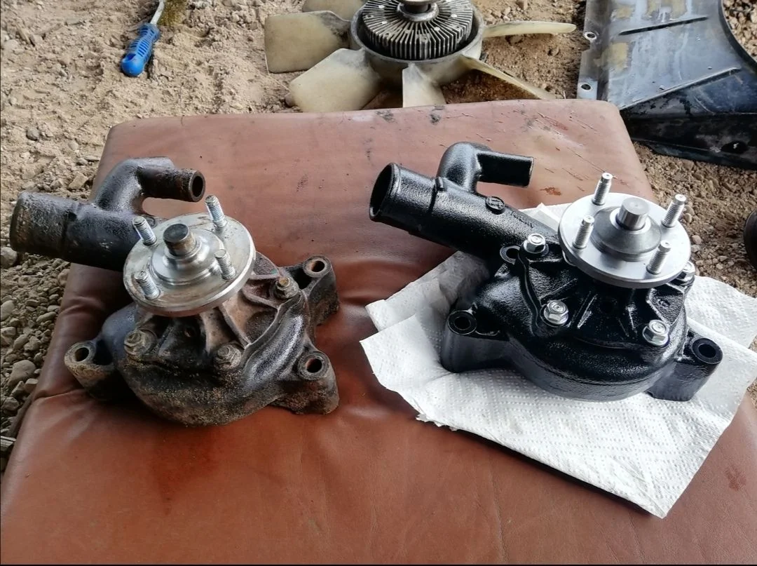

HJ60 water pump and housing . This non genuine didn't even last a year before the bearings gave up and it was leaking past all the seal. The origional is cast iron which matches the block. The non OEM was alloy so I don't know how they expect it to keep up with the expansion rate of a cast block? And obviously the bearings weren't much chop either. The new OEM pump is beautiful.

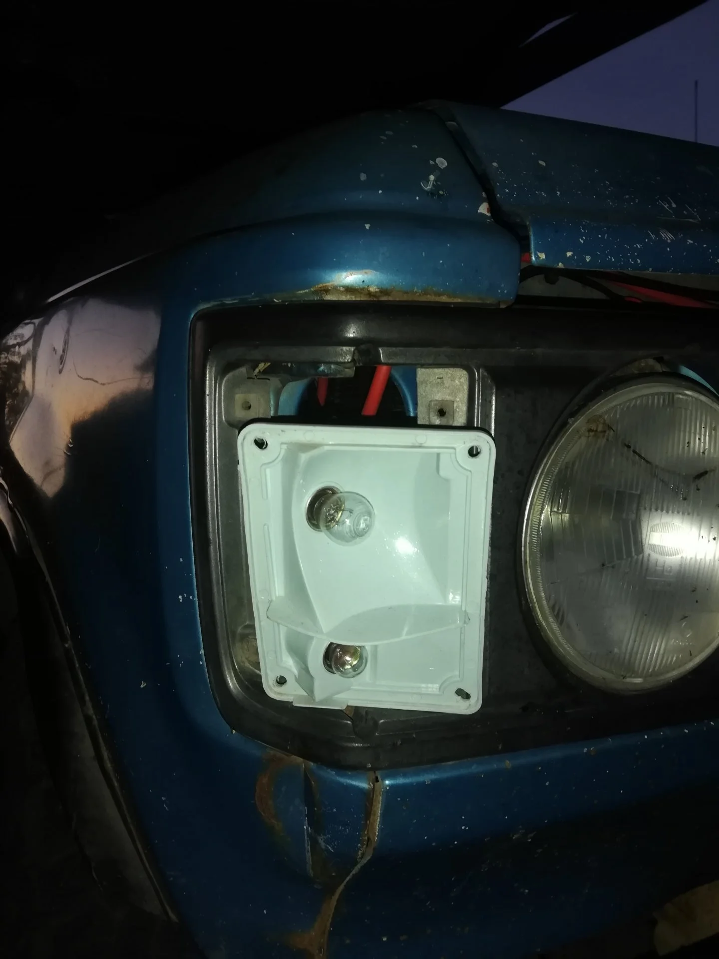

Another one, except I got suckered into buying non genuine parts, side indicators and park lights were to cheap to pass up. But the holes didn't line up with the car, I had to drill them out. And when I got them on all the lights started doing funny things when I tried to use them, so I took the covers off and found that they had been supplied with the completely wrong globes! So I put the correct globes in and now they work fine.
