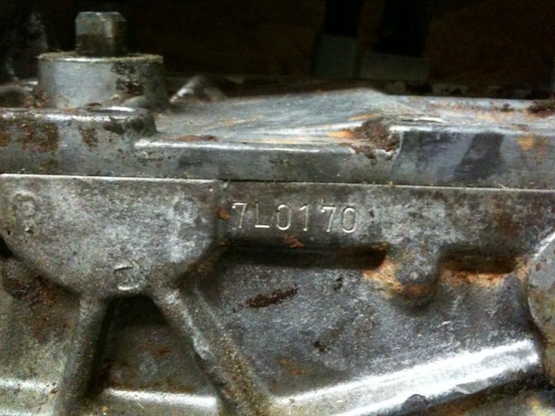

First picture is of my old original case (11/77 production?)

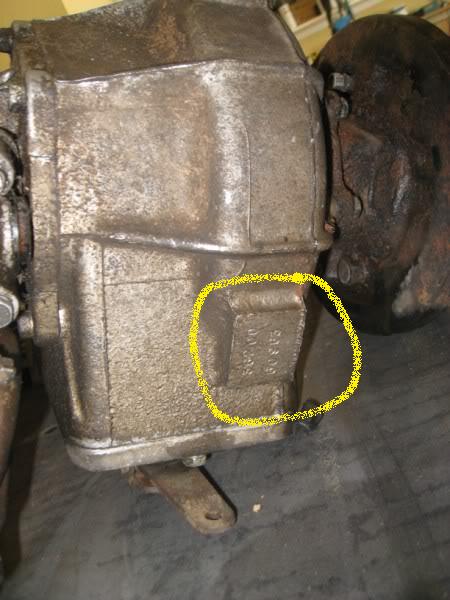

Second picture is of my new rebuilt case in the same spot.

so the date code is where I have indicated correct? What are the numbers on Joe's top TC???? Never seen those B4.
Though the date code pad is still there on all one-piece cases, they stopped whacking the numbers on the pad and moved them to the rear surface of the case at the end of 1976. Why dey do dat? dunno.:meh:
So your pic is correct for E-76 and ColReb's '77 case is also period correct.
The pictured 1977 code is 7=1977, L=12th letter=December, 0170= 170th case produced in December 1977
